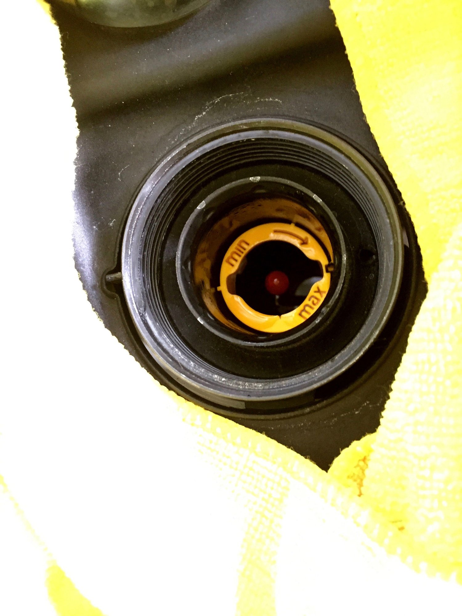

Question Reading coolant level - Red Ball
Picture on pg. 99 Manual shows “Min @ ~ 2PM… if a clock face… & “Max” @ ~ 8PM. An arrow on edge going from Min to Max. There is a notch for the red ball just b4 the word “Min” & just after the word “Max.” So on the ‘clock’ the notches are @~ 1PM & 7PM
So, If the red ball is in the “Max” notch you are 100% full & if in the “Min” notch you need to add coolant & probably had a MFD warning message.
I was unable to find any videos or photo online or here showing an actual photo, especially with the level between Max & Min.
If you are ½ way between Max & Min, Is the red ball supposed to be pointing straight up in the center of the clock face?
That is where mine is.
Or should the red ball be pointing somewhere along the side, where the arrow is?
Here's what the bobber looks like when it's in the middle. And everything Porsche_nuts says is spot-on. If topping off, just used distilled water. We have over 6 gallons in our systems.

My red bobber does not ride the periphery of the circle. If in between min and max, it will be in the middle of the circle. Like where the axis of rotation is for the clock hands.
If you are at min then add 50/50 mix if you have it. If not add distilled water.

Thanks! It is as I thought but, I really appreciate the confirmation.

OP, look directly down into the hole (with flashlight?), if you see liquid you're okay.
