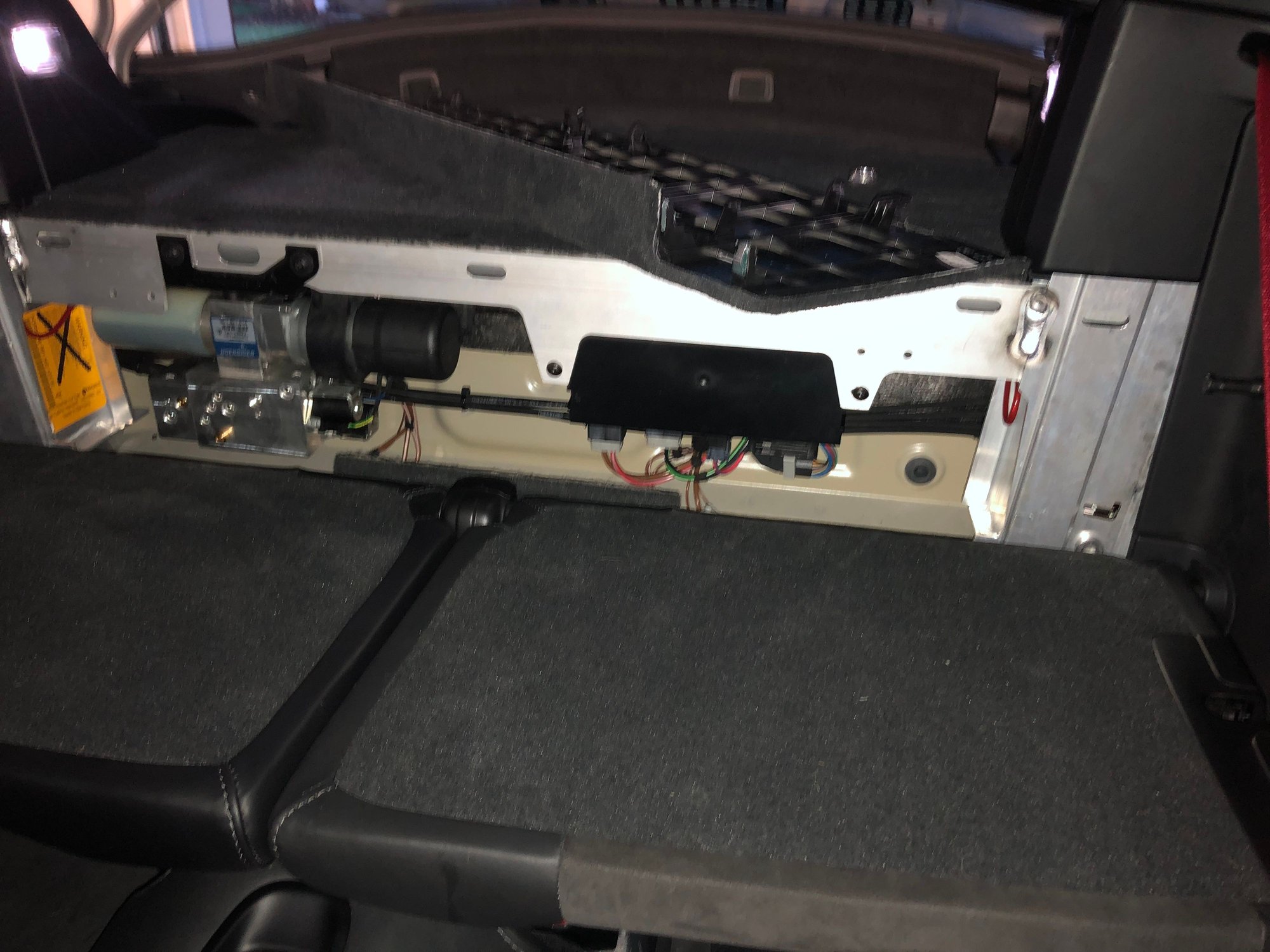

I didnt know what that was when I saw it in my car. However, just pull the cover off behind rear seats in Targa. Then, reach your hand over the aluminum brace (that houses Targa mechanisms) and the carpet. It will be right there.

So under this carpet?

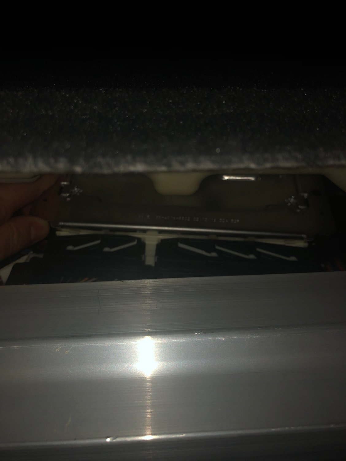

Looks like the piece he pulled out in the video to me and in the same exact place as the coupe. You just have to reach over the bar that is in targa where is nothing in coupe

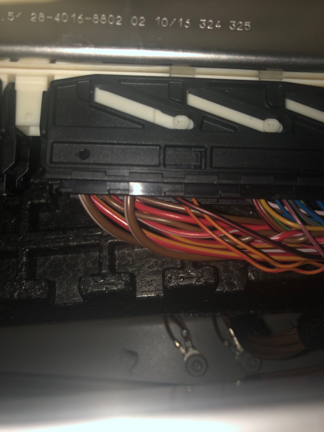

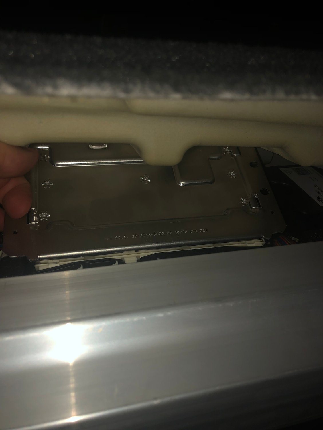

I just held it in my hands and took pictures of it for you. I didnt disassemble anything. I have spent time back there measuring and inspecting things to make a harness bar. It is all easy to access. If one wanted they can pull carpet all the way up back there. However, as you can see in one of the pics I posted I flipped the controller over with one hand holding a phone to take a pic. That took maybe 30 seconds to get the controller in my hand.

Yes, right in the center, roughly 8” back. Yours may look a little different when you pop the cover off as I pulled the insulation pieces out from under aluminum frame. That is irrelevant for this particular thing though as controller is not in that area with insulation. Also, side note, that aluminum frame is mounted to the rear seat studs (behind interior pieces) that lock the seats in, bolted through the wheel well, bolted behind the seats on the bottom, and has arms bolted toward the middle of the engine compartment. It is extremely heavy duty and must be part of the rollover protection for rear seat occupants. I imagine the time to remove that piece is in the hours range. Just side info...
