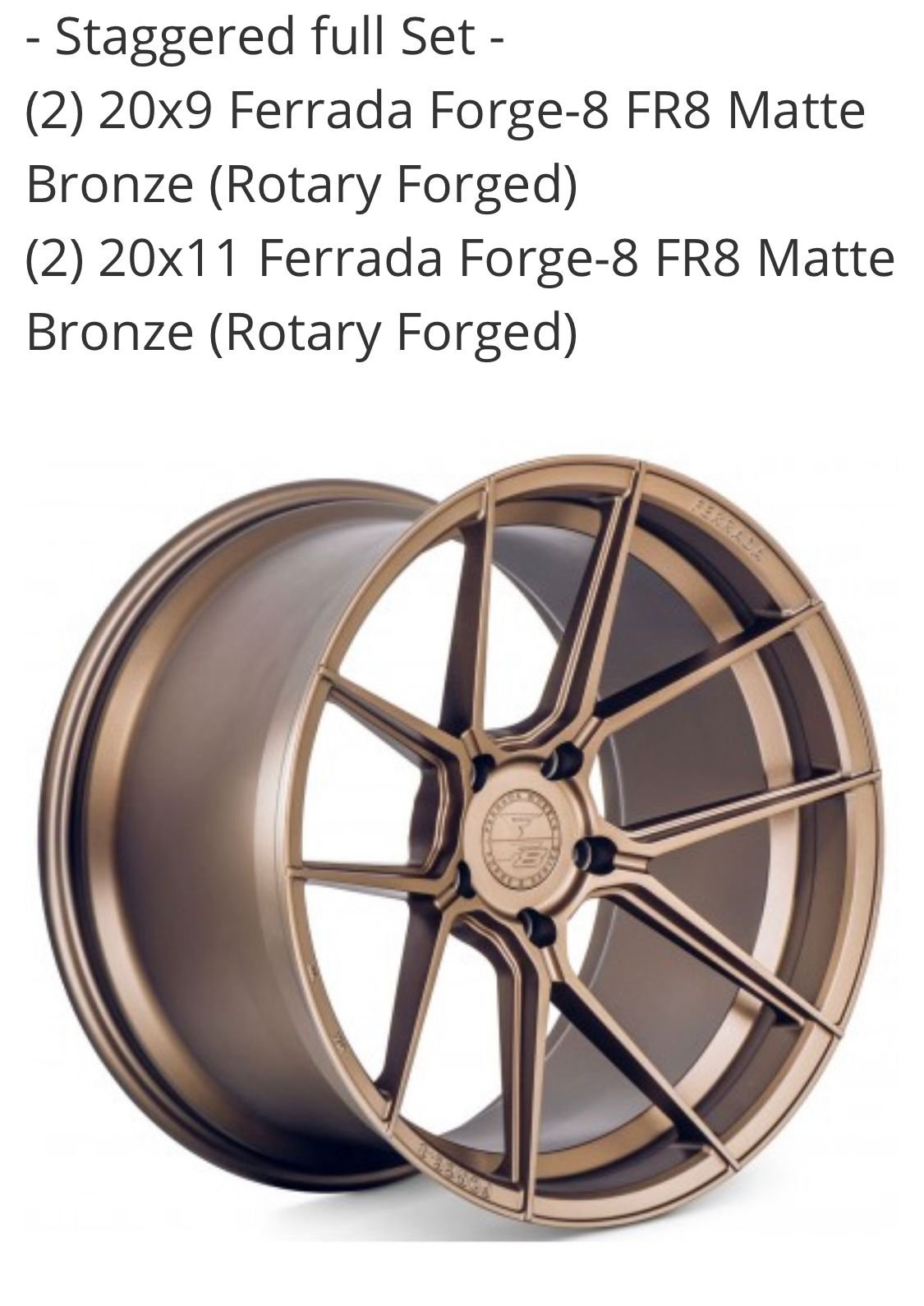

2. The aftermarket wheels I found is Ferrada forged F8-FR8 matte bronze. Here are the specs.
Staggered full Set -
(2) 20x9 Ferrada Forge-8 FR8 Matte Bronze (Rotary Forged)
(2) 20x11 Ferrada Forge-8 FR8 Matte Bronze (Rotary Forged)
- in this case, first can I put these wheels? The seller says it fits into 991. Can I put front 9, rear 11 ?

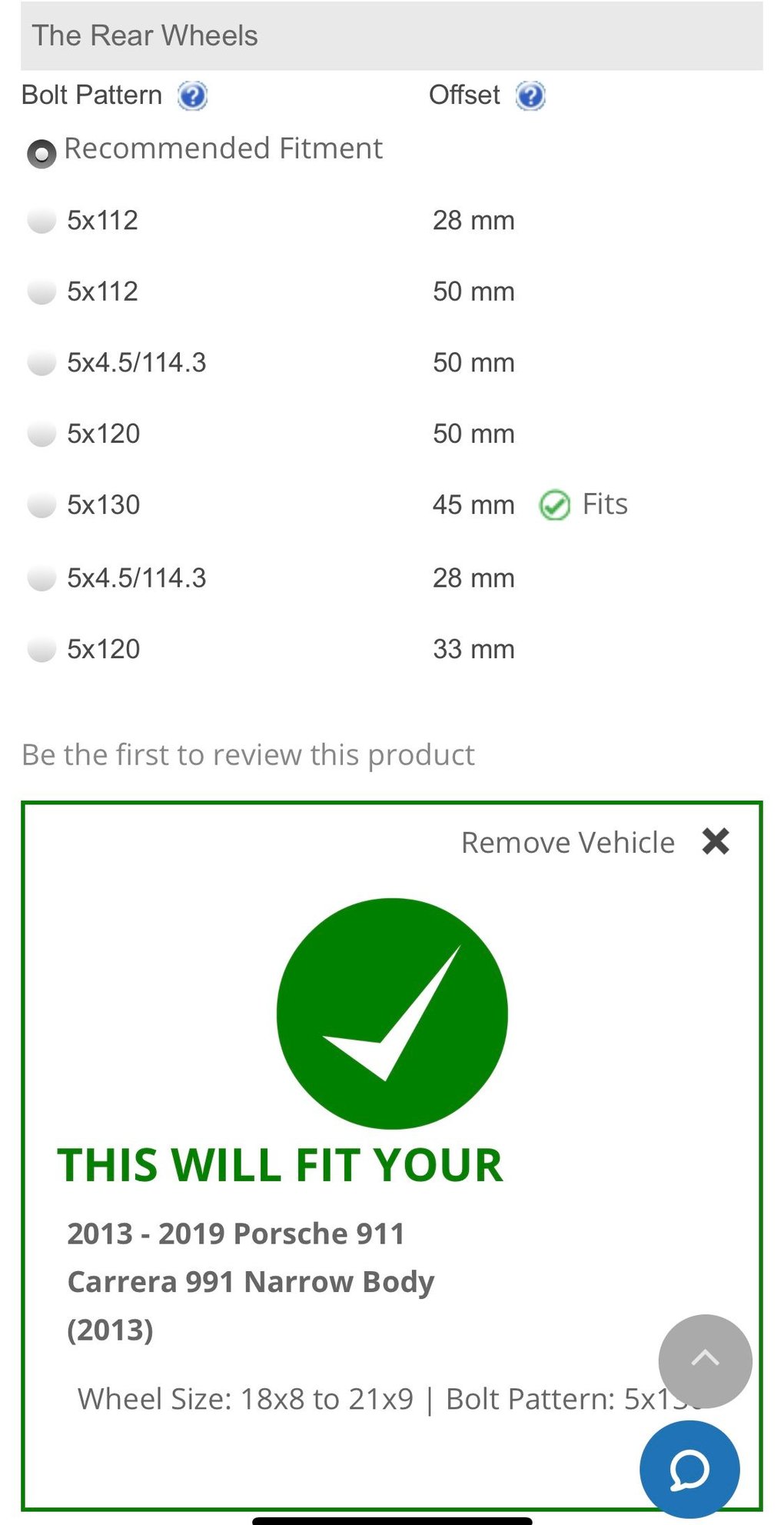

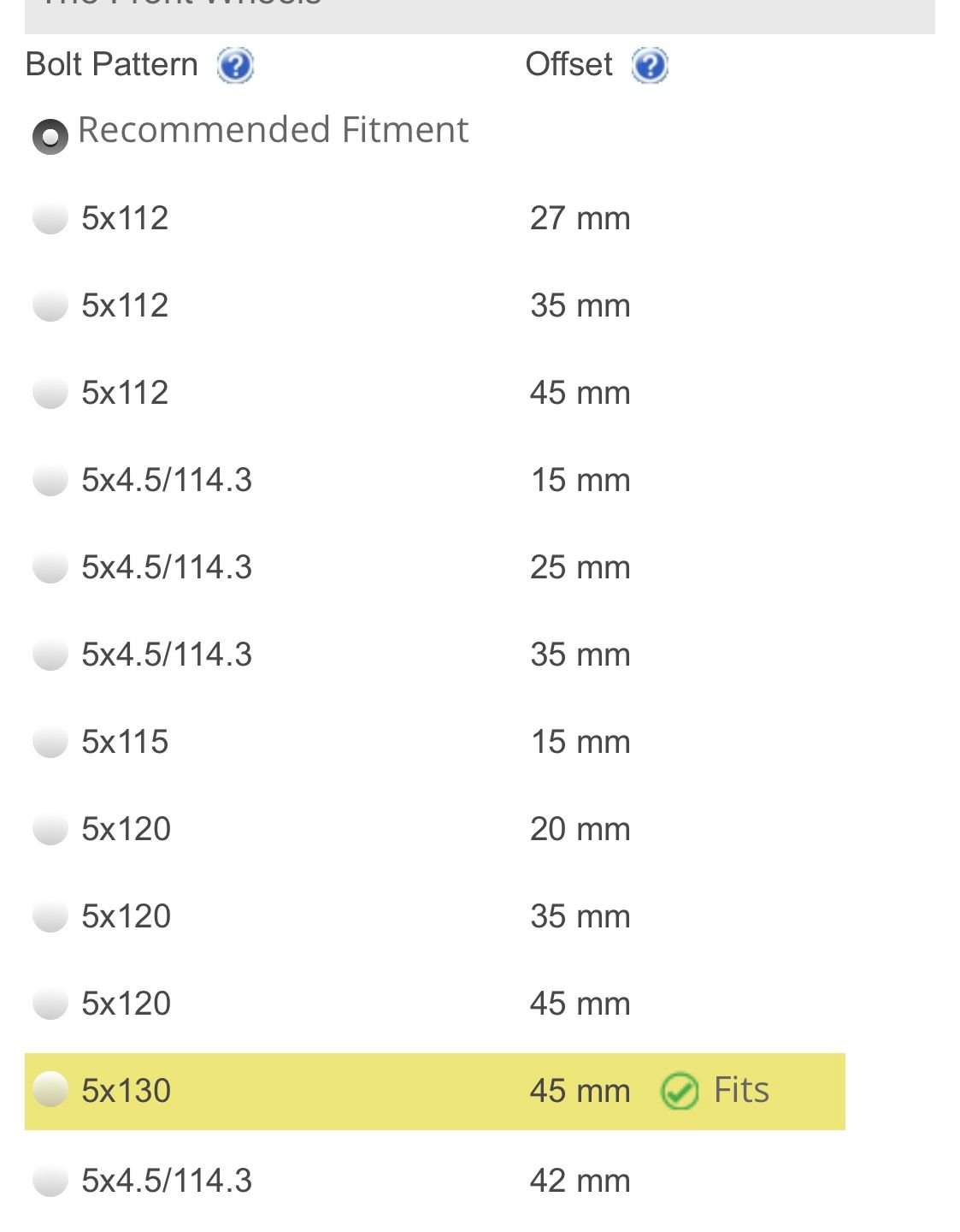

Offsets are both 45mm front/rear, they say it fits on my 2013 carrera 2 base model narrow body.
just want confirmation from the experts

If I'm understanding this you have a 51 offset on the front and a 70 offset on the rear. They want you to put wheels with a 45 offset on both front and rear. Sorry that will not look right at all. It might be ok for an S4, but not for your base Carrera. Time to look elsewhere.

+45 rear will not work with narrow body, it will sit past the fenders
