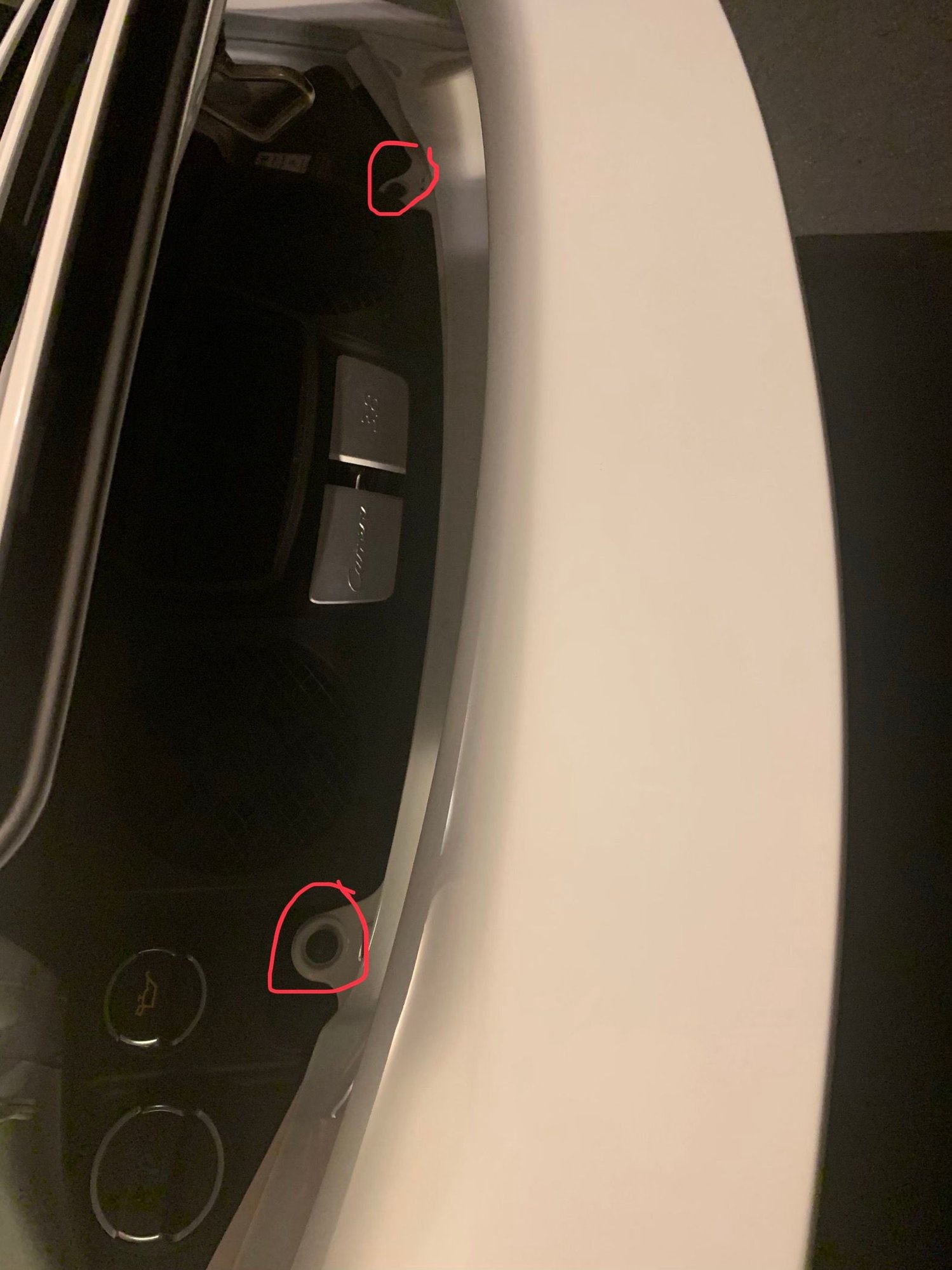

I went into the garage real quick to take a pic. When you pop the engine cover, you will see the circled screws. Unscrew it, then push/slide the wing unit away from you, towards the back window. Then, you can lift it up from the front. But the middle light cable is plugged in. You can unplug it or leave it. I had enough clearance to accces my lights.
Thank you for your DIY with photo. I appreciate it. I’m glad to hear I don’t have to remove the whole ducktail.
When you say push toward the rear window , do you mean the ducktail panel will move foward like if it was on rail or do I have to lift the back of it like if we were to open the trunk of a car?

Not a problem! Yes, push it like it’s on rails, because it is on a couple of guides. Once you push it forward, it’ll feel like a puzzle fell apart, you’ll know when you can lift it up.
