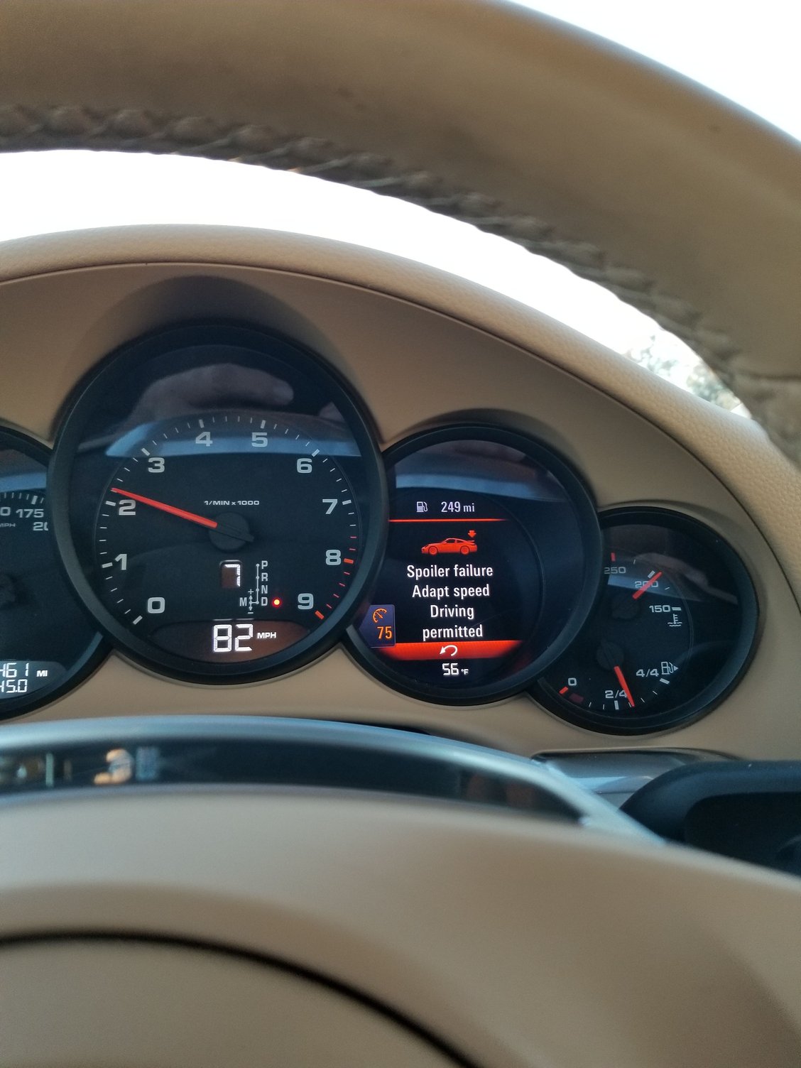

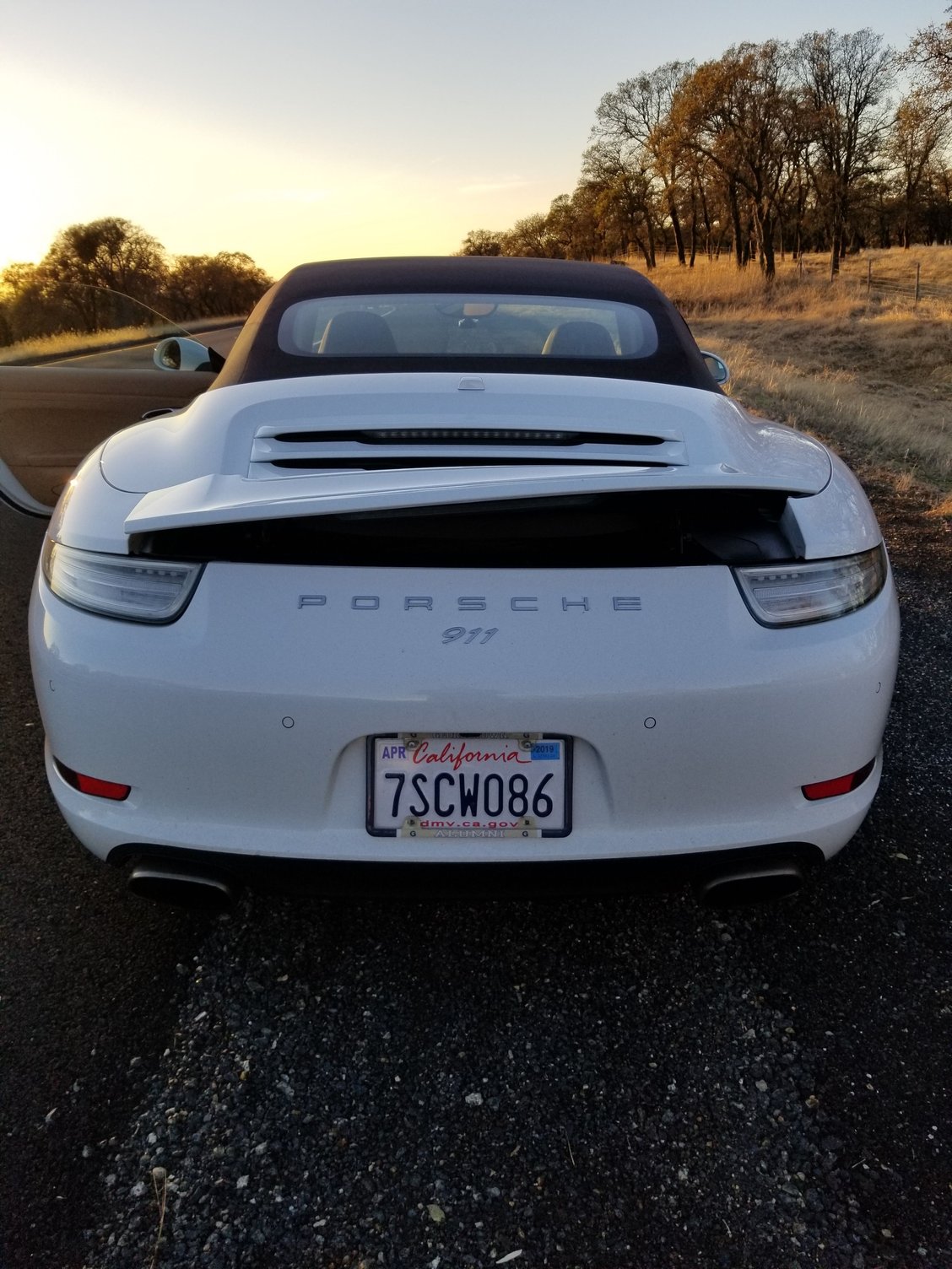

Driving home from work the other day I got this error message. I pulled over to see what had happened. I can't get the spoiler to go up or down now, its just stuck there. I have an appointment with Porsche of Livermore this coming Wednesday.

Holy crap - never saw anything like this before! Looks like a bolt came loose or an arm broke?

Only in a PDK car can you take a photo at 82 MPH!
Pretty smart system by Porsche to alert you of something that you can't see while driving.
Curious, does the car pull to one side, or the other, with the Kitty Wompus rear spoiler?

Note to self - rear spoiler cannot withstand speeds greater than 80 MPH.

I'm guessing it could be the spring as described in this thread:
https://rennlist.com/forums/991/9933...er-spring.html
That car was also a Cab but that could just be coincidence?
Either that or it is the new dynamic spoiler corner-force loading feature (PDSFL) that works with PDCC and torque-vectoring (PTV) to improve corner turn-in at high speeds.

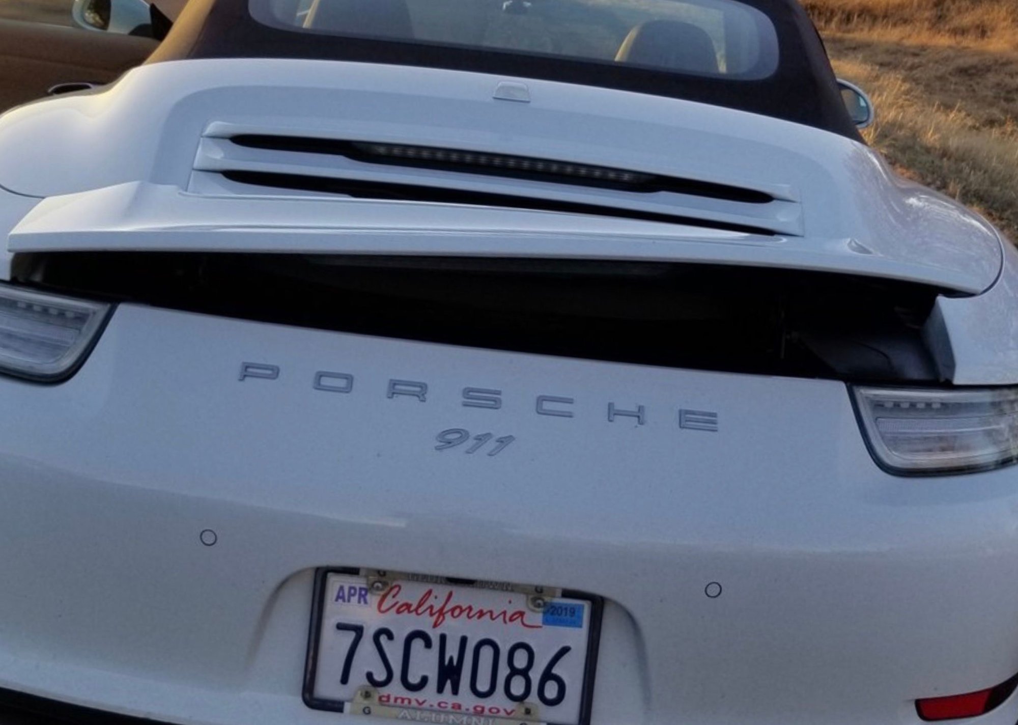

StormRune. Thanks for the link. I got a flashlight etc and found the broken spring arm. I can't see its retainer. It appears the spring arm is broken and sticking out toward the back of the car and that's what is holding the spoiler out, or preventing it from retracting all the way.
And yes, my car makes right turns much better.
