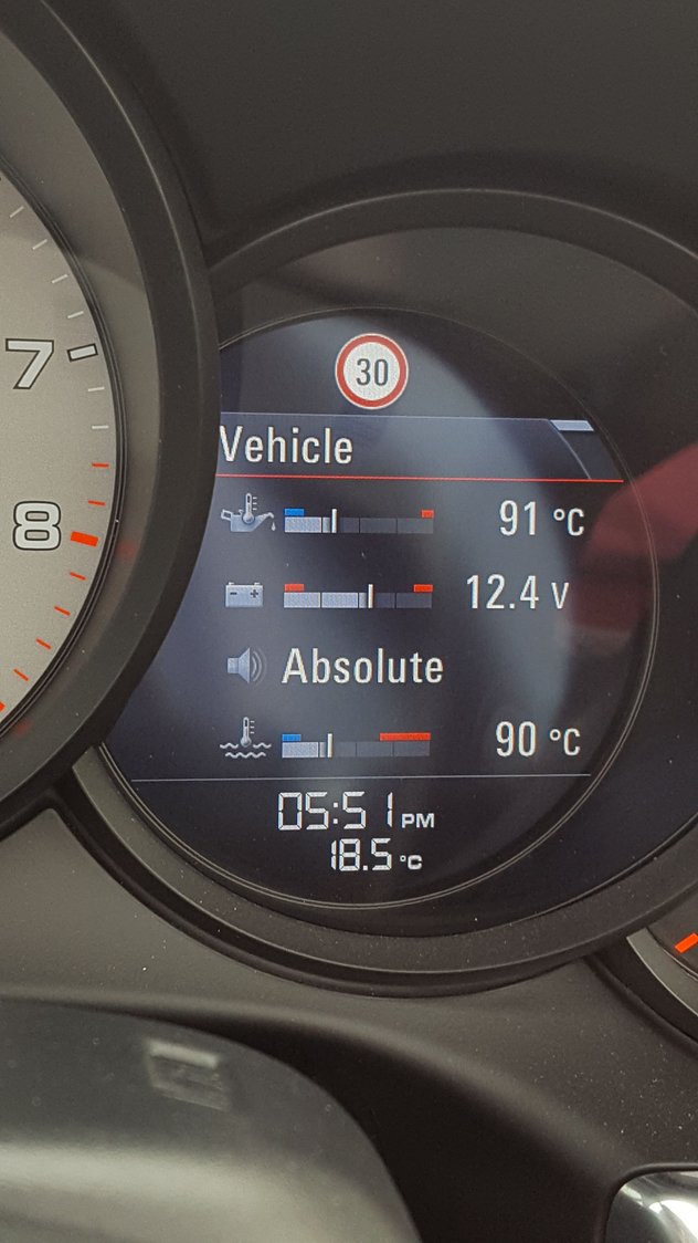

This week I was surprised to have a flat battery immediately after an hour motorway drive. Yes the battery is 4 years old (original Porsche banner battery), but I would think after an hour motorway drive I would be able to get my wallet out of the luggage compartment after I parked the car. But the battery so flat.
I usually drive in Sport mode, however, on this particular journey I had the Mrs with me and was just having a relaxed drive on Normal driving mode. It was during the day, no headlights, no heated seats.
Porsche assistance found the battery has 11.7V. They did a jump start then on testing the battery on idle the battery was not taking charge but after the technician turned the light on the battery started to be charging. I guess this is something to deal with "smart alternator charging".
After arriving home I connected my MXS- 5 cteck on Recond mode till battery was fully charged.

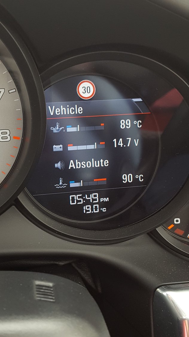

Today, I had the car for a drive and noticed the vehicle volt on the dashboard as seen in the attached pics. When driving on Sport mode, the car voltage is usually between 14.6 to 14.8V. As soon as I cancel the Sport mode and drive in Normal mode the voltage drops to around 12.4V. This kept happening every-time I switched between sport and normal. It was independent of A) electrical load: ie turning on main head-beam, air condition, and seat heater didn't affect the car voltage. B) Engine Rev: changing the RPM didn't have a noticeable effect on the car voltage.
So, am I getting this right: in normal driving mode the dynamo is hardly charging the battery?!?!? is this normal or I have a problem with the dynamo? Can someone please check if their vehicle volts behaves similar to mine. (991.1 C4S, 2014)

Sport will boost the voltage up to the mid- to high 14’s.
But your battery is toast. Get a new one. Noticed a big difference when I did on my ‘13.
