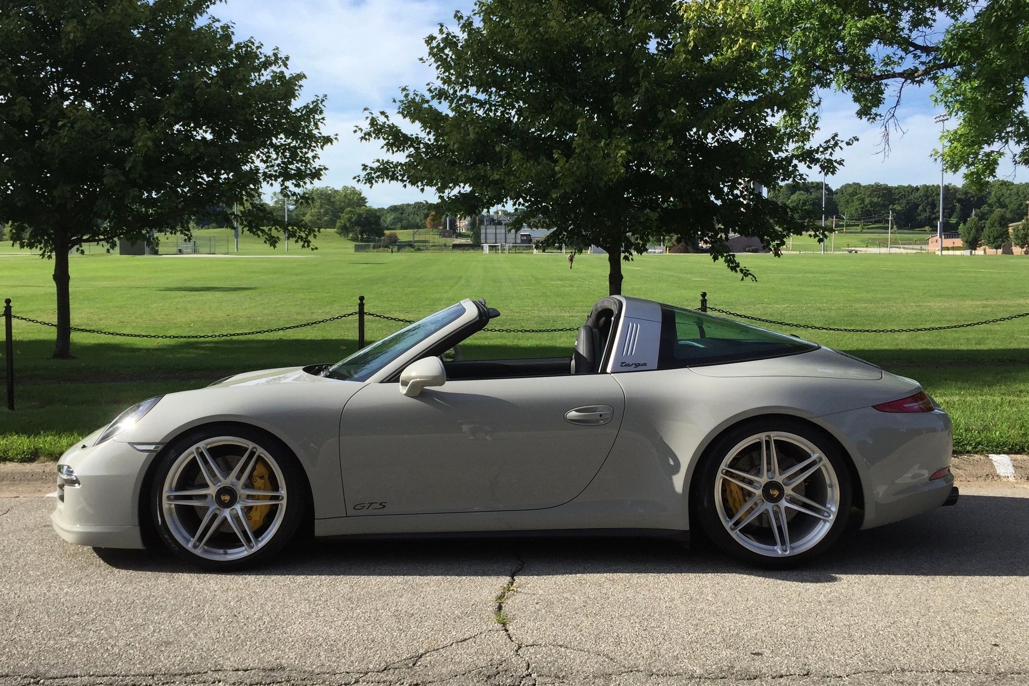

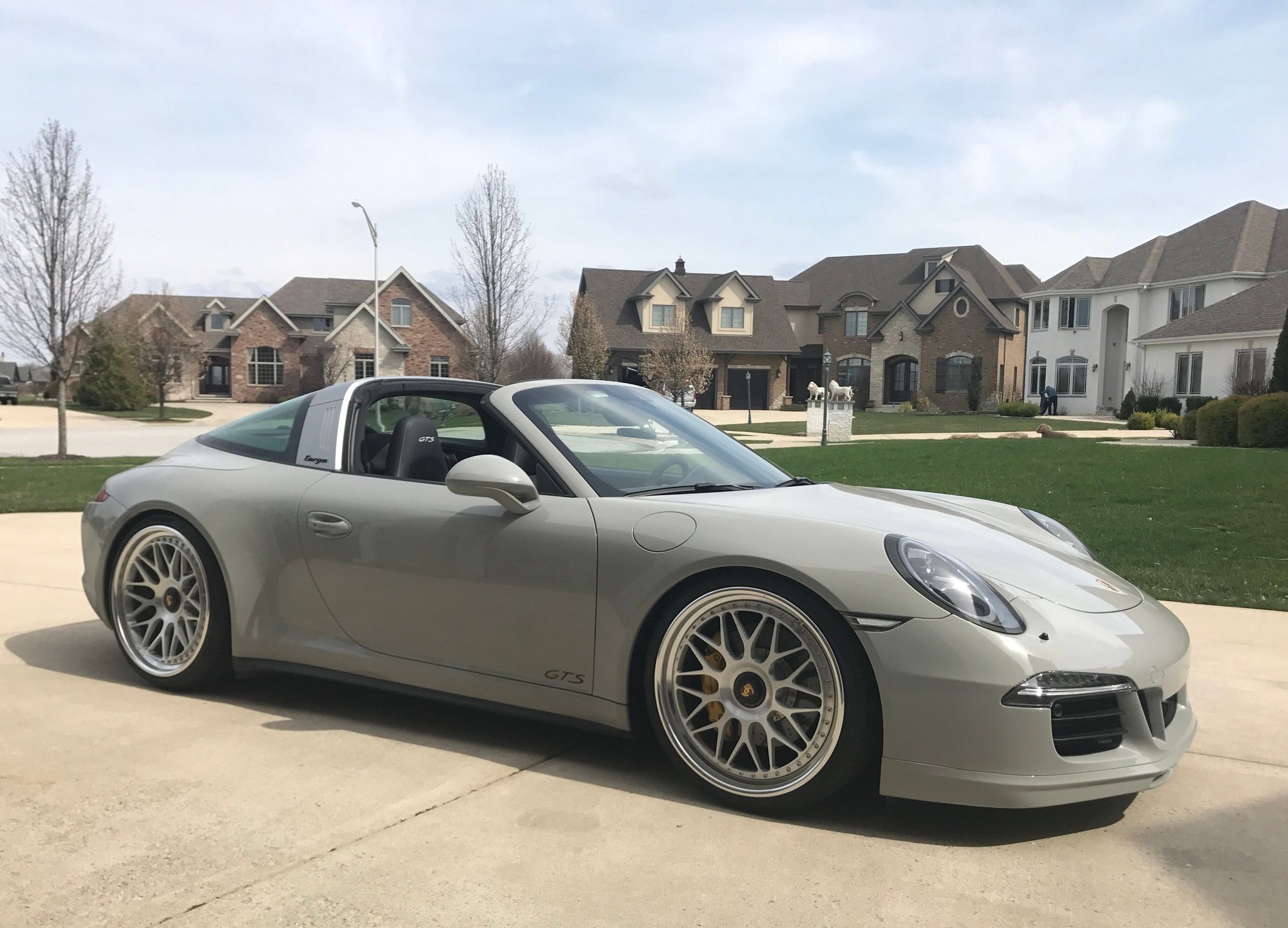

Wow, that is amazing compared to oem 20”. Which model HRE is that? Thanks!
Here are my thoughts on 20” v 21”. I’ve had both on my 991. Both ride similarly but I’d be hesitant to have 21” for daily duty given less rubber to absorb impact. Both look better with the car slightly lowered, especially 21”. If u r not going to lower, then go 20” without a doubt. 21” wheels in one piece wheels look too big imho, unless you slam the car. Only get 21” wheels in 3 piece configuration, since they look smaller visually. Here are a couple pics of the wheels I’ve had on my car. First pic, 20” HRE p106 and second, 21” HRE classic 300.
If your goal is to increase caliper clearance, 21” wheels will addresss that, i don’t think 20” will be any different from the stock wheels. U may want to reach out to one of the wheel vendors and ask, I can connect you with Tag Motorsports. They’ve always been very knowledgeable and helpful to me.
Keep us posted on what u decide. I have an’18 gts in order, will have to deal with this issue as well unfortunately.
Best,
Tom
Reply 0

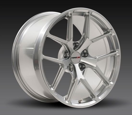

These are new and very similar. Slightly more affordable too.
http://www.forgeline.com/products/on...block/vx1.html
http://www.forgeline.com/product_ima...image-1157.jpg
Reply 0
Dec 18, 2017 | 12:54 AM
  #44
Quote: These are new and very similar. Slightly more affordable too.
Thanks! I saw those on the Forgeline website and they are really sharp too. If I change wheels it will boil down to which one gives the most clearance. Forgeline has a wide range of offsets compared to HRE, although don’t know if that is the case with their centerlocks.
Reply 0
Dec 18, 2017 | 01:02 AM
  #45
A variant, the VX1R, although I like the P101 better (but not by much):
