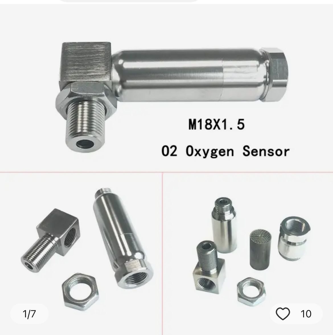

I guess the smallest insert makes the most sense but I hear that these still occasionally throw CELs. Would it help to lengthen these Vibrant ones with something like this? Adding it to the end so that it is longer overall?
3NH® 2X(Straight Adjustable o2 Spacer Oxygen Sensor Extension M18x1.5 CEL  Fix E6I7) : Amazon.in: Industrial & Scientific
