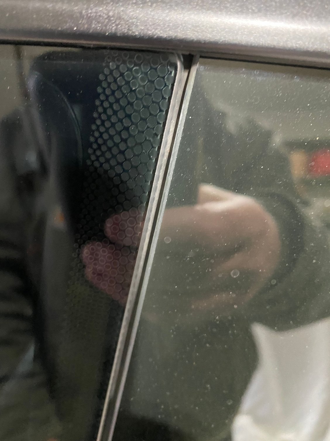

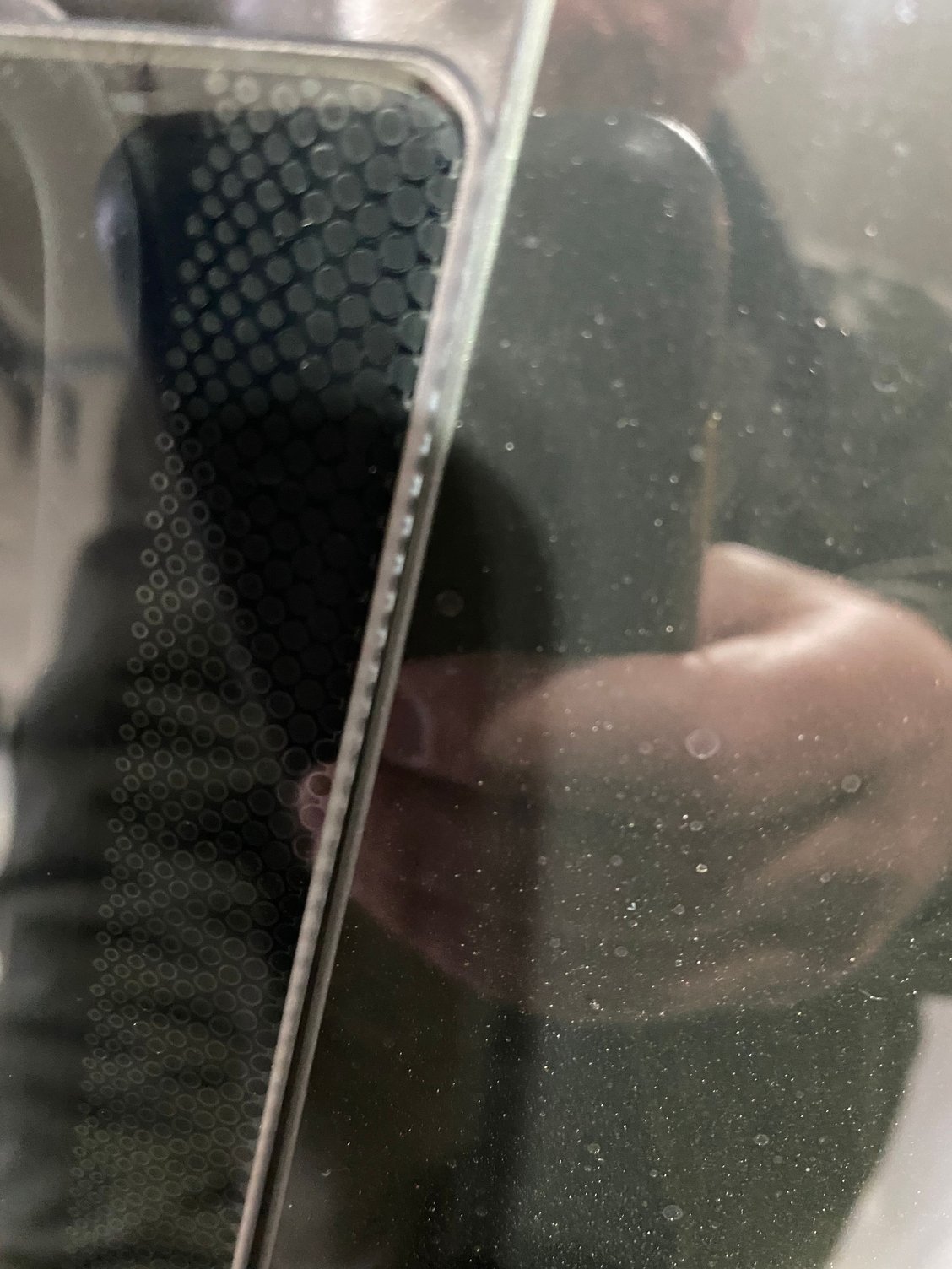

Hi everyone not sure if I posted this in the correct place but drivers glass has started catching on the rear glass when opening the door has anyone come across this and how do I fix it
thanks in advance mike

The window recognizes top and bottom ok but when the door handle is actuated and the window moves down 1/8 inch that’s when the two pieces of glass touch each other

Is the rear quarter panel glass in alignment? A while back, there was a thread about the rear quarter panel glass being loose.

Thanks that looks like the issue 👍
