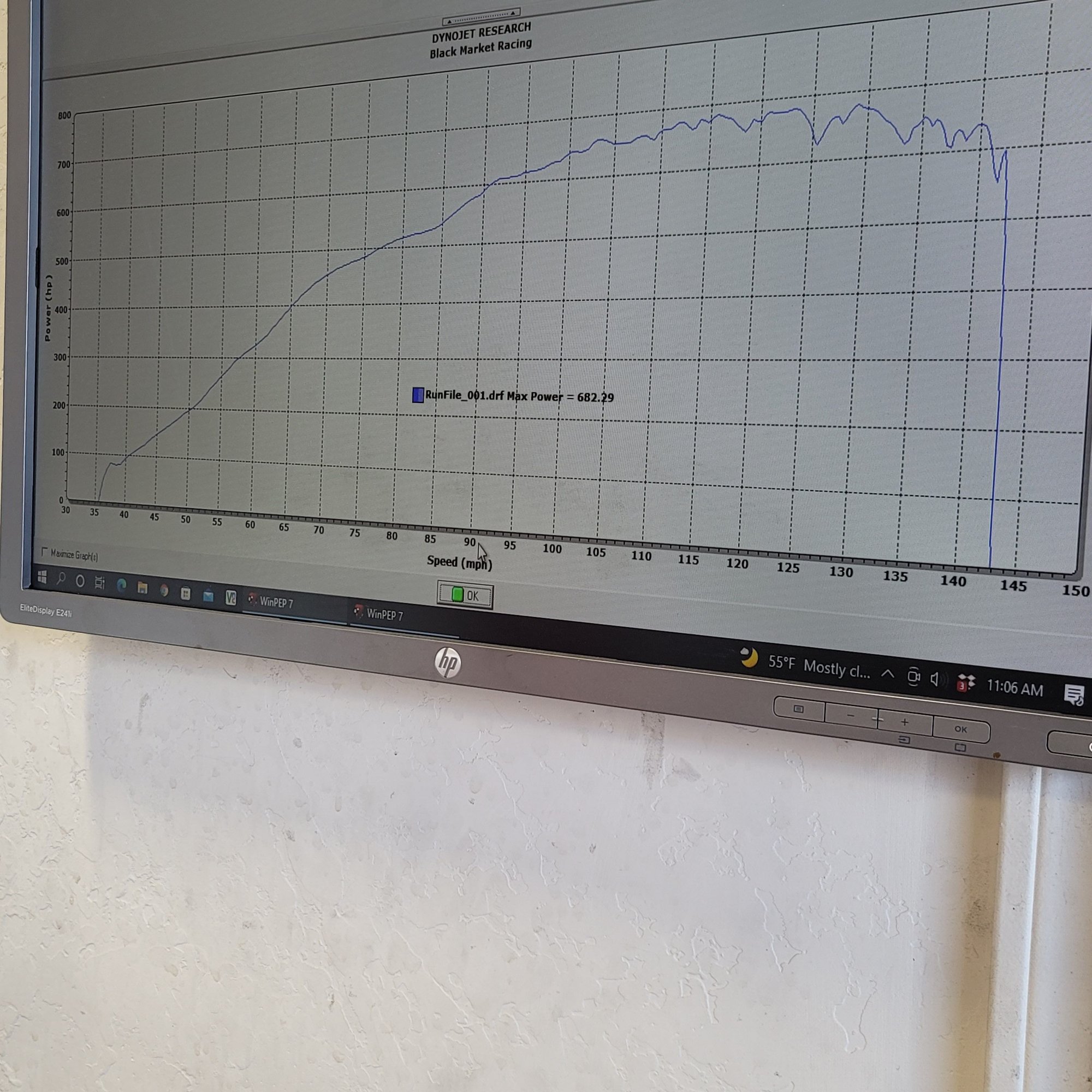

So.. On my 93/94ish octane tune it put down 682whp. Gonna call that one a glory run because it was early on and the first pull of the day, IAT's were in the 40's
On E85 ( had to dilute the E98 with 91), it made anywhere from 619-670whp. We toned it down and kept it on the 619whp map as that one fully functioned, IAT's were in the 100's for that pull and the other E85 pulls.. The stock high pressure fuel pump takes a dump on all the maps above the 619whp. E85 is just too much. However, we discussed trying E54 and/or E40 maps. The tuner is confident that on E54 or E40 the car can easily put down 700whp. So all in all, the current 619whp map could be in fact making much more power with lower temps since it was heat soaking on the dyno.
On the tries where the car did 650-670whp on E85, the car was on the path of making a boat load of power.. 730whp+, but again the high pressure fuel pump maxed out. Very impressive for just bolt ons. There is a ton of room right now on the top end on stock turbo.
I now have an E85 map and E54 map on my Cobb Accessport which is cool. We will continue the journey via remote tuning on the E54 fuel. At the moment I think I am the first and only person out there with Ethanol Maps for a 991.2 TTS via Cobb AP.
The car is running super smooth on the V1 E85 map. Much smoother and linear than my pump gas 93/94 tune which was just a spinning torque monster ( a little rough and inconsistent too). The motor was being pushed.
Once I'm done having fun with this E85 map and I get on empty, I'll be dialing it lower Ethanol maps. Overall an awesome experience. The positives are that Ethanol is just much more safer, burns cooler, and cleans the motor. Big plus!

Excellent test. Thanks for posting ! Confirms the pumping system is not up to the task at all.
Will be interesting to see if you can consistently better the pump 93 tune with E40. Tight balance between enough fuel to make +680 on E10 vs E40 and still not max out the pump.

The 682whp number on 93/94 (with pure 100 in the tank) is a very strong number.
