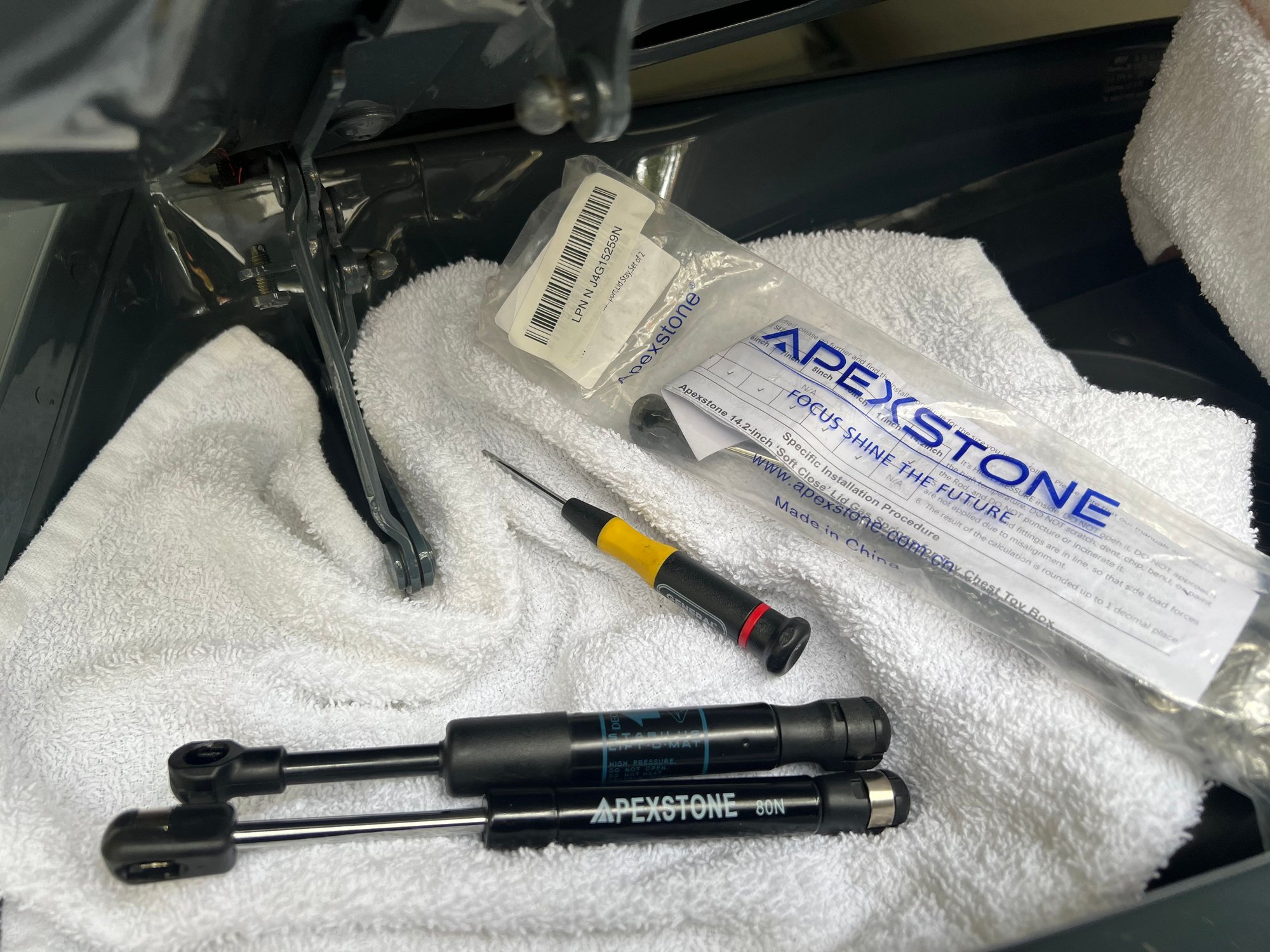

Decided to buy the 7" Apexstone rear struts on Amazon for $12.99 for the set and installed on my rear engine lid......Dealer lists OEM struts for $178.....they can be found MUCH less expensive with a web search.....but still more than these..

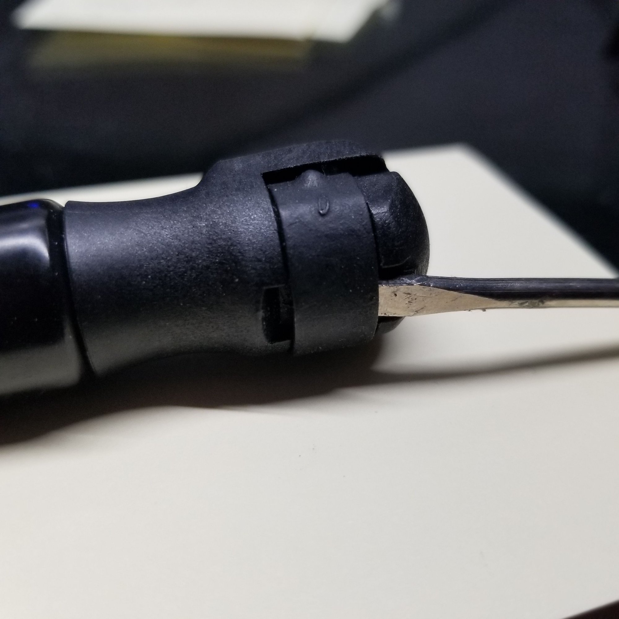

These replacements are a tiny bit longer, but to install push down to achieve proper length, as you open the top clip with a small flat edge screwdriver and then push over the ball connector the same time.

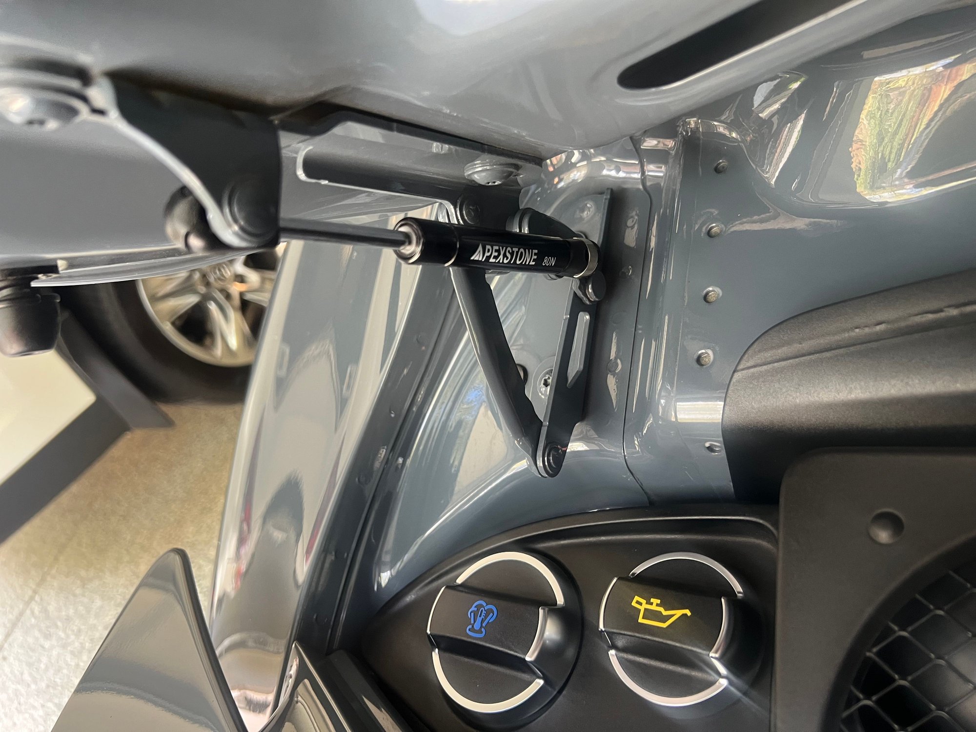

Comparison strut length.....Apexstone 7
Comparison strut length.....Apexstone 7" strut versus OEM.....36 pound total support with new struts.
Porsche Stabilus rear engine lid strut.

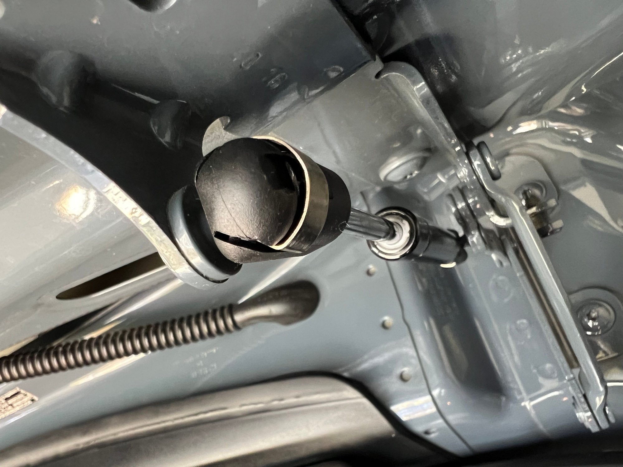

Installed in a few seconds......
Left clip a bit open to show where small flat screwdriver is inserted for easier installation and snapped it shut with finger pressure.....
