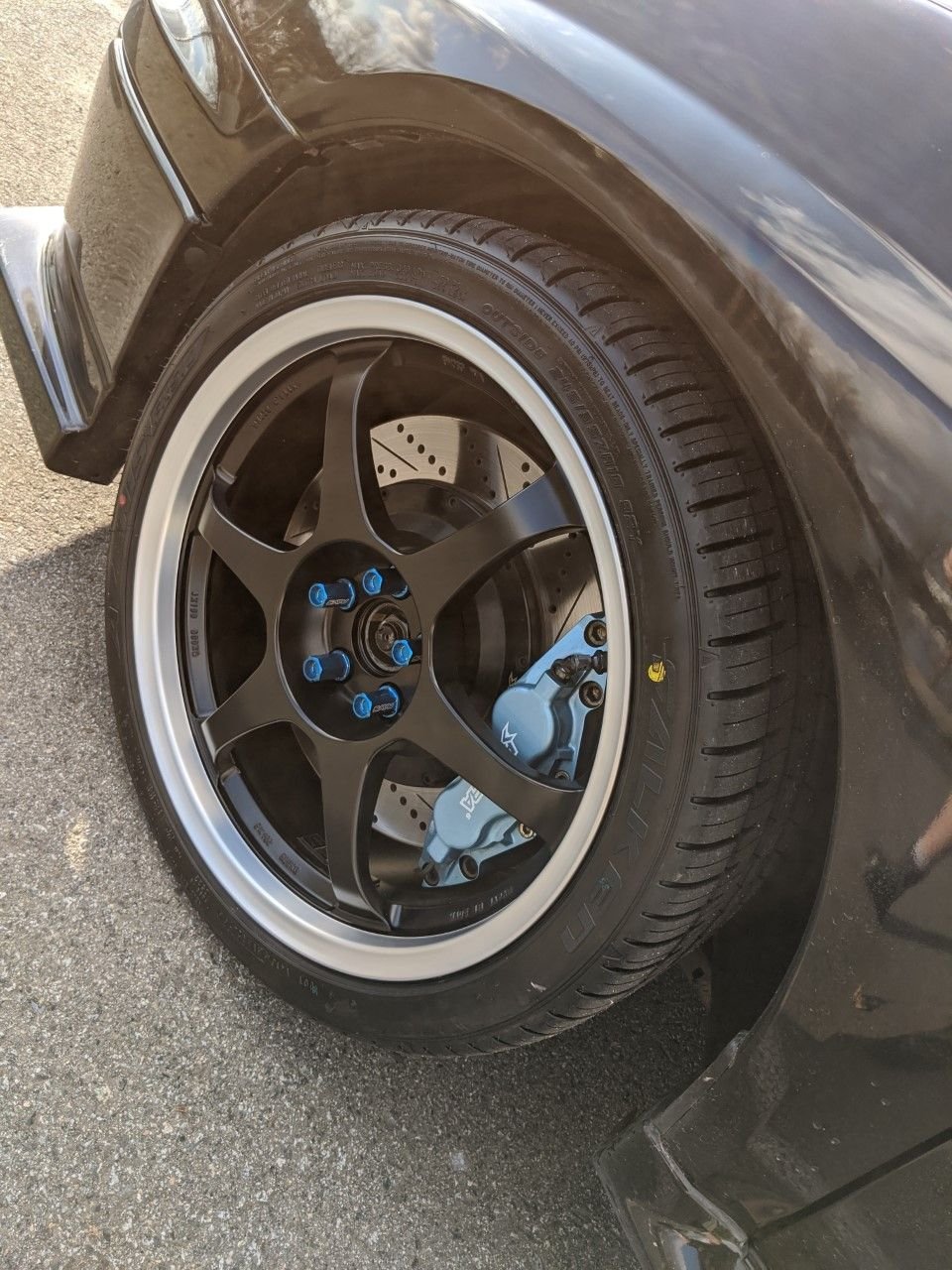

Nice. But that is a really tight fitment. No way you could fit 18s I'd think.
18s wouldn't fit over the brakes - the limit on 18s is usually around a 14/14.5" rotor, depending on wheel design.

Here are a couple of pics with a 14" rotor with an 18" SSR - you can see they are very tight, and there is no way I could get a 15" rotor on without a 19" wheel. This is also a smaller 6 pot caliper than the one on the TTs.
