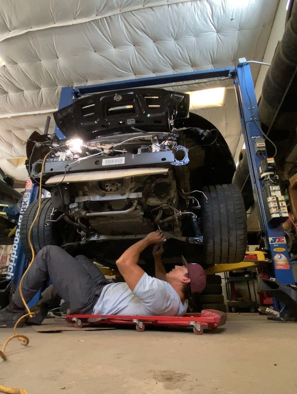

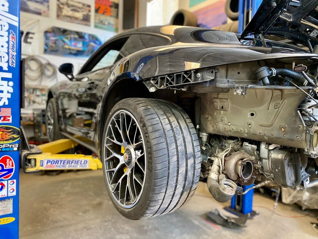

I tried to do it without pulling the bumper...horrible idea. Got stopped in my tracks fighting with the rear driver's coil pack. After pulling the bumper (easy) and the over cat heat shields (also kinda easy) life got improved immensely. That said....I'm a jet engine mechanic and I still wouldn't flaunt it and call this an easy job.
Jackstands
Wheels
Rear Wheelwells
Bumper
Turbo Intake Elbows
Overcat heat shields
Valve cover/coil heat shields
Coil packs
Plugs
Reassemble
I was actually able to get a torque wrench (straight) on most plugs and coil packs.
Two things are a real bear:
- Rearmost driver's coil pack (doesn't clear turbine housing very easily when pulling out - gotta clock it right while extracting)
- Rear bolt that holds the driver's side valve cover heat shield is a monster to start/reinstall (the turbo is all up in the way). Might be easier with an etorx ratcheting dogbone (I bought one afterwards for the next time).

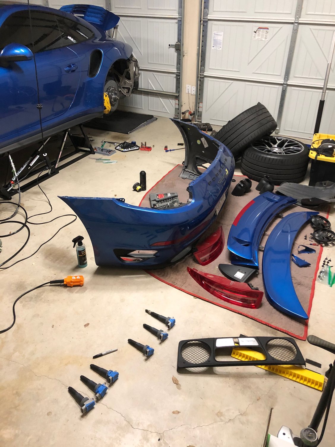

Started taken the car apart. The driver side Turbo heat shield, maybe its because I have aftermarket Cats, loosening the heat shield makes no difference since I cant move it out of the way. You are correct, the drivers side valve cover bolt is going to be a bear. I have a torx ratcheting wrench and its still going to be hard to get to. Starting to think removing the exhaust, so I can remove the cats will be easier in the long run.
I would love to see how a Porsche technician would do this.
Lucky this isn't my daily so it can sit on the lift and I can take my time.
