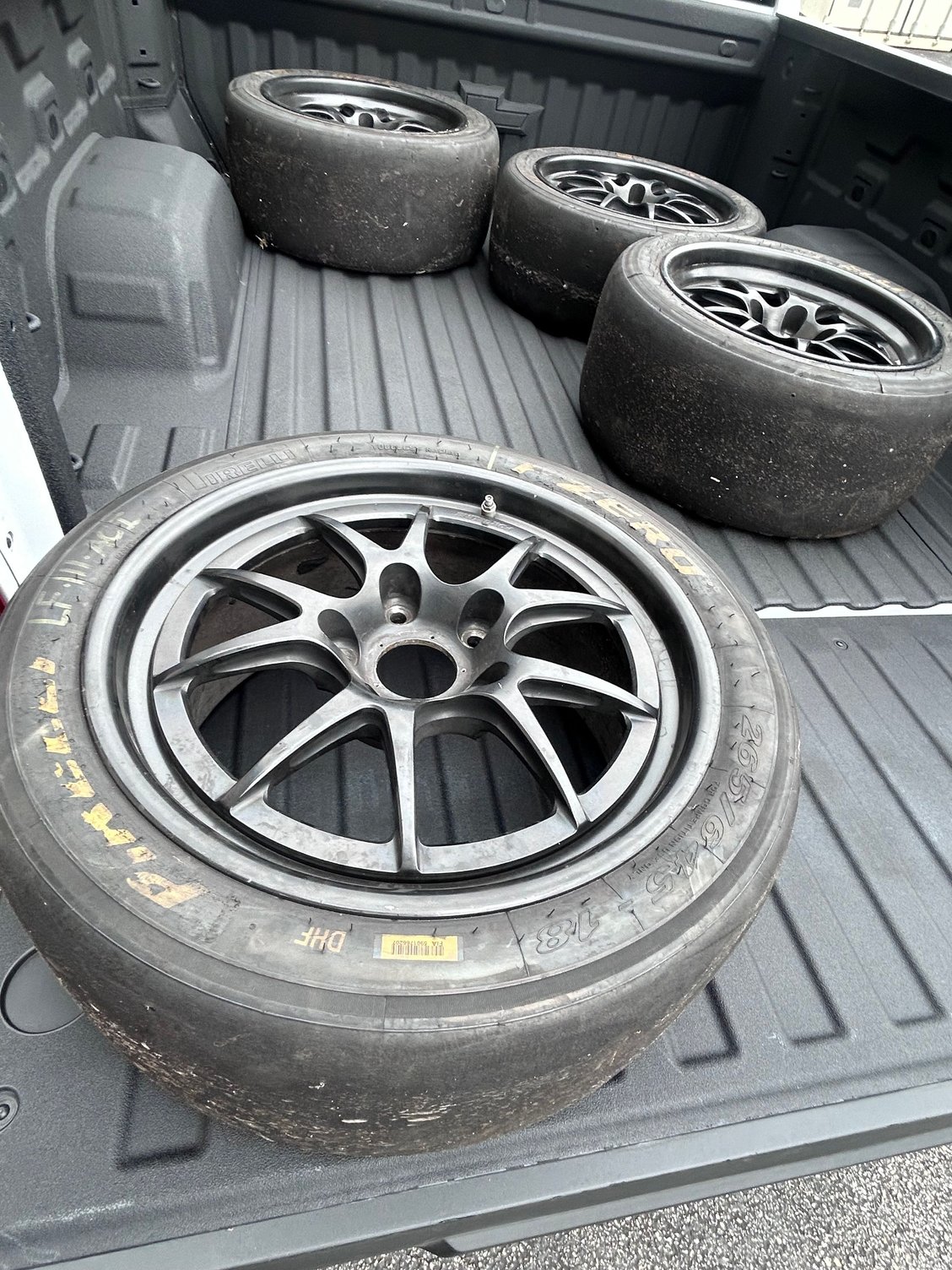

I have a set that might work for you

@SHooks Haven't seen those before, definitely interested! What are the sizes and what do you want to get for them? Send me a PM if you prefer.
Old Apr 30, 2026 | 10:21 AM
SHooks's Avatar
SHooks
Joined: Jul 2020
Posts: 634
Likes: 469

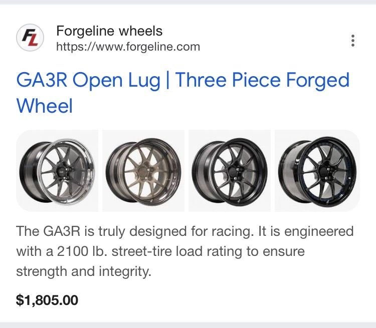

They are Forgeline GA3R
I will send you a message
