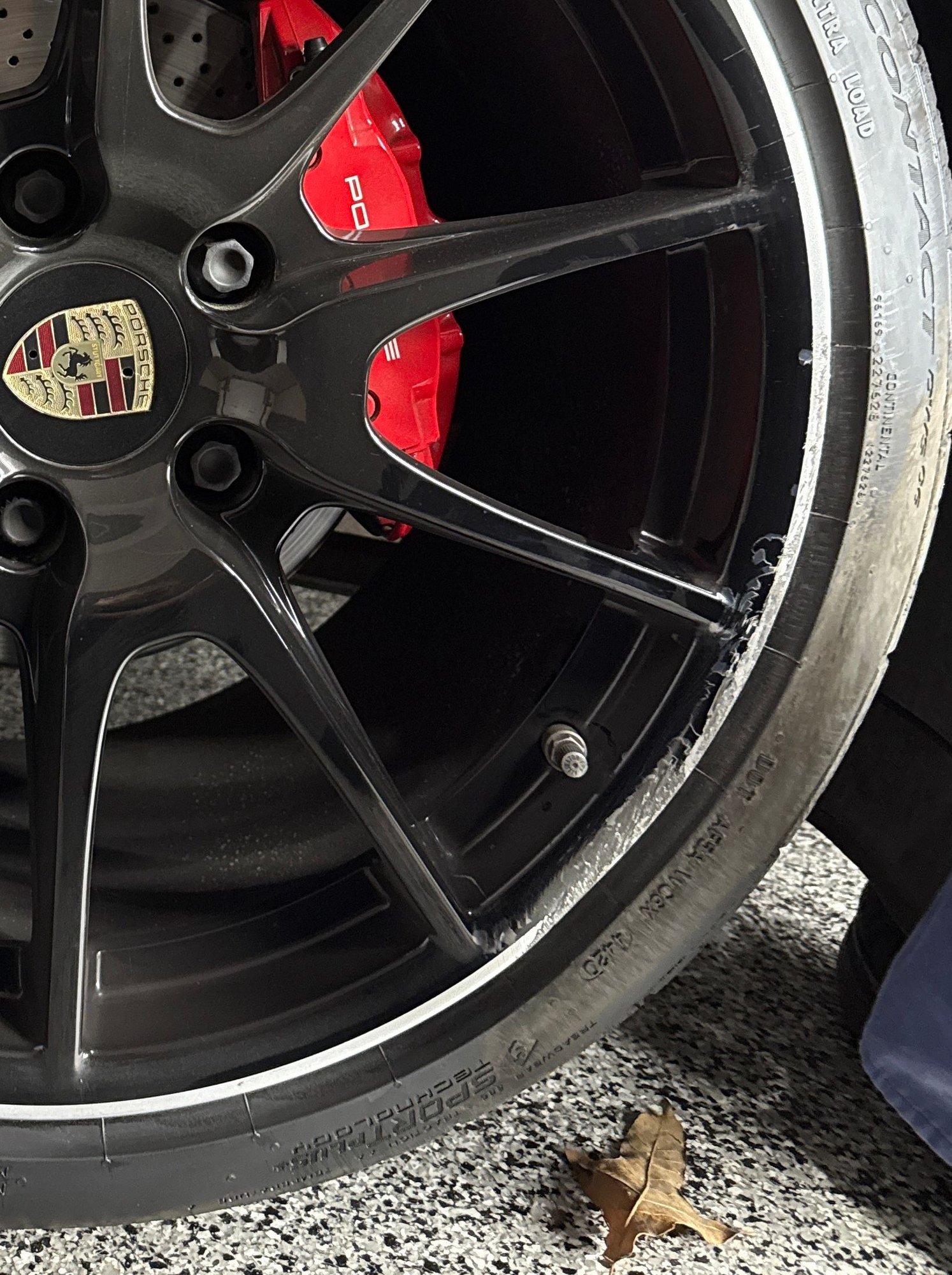

Well, I smashed my OEM 19 inch rear wheel on my new to me 2012 S… Doesn’t look too bad, but 2 reputable shops say it isn’t repairable. I have a replacement ordered which will take at least 8 weeks to get here.

That's a pretty hard smack, did you check for suspension damage and have alignment checked?
Fortunately, there is no evidence of suspension damage… I should have my new tires/wheels later this week. To be safe, I’m going to do an alignment when I mount them.
