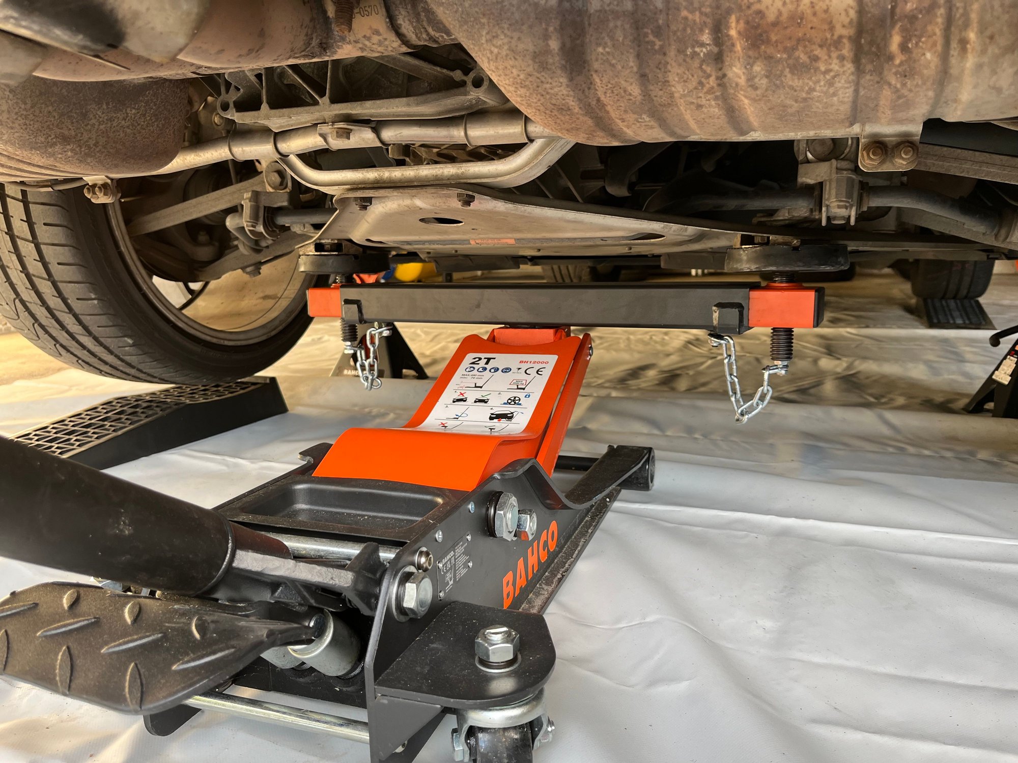

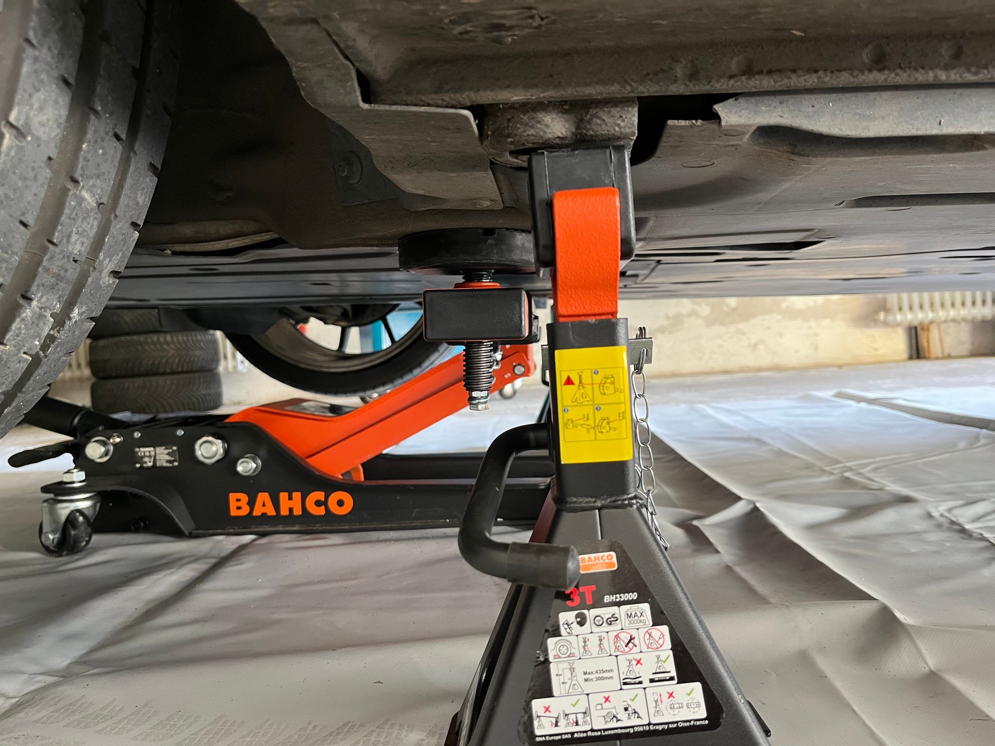

@Dave551
This is my way 😎
rear
rear
front

That crossbar on the floor Jack is something I’ve never seen before. Gives effect of two jacks and no worries about stress/twist of frame (though everyone says they are rigid and not an issue which is probably right).

Originally Posted by Dave551
That crossbar on the floor Jack is something I’ve never seen before. […]
As you can see it is from the Swedish company „BAHCO“, which is well known here in Germany.
The crossbar ist about 100 € and fits perfectly to the jack.
The usage is very, very easy.
