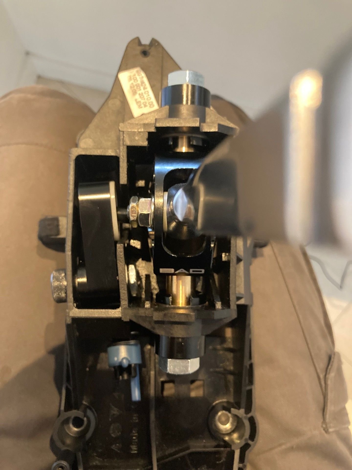

Une bonne dose de pâte de tungstène à La Réunion (océan Indien) et ça ne bouge pas. Ayant eu un SS sur eBay puis le SS complet de Ben, ça n'a rien à voir, les bagues en Delrin font toute la différence, et la hauteur supplémentaire du levier est très agréable à utiliser. Presque aucun jeu dans aucune direction

Nice. Any concern or issues with it getting hot and/or melting inside the **** down the boot?
I've seen some mention that the putty will soften/melt with some of it moving down to the base of the shift ****, but no confirmed cases that I saw of it seeping out or causing a mess.

Originally Posted by McSwine
I got tungsten putty like would be used for a pinewood derby car and did it myself.
Same here and no issues; it works well and makes the shifter feel much more substantial. I've done this in my 987 and daily driver Audi, and have had no melting or other problems after. Highly recommended.
