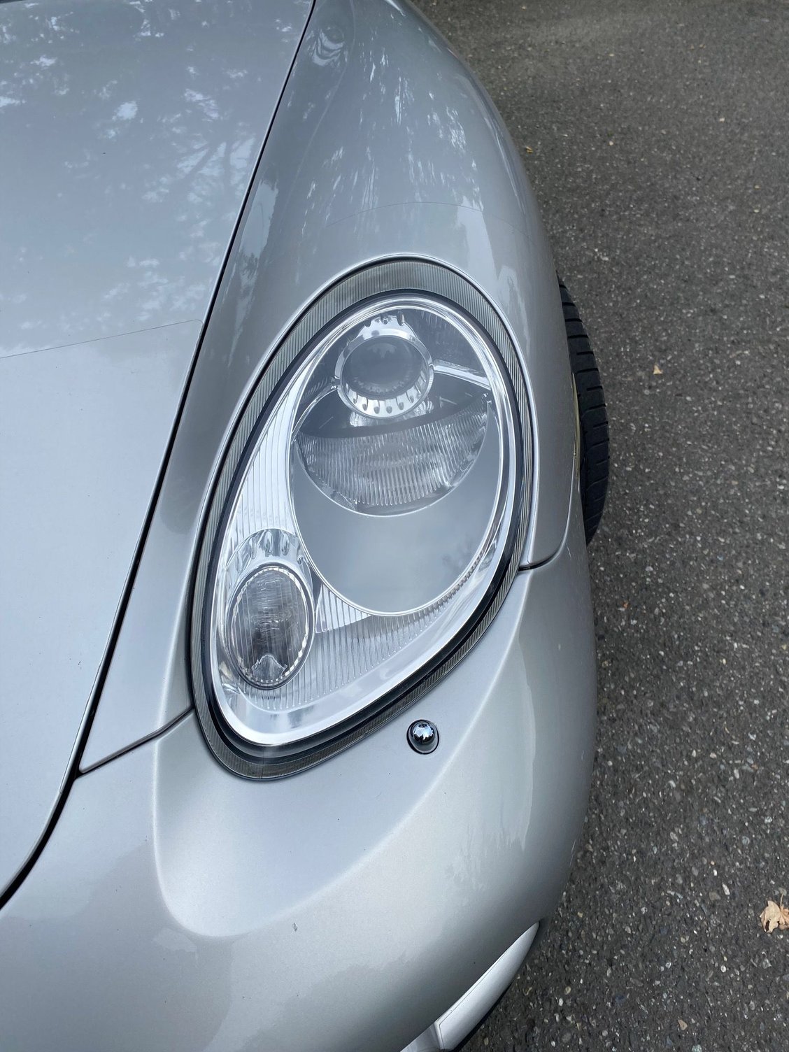

It's time to upgrade my headlights. Now I see a lot on the market, but I would like your inputs/experiences on replacing these headlights with some cool upgraded ones.
Suggestions and experiences?

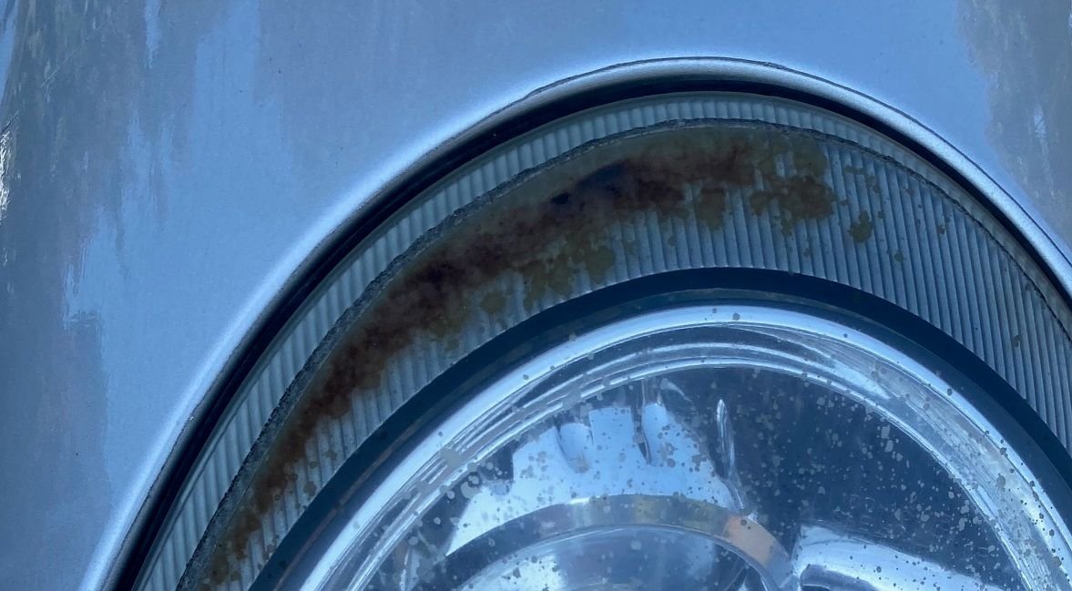

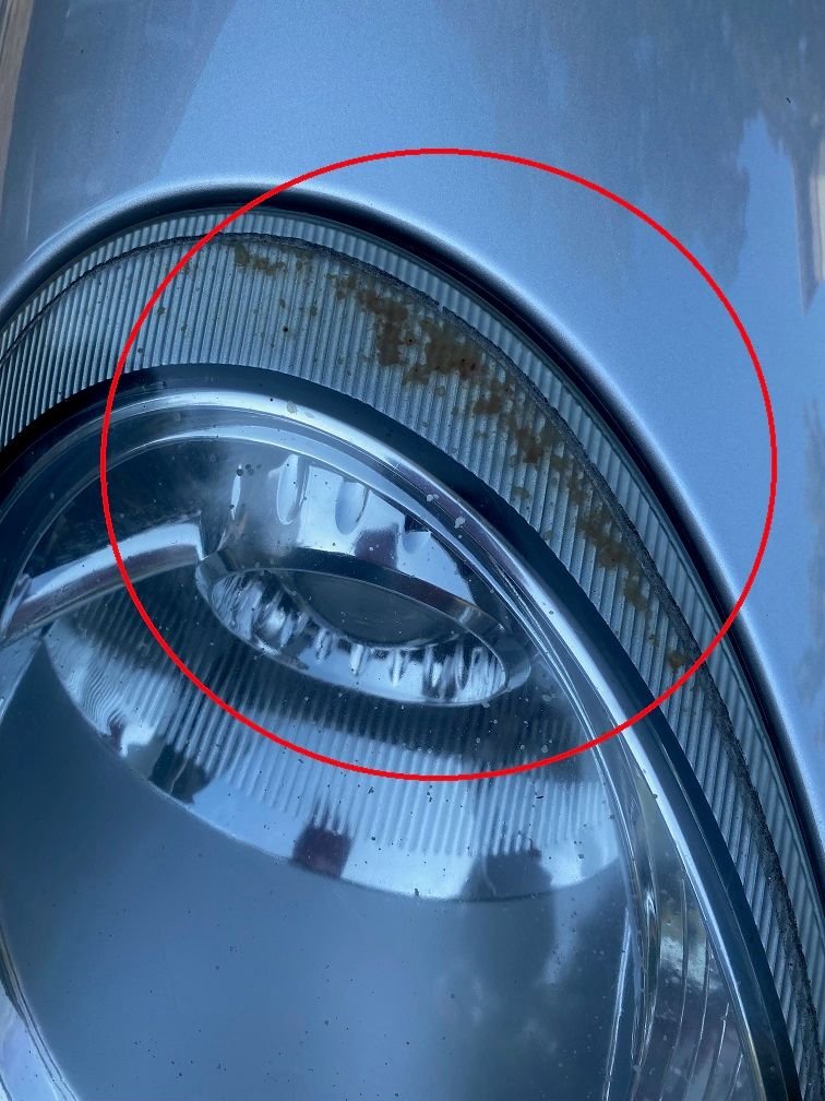

It appears that you have mildew and debris that has made its way beneath the edge of the poorly installed PPF. Tough call because if you can remove the PPF without delaminating the headlight you may have a like new headlight afterwards and not need to do anything else. We offer replacement cover services for the 997 and can provide OEM bright silver trimmed covers again or you can opt for the Carrera Sport Classic look which has a gloss black trim / bezel.

Guys, you saved me hundreds, thank you.
Heat gun to loosen up the film, heat and denatured alcohol to remove the glue. Now just like new.
