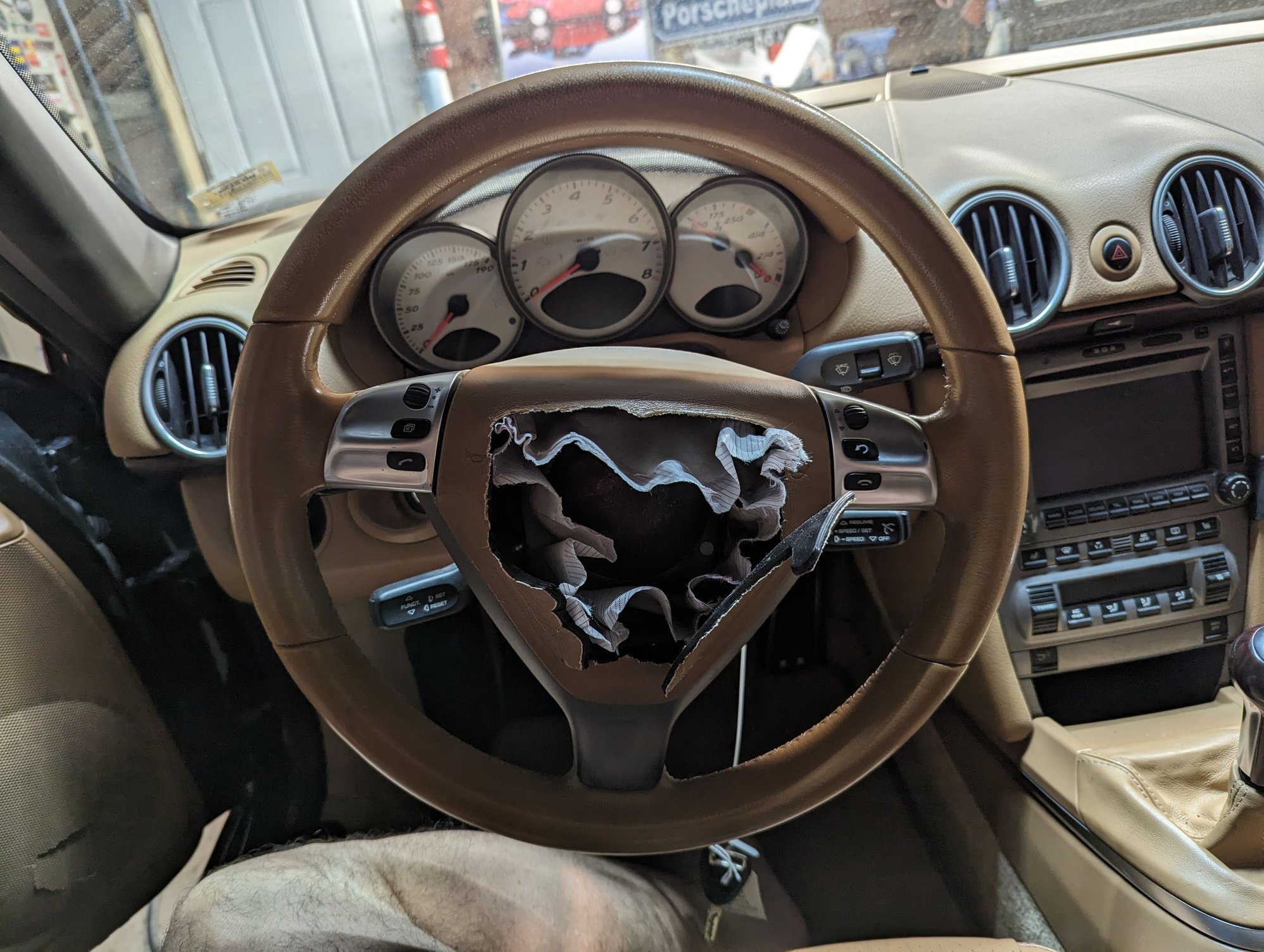

My 06 Boxster S that was recently crashed and I'm now parting out has the multi function wheel and is available to buy. I have the Sand beige interior. I can't answer the wiring question but given the "recode" comments below sounds like the wiring is universal across the models. My wheel is for the triangular airbag (mine was blown in the accident).

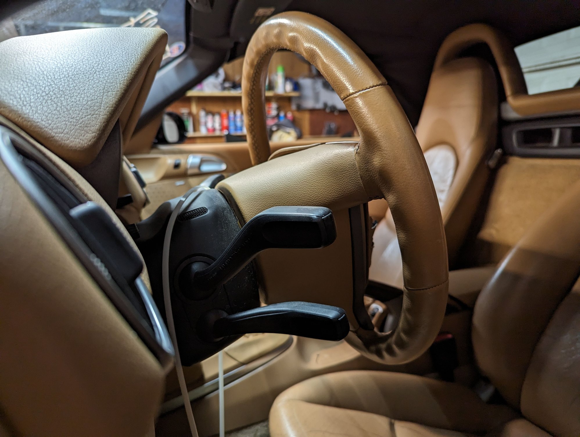

Here are shots of my wheel.
