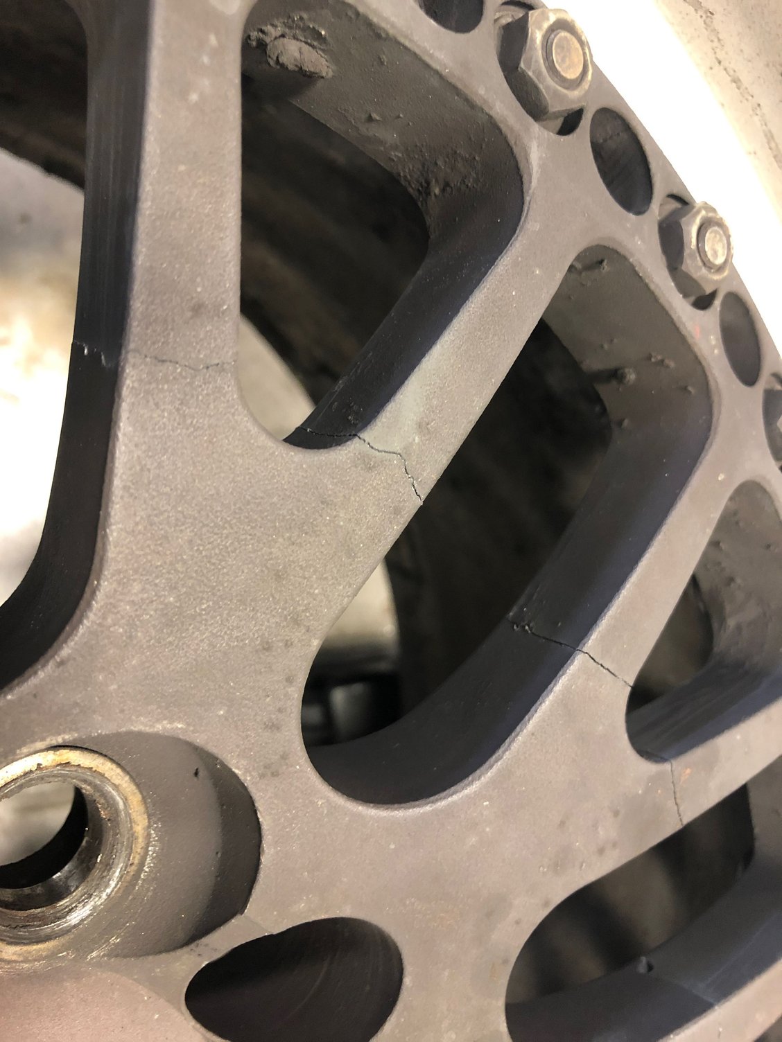

I've been tracking my 2009 Cayman S track car (Piglet) for 7+ seasons now and after 80-ish track days she's been pretty reliable; a couple niggles here and there easily addressed. Recently (4/8) I did a time trial on at Motorsport Ranch in Cresson, TX.
  • Good News - I improved my previous personal best lap time by another .1 seconds to 2:25.2 (baby steps )
  • Other news - At the end of three of four sessions I was in fourth place for my category (LA4).
  • Bad news - Thirty minutes before the last session I discovered Piglet had sprung a leak of some sort of lubricant. Not gushing, but significant enough that I wasn't going to go on track in that condition (not safe for me or others following). See the photo for the mess I made in the paddock.
  • Good news - I took Piglet to a trackside shop and they determined it was a loose fitting on the gearbox cooler pump. An hour later Piglet was fixed and no longer needed size XXXL Depends(tm). While it was too late to participate in the final Lap Attack session, I was able to safely drive Piglet home
  • So I ended up 4th in the Lap Attack.
  • More bad news - Once I got back home, the gearbox leak started again. I had the car taken to a great shop (many years racing Porsche GT3 Cup cars) and they found a crack in the gearbox cooler pump housing which caused the fitting to come loose again. Replaced with a new pump and all PDK fluids changed (clutch and gearbox). I do this every July anyway, but with the fluid leaks I moved the schedule up a couple months.
  • Even more bad news - The shop also discovered one of my wheels was cracked! Checking the wheels is part of my post-event check-list when I get the car home and I would have caught this but now I'll check the wheels before leaving the track. The current wheels are past their prime so now I'm looking at a new set of wheels (looking at BBS, Fikse, CCW, and maybe Finspeed) and replacing the bullet nose wheel studs in the process.
So... assuming I can find some good track wheels soon, I expect to get the car back in time for some events in June. Looking forward to getting back on track.

Good catch on the wheel center. Had similar crack on a Fikse center on my club racer. Caught mine before the sprint and enduro that weekend.
On another occasion, found a crack in an inner barrel.
Tracking is pretty tough on wheels, even the best forged 3-piece units. Heat cycles, rumble strips, ridiculous lateral loads. Yep, tough work.
I nailed the cracked center to the wall in my garage as a reminder to closely inspect track wheels regularly.

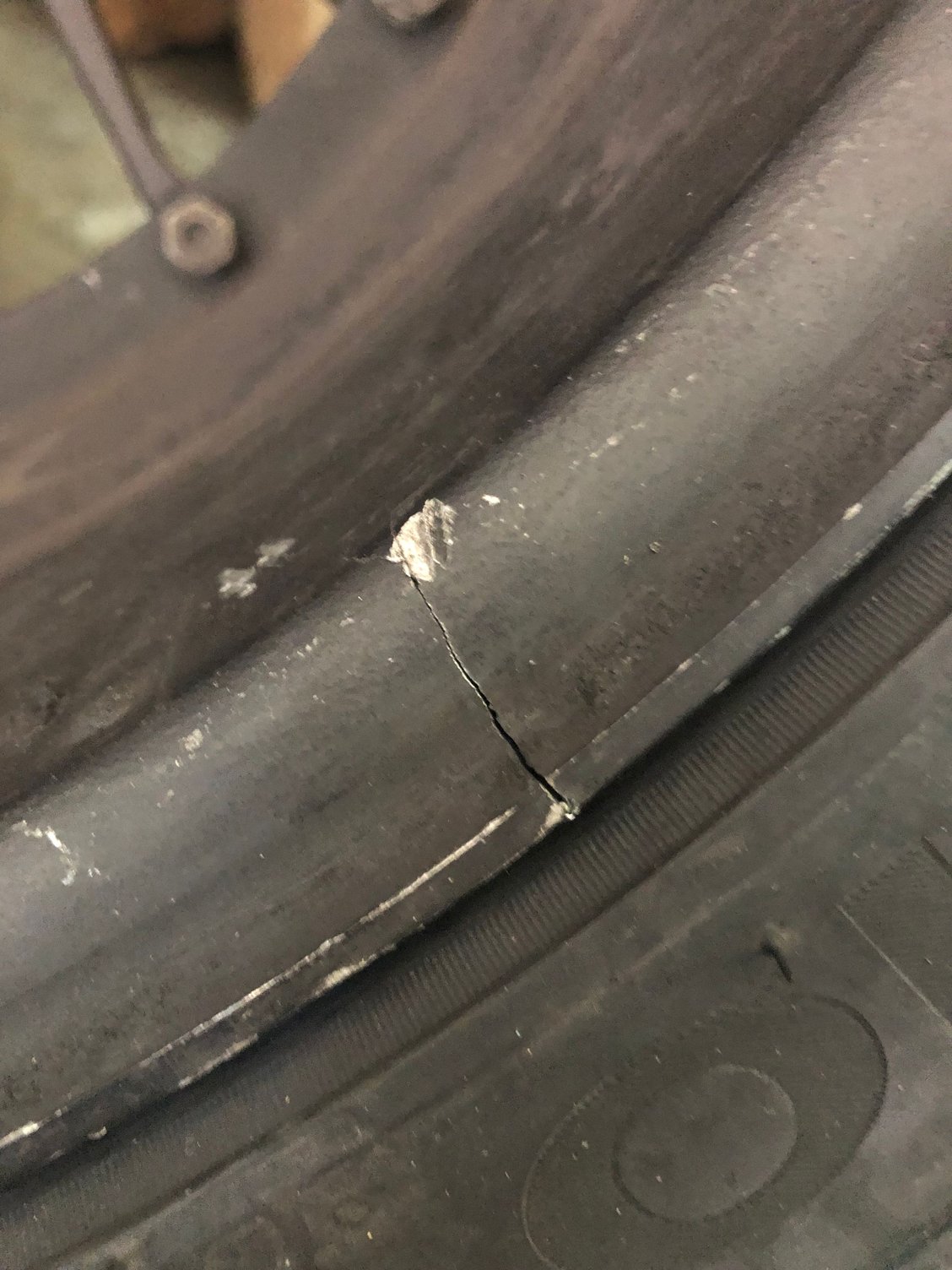

My 18 year old Fikse 17” rims (bought used) with a lot of track days on them. Spectacularly light rims. Lots of cracks at edge of the inner barrel. Replacing that barrel and gonna disassemble the other three also to inspect and reseal.
Multiple cracks around the perimeter if you zoom in a little.
Like this.

Plan to keep using, inspect regularly. Wouldn’t expect a mega failure during use. Have a second set of wheels so not a big thing if a crack was to be found. Maybe I hit something or the tire lost pressure during a session and hit maybe. I found the issue when I was checking hot pressure and found one very low. At home days later found it leaking.
