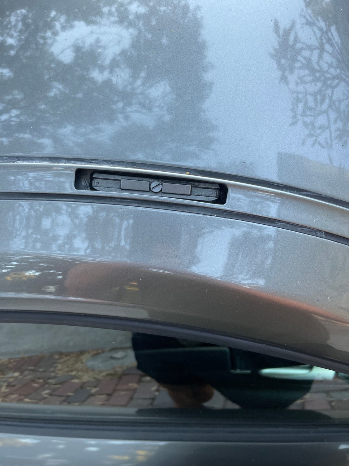

Hey everyone I haven’t seen a forum post about this so I figured I’d ask, I was just wondering if anyone knew what I would need to search up in order to find a replacement for the roof rack bracket cover piece(pictures below).2011 cayman

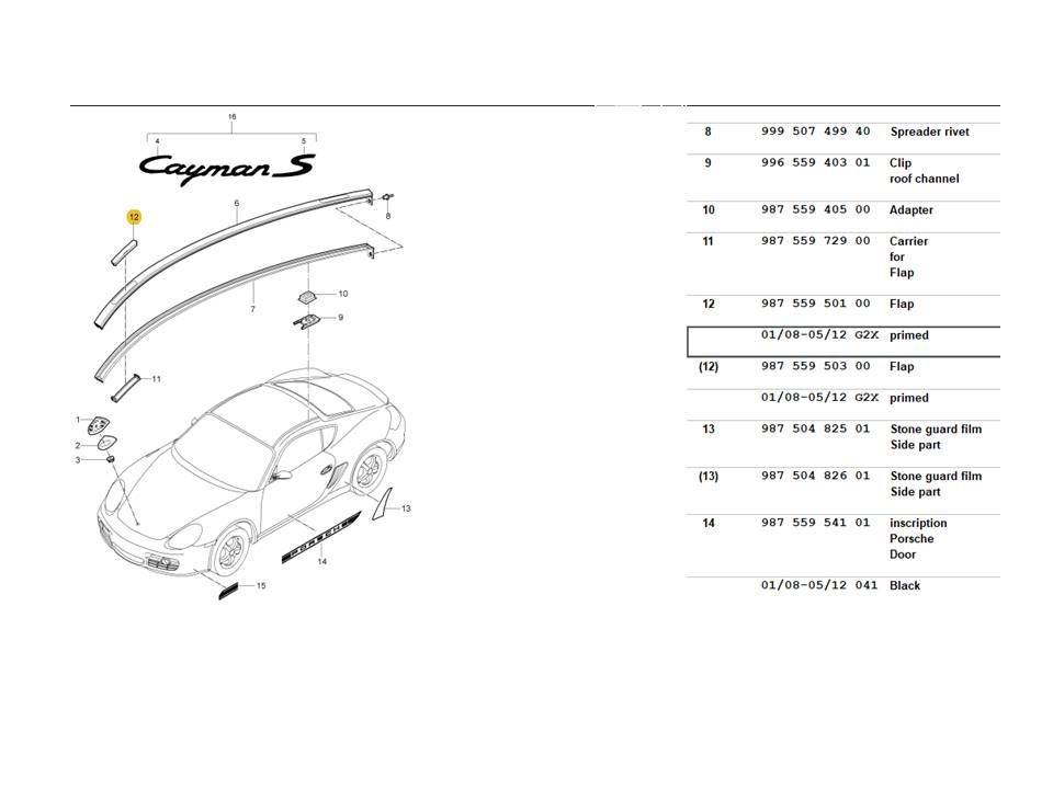

PET catalog page for 2011 Cayman. Items 11 & 12 are needed.
