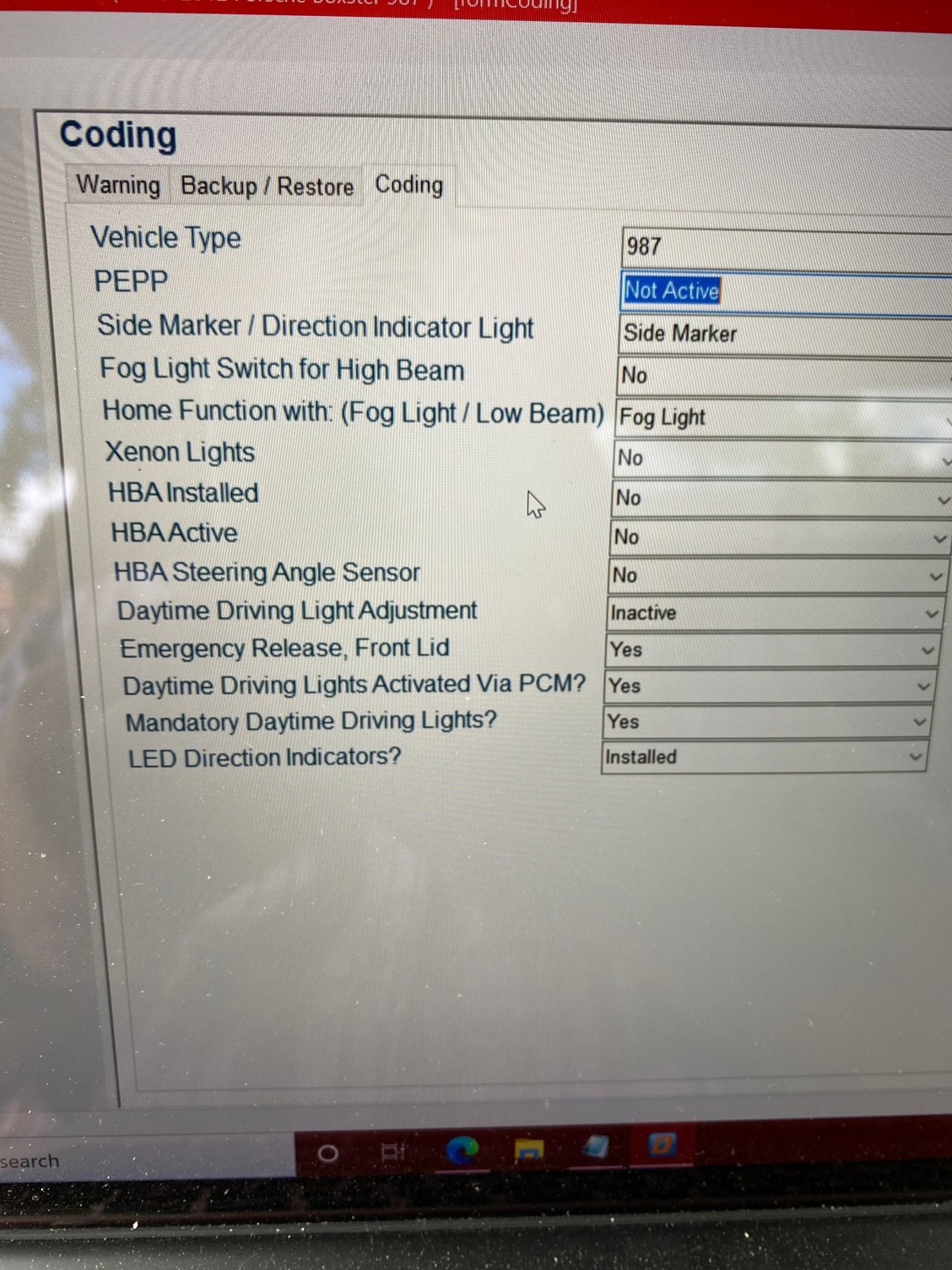

Hmmm…anyone know what PEPP is?

See the last post in this thread: https://rennlist.com/forums/987-foru...unication.html
