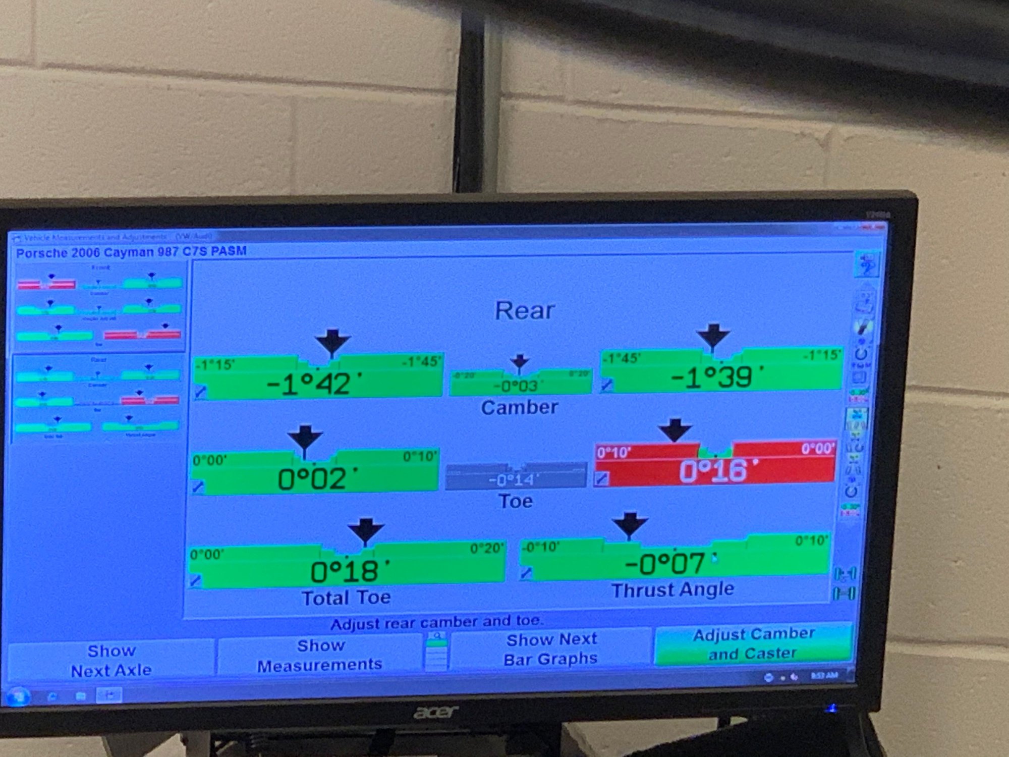

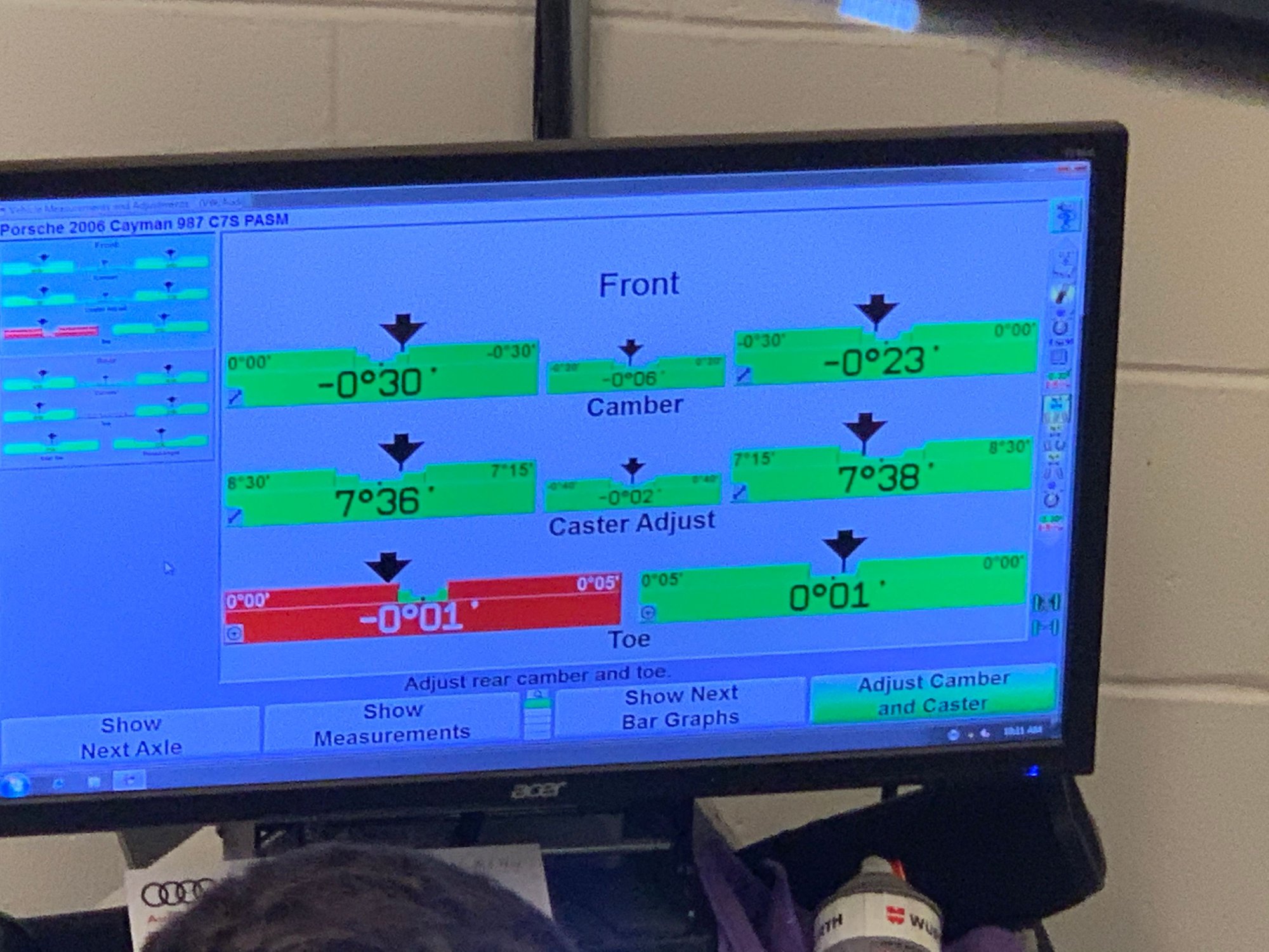

What's your alignment setting?
Old Jun 23, 2021 | 01:02 PM
IsaacR's Avatar
IsaacR
Joined: Nov 2020
Posts: 20
From: Chester County, PA
Originally Posted by IsaacR
Come to think of it, these may be the before settings. I don't remember, but I don't have any other photos. From what I remember, the rear camber cannot be adjusted any more and was throwing the rear toe/thrust angle off. Nothing bent in the suspension.

I would start by getting a set of GT3 LCA and set the front camber to -1.5 at the minimum. The factory front camber setting suck for sports driving.
