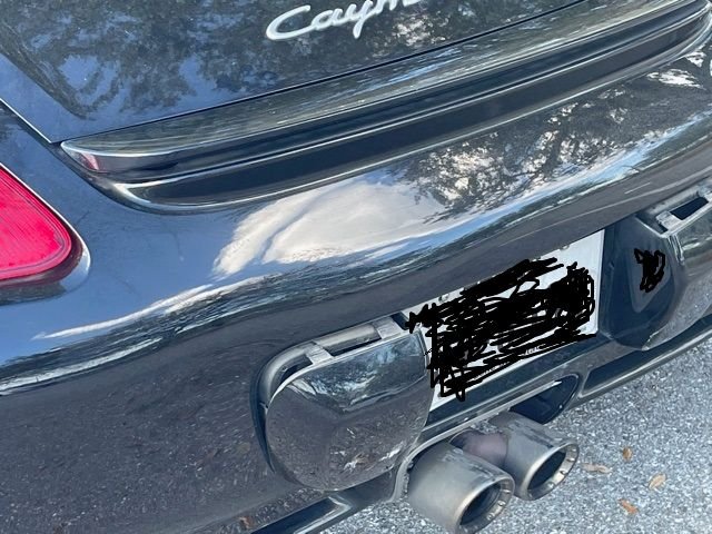

My 2006 Cayman S that got hit in the rear (seems fairly minor). The two little bumper covers are obviously damaged, but it seems the bumper it damaged too from this image? It looks curved I think. Does that mean they need to replace/repair the bumper and may some things behind it too? It seems to the me the exhaust tip is sticking out further than I remember too? Anything else I should be aware of when getting it repaired?

I would get them to clean up that license tag. Wow! It's one thing to hit the back of your car, but then to scribble all over your license tag with a sharpie is just downright adding insult to injury.
The bumper should be easy to fix by any body shop. But that ink? I just dunno.

Ha, cool. You never know what sort of internal damage issues might be waiting behind the scenes (sensors and what not).

Bumper does look bent. A good body shop should be able to fix it though. I'm told these bumpers do have a memory, if they are not too bent (yours does not look like it is) hot water or heat gun can get it back in shape without hurting the paint.
Even if it is too far gone, bumper is pretty cheap on these cars

Thanks, I always dislike when there is a repaint..especially on plastic. I will ask them about that.

btw, they said the curve there is part of the normal design. It seems to me that is probably the case since it looks symmetric and I think there would have been some significant misalignment at the seems (and maybe cracking in the paint otherwise). Can anyone confirm that? I saw a late model Cayman and it was "smooth", but it didn't have the bumper plugs either.

They are saying they don't see any damage to the bumper and that this is the normal design....just seems odd to me that it would be a Porsche design. I don't remember it being wavy like this but can't really remember.

Take it to a dealer and have their shop look at it. Then go back to the other guys insurance. My brothers 997.2 was barely tapped in the rear. shop opened it up and there was a lot of hidden damage. He was almost ready to let the woman who hit him drive away at first glance.
