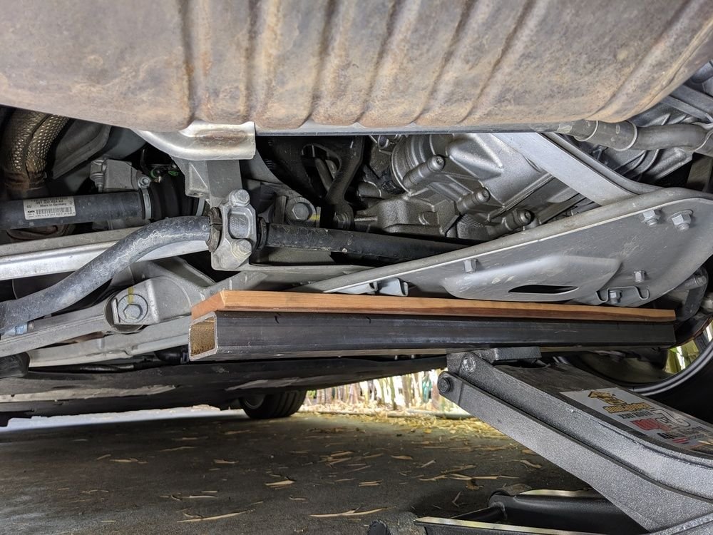

Here's what I use. I jack up each rear and put stands under the front. Then use this to put stands under the rear jack points. Just bought some scrap steel and bolted a 1x4 board to it.
