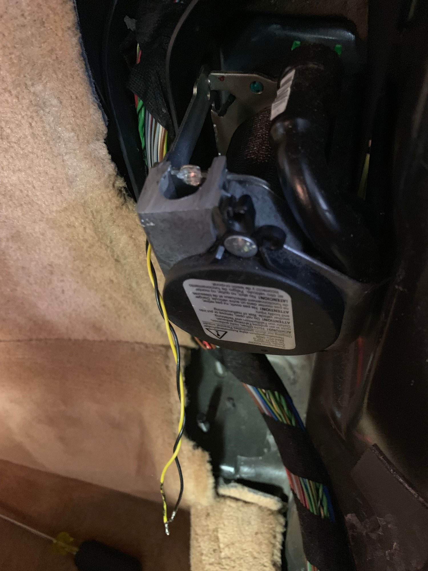

However, here's where things get concerning. Knowing that the car was rebuilt, I had a detailed PPI done by a Porsche specialty shop. The shop gave it rave reviews, going so far as to say "if you hadn't told me it had been wrecked, I wouldn't have been able to tell". I'm starting to think he said that because he didn't actually look at it very hard. Since I've had the car for a few weekends, I've been addressing the little things the car needs... GPS antenna disconnected, autodimming rearview not working, tiny coolant leak from (I think) one of the heater core lines, rear trunk sensor unplugged (I assume because they didn't like the passenger window drop feature?), exhaust tips misaligned... during which I've found some things the PPI *should* have noticed: missing/incorrect bolts on the exhaust headers, missing rearmost under-tray, some loose wiring brackets... but this one takes the cake:
The picture isn't great, but what you're looking at is the original seatbelt from before the accident, with the blown pretensioner hacksawed off and a resistor soldered in place of the connector to prevent the airbag light. So, I know this sorta crap happens with shady rebuilt cars... which is why I brought it to a shop for a PPI and explained the car's history in detail. And it was only because the shop's opinion lined up with my own research and (limited) inspection of the car (and the low price, of course) that I took the risk on it. So, there is a high likelihood that I won't get any satisfaction from the shop or the seller now that money's changed hands, and this car is going to be a project of sorts... which was understood when I bought it... but I wanted a track car project, not a "fix all the broken stuff" project.
Anyway, long story short, I'm on the hook for fixing this thing. I assume I can order up a new belt from Porsche, via any of the online dealers. But where I'm really stuck is that I need the harness side of the pretensioner plug, since the original was clipped off. Does anyone know where in the world to find that? There are several sites I've found that sell these connectors, but none of them seem to match the one used by Porsche. Is anyone building a race car with no need for a seat belt connector and about 3 inches of wire?

Just so happens I have what you are looking for. Pulled from my 06 cayman S race car. I kept all the wiring just in case I needed it..
I really don't like the liability of selling used safety equipment, but can appreciate the pickle you are in.
200 seems to be the going rate for the pair, so how about 100 for rennlist?

Wow that’s fantastic! I don’t specifically need the passenger side, but I’m happy to buy both if you want to sell them as a pair! I will PM you my contact info.

Consider the second one free :-). Just sent the request money via paypal.

Wow, thanks a ton jscott! I paid the invoice and replied to your email. I really appreciate the help!

Just wanted to bump this up with a huge thank you to jscott. I swapped the belt and wired in the proper connector and my Durametric scan confirms no codes. Thanks so much for helping me out!
