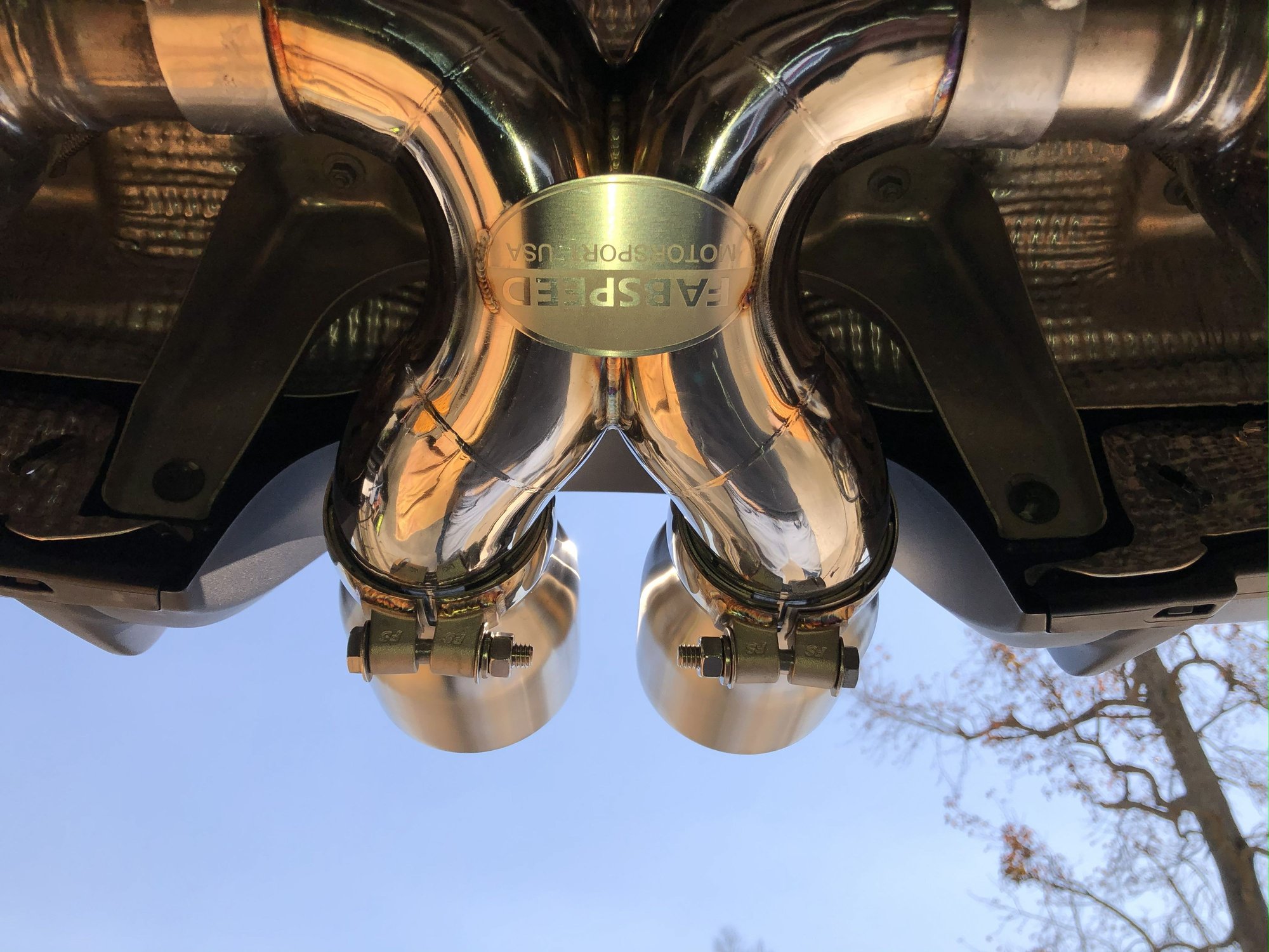

Originally Posted by srb1194
Thanks. The PSE is only a year old so changing the tip seemed like an added expense without any dividends. I appreciate your advice.
Makes for fun pictures though.
Those are the Gen 2 Fabspeed x-pipe tips, wish mine still looked that pristine clean . I have the Gen 1 version, look more like an X versus the two joined U-tubes.
