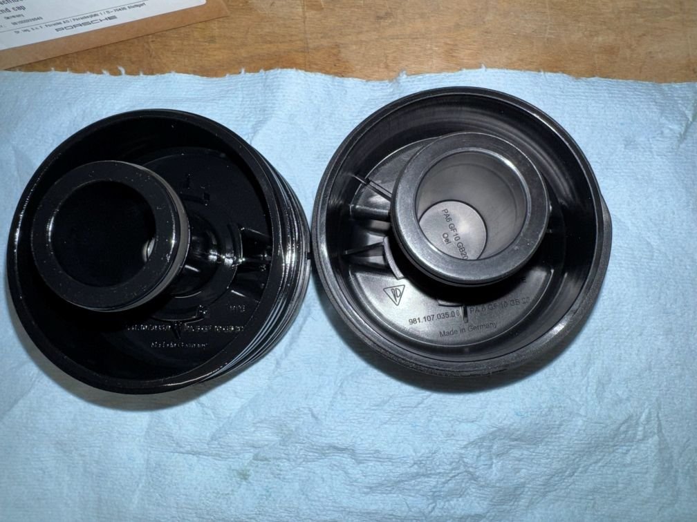

Noticed my 2016 981's new oil cap (981-107-035-08) has the same part number as the old cap yet only the new one has the second O-ring. Was the -08 revision silently updated to include that second larger o-ring?
I'm hoping the new cap prevents oil vapor from escaping the filler neck better than the old one I've replaced. It was only a trace amount before, but I consider any an indicator of a poor seal and that's unacceptable.
So far so good but it's only been about a week. However, I think I'm noticing a couple additional benefits of replacing the cap. I can't prove it, but the car appears to have a longer and cleaner cold start idle flare before the RPMs settle down. Further, and I really can't prove this, but wide open throttle pulls appear to be a bit cleaner too. Maybe that's all placebo, but it'll be $30 well-spent if the new cap indeed eliminated all oil blowby.
Old on left, new on right:
To show the share the same part number:
close up of old part number

You're not wrong, it's been documented that adding an o-ring to the cap has helped the engine run smoother.

Happy to contribute anyway even if I’m late to the party on this item. I found threads about this for the 991 but I think that’s a different part number. Am pleased to know it’s not placebo effect!

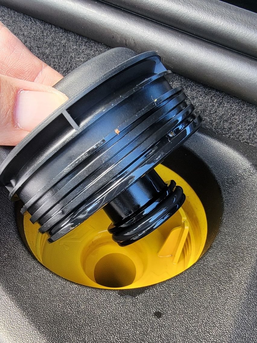

I haven't been aware of any stumbling or power dip with my old cap but when I looked it was very obvious that oil was getting past the lower o-ring. I plan to replace with the newer version for better sealing and if there is a slight performance improvement, all the better.
Oil cap after driving ten miles, then resting 15 minutes
