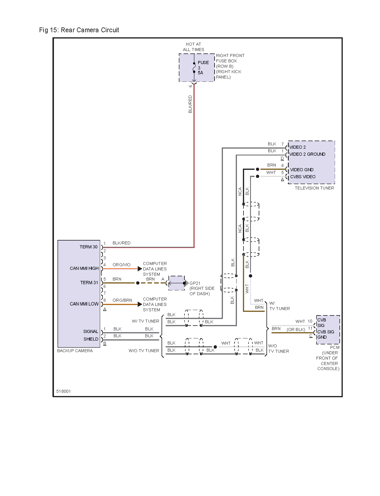

no. I wired directly. Wired it as follows can high and low connector E 6 and 12. Ground to ground screw in trunk with other grounds and power to fuse box. plus the two video lines to pins 6 and 12 on connector B.

Thanks for the diagram!
I am myself trying to diagnose a fault I currently have.
My camera was working OK but certain date coming back from the track it stopped working. I have Piwis 3 and I get the error in the reversing camera module that says "Status of Control Line Implausible"
I tested using Piwis 3 pins 30 and 31. I dont have TV tunner... so I am assuming control line refers to the high or low signal bus? Would that be the round cylindric thick wire that connects to the camera?
Any ideas much appreciated.
