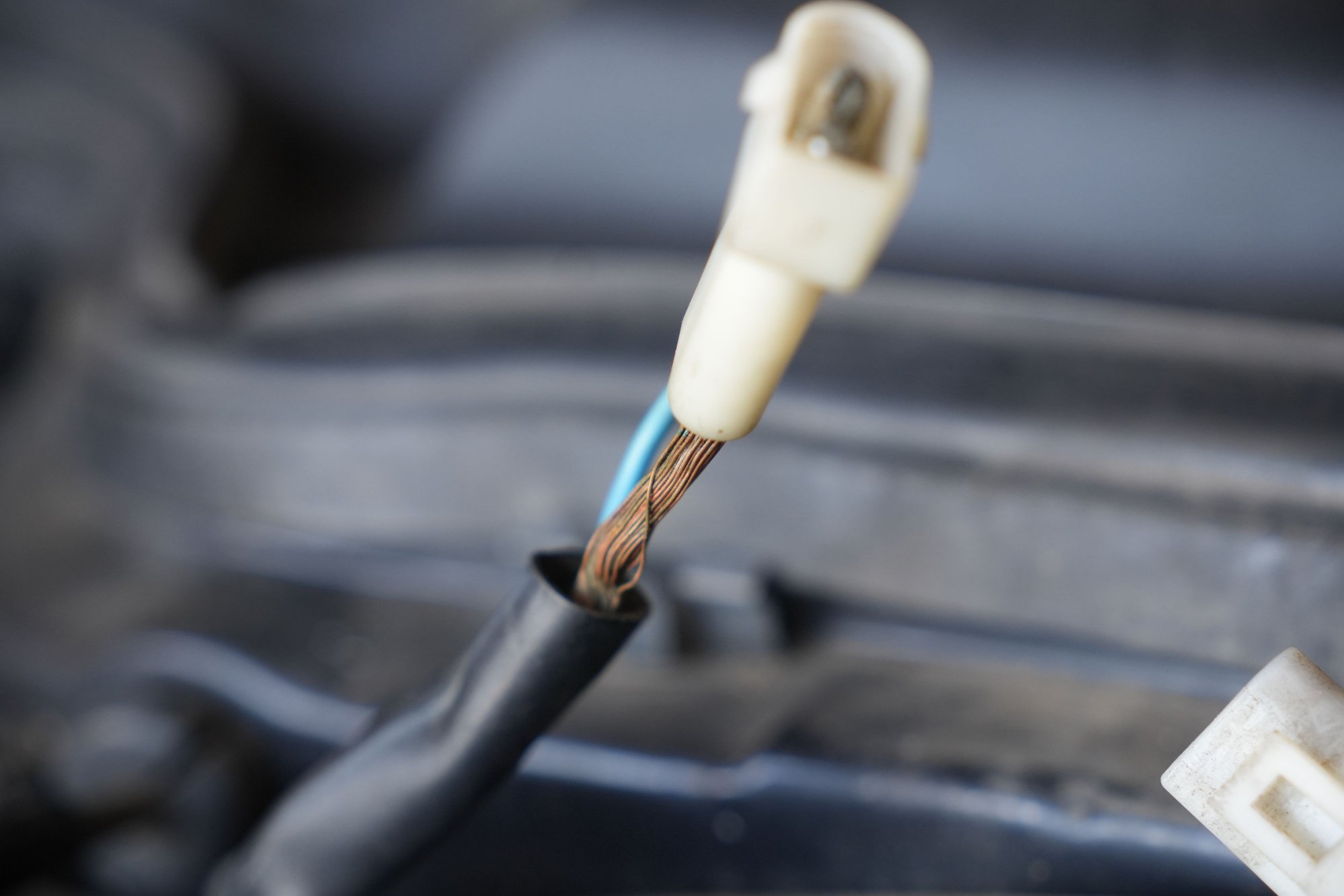

Originally Posted by Gage
Clean the T2 connector. It is a white plug located in the engine bay, at the firewall and near the brake booster.
Are you referring to this one? The one that has one wire who's insulation has completely degraded?
That is absolutely the one.
