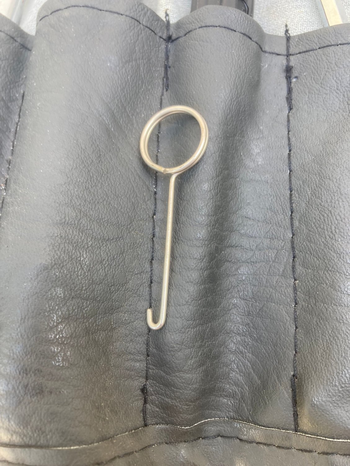

Found in my tool kit. I assumed it was a tool to pull your center caps. Someone else suggested it’s a hook to pull a secret release for the trunk if your battery is dead. If so, where is it? (Also, doesn’t make much sense to keep it in the tool roll in the trunk if that’s the case!)

I believe it is to pull the wheel center caps. I assume that a PO put it in the tool roll. I do not believe that they came with the roll initially.

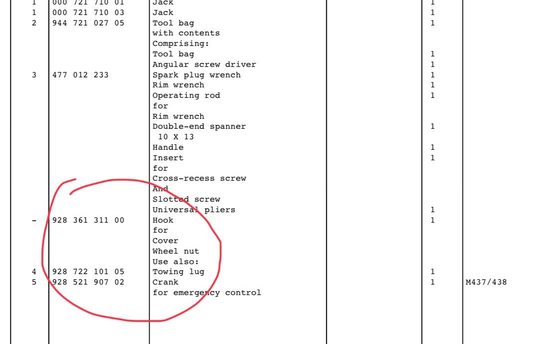

Found in PET: p/n 928 361 311 00 hook for cover wheel nut

Apparently, the can be used to pull the emergency release to the hood (located behind the driving/fog light) and the trunk/rear hatch (behind the vent in the driver’s door)

According to the PET, yes. Are you sure you don’t have it? Mine was tucked way down in the far right slot in the tool roll. I kind of found it by accident. (I could see the outline on the slot so I reached in and pulled it out)
