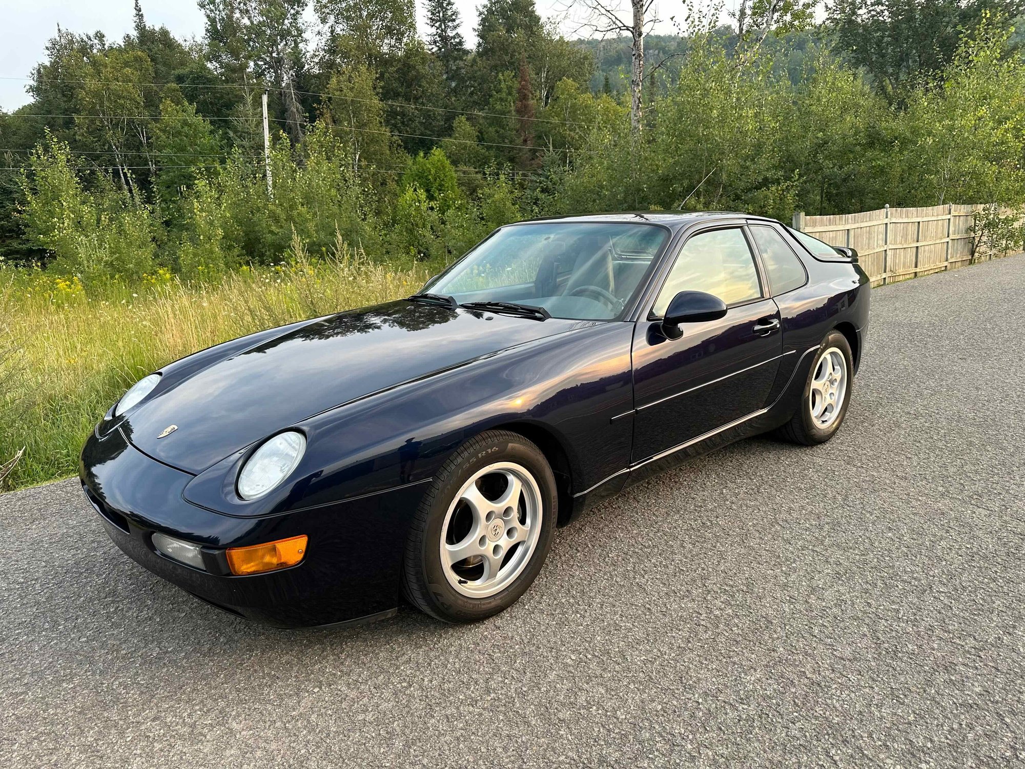

New to the 968 and to the forum, but loving the car
it so far. Picked up a 1994 Midnight Blue Coupe last fall. It originally had the CUP II 17 inch wheels, but along the way someone swapped it to 16 inch Cup I's. The tires are done and I would like to go back to 17 inch wheels. I can't seem to locate any 7.5/9 inch Cup II's and so am looking for something just a bit bigger to bring out the muscle look of the car. Any suggestion on size? I can get a set of 17" x 9 for all four corners, but it doesn't seem like a popular set up for the street.

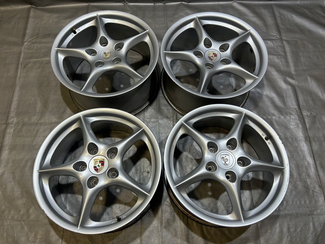

My car has Boxster Carrera rims on it. They're pretty accessible and give you a lot of tire choices.
Found these for sale, 18
Found these for sale, 18" x 9" and 18" x 7.5"

Those Boxster wheels are a great choice. I looking non Porsche aftermarket you'll probably find more options in 18x8 and 18x10 for the rear. Around 50 offset will work. Also wathc out, both non Porsche aftermarket wheels I've used had issues fitting over the front wheel hub and had to be modded.

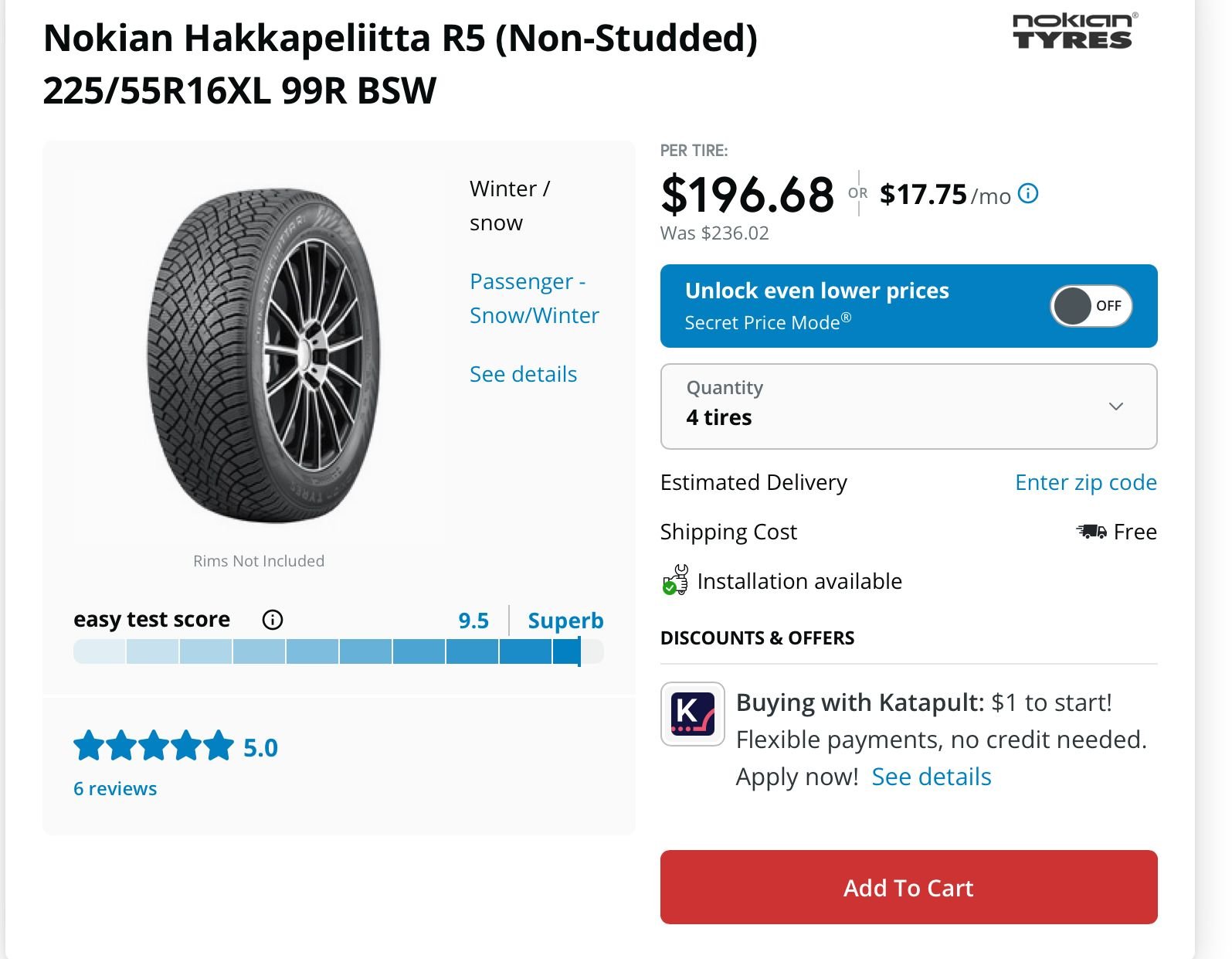

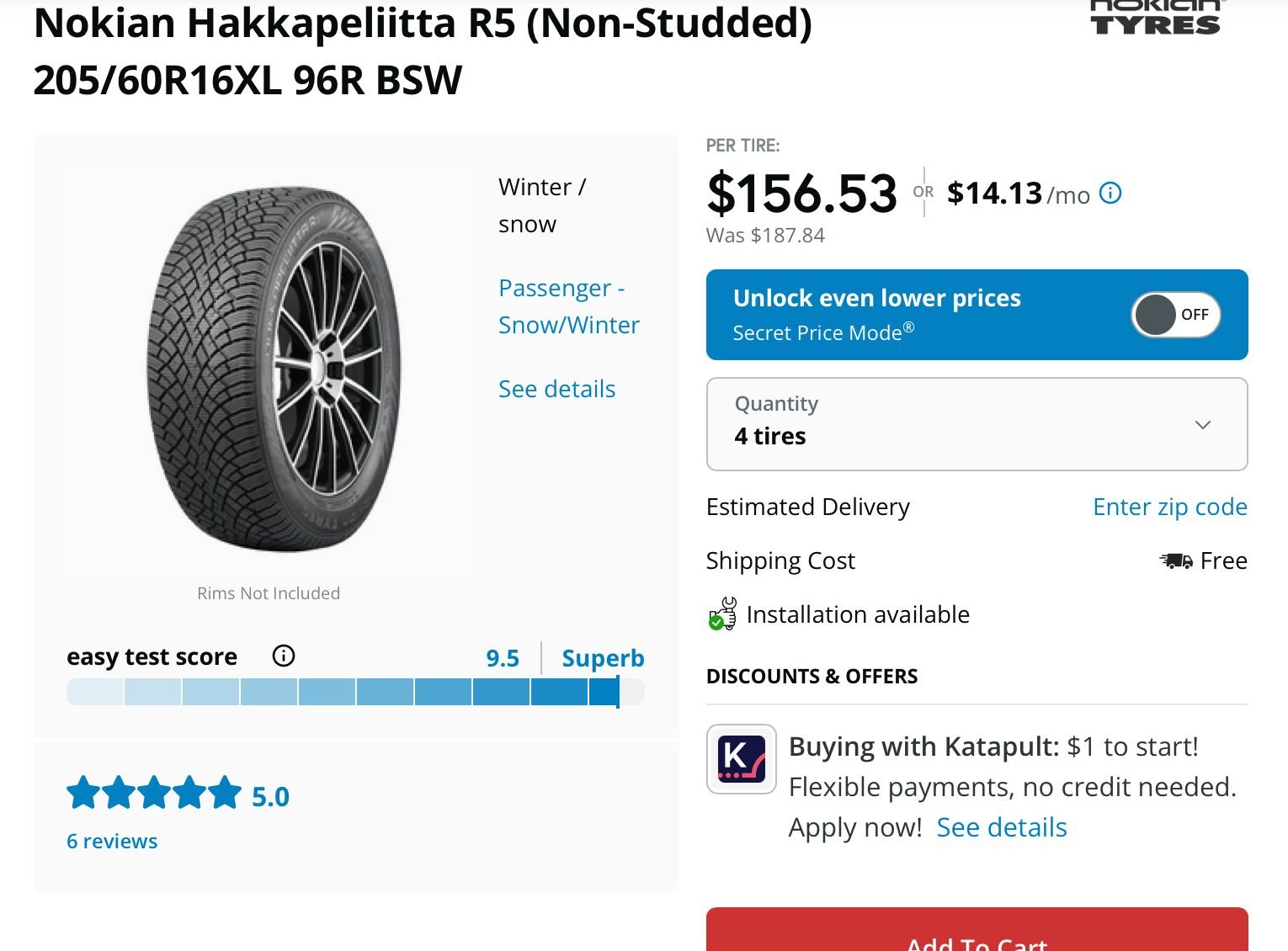

That’s what I would do. And save the 16” for some nice winter tires.Like these.
