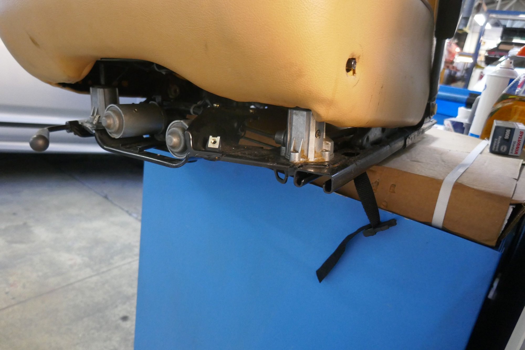

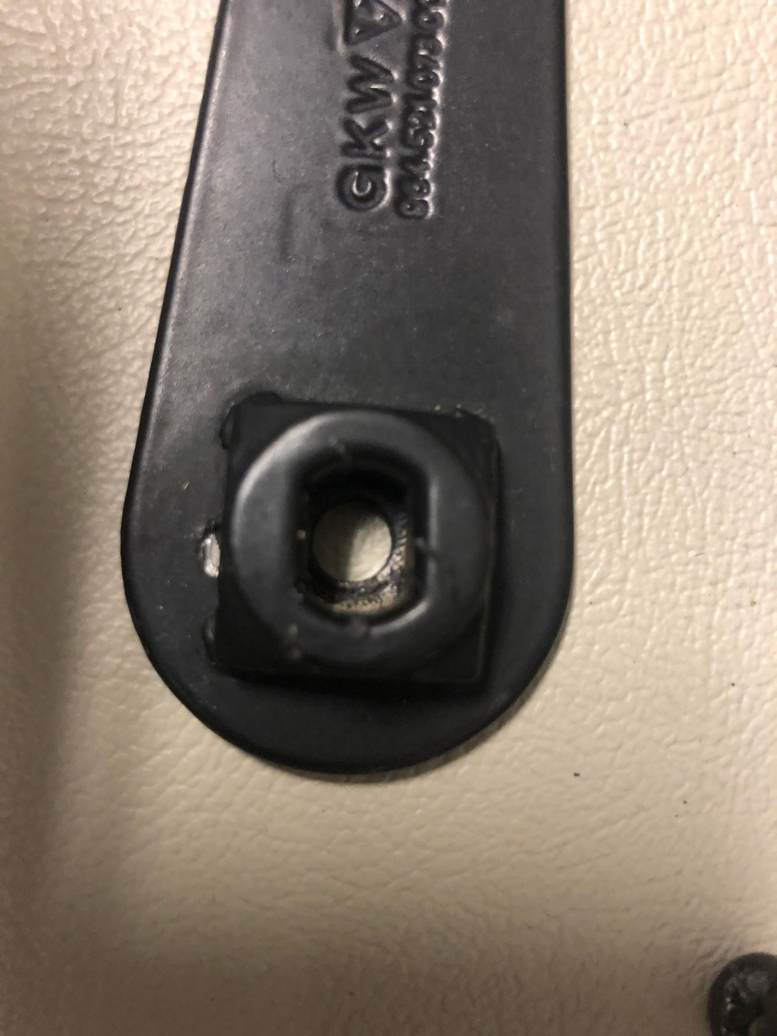

Problem: My passenger seat has only one under seat lever-See pics.
The lever is the one under the left side of the seat, this controls the angle of the back to the seat bottom.
Currently, it is at about a 85degree angle. With a helmet on, my PCA HPDE instructors can not fit.
I either want to find another lever and install it AND have it work. Alternatively, change the angle of the back to seat bottom to about a 120-125 degree angle one time.
I can not find a schematic of the 964 style seat mechanism. The drivers seat has 4 motors to control everything. The passenger seat has two motors to control hight and entire seat angle. It is supposed to have two levers. One under the left side of the passenger seat to control sliding on the rails. The other one is MISSING.
Any help would be greatly appreciated, I'm stuck!!

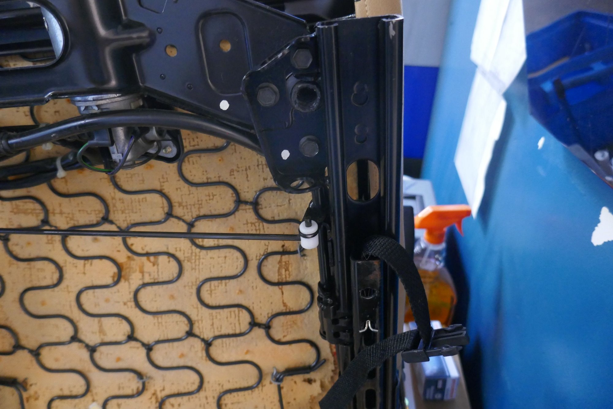

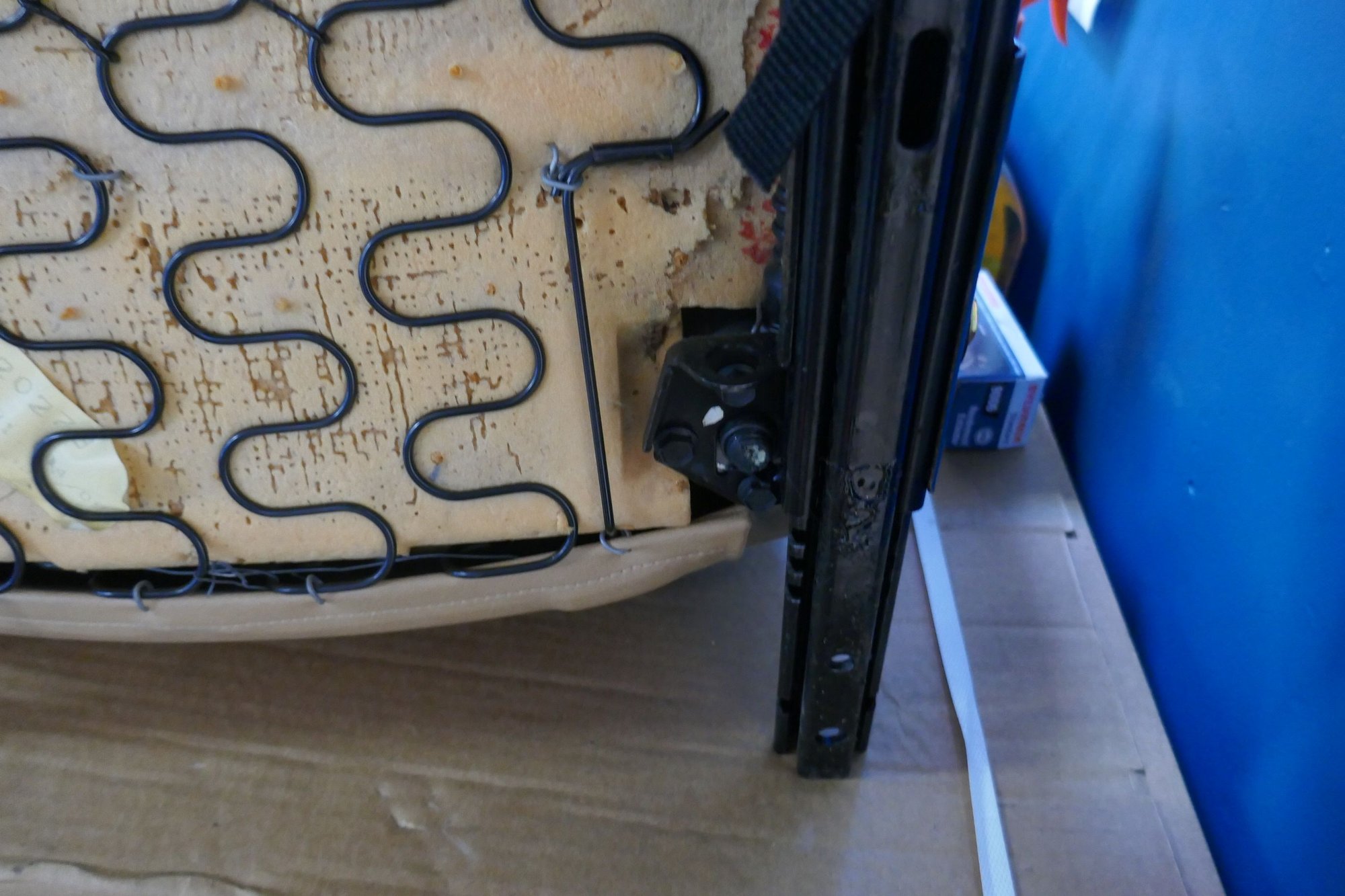

This is where is slots through
I assume this is where it attaches, is something broken?

Yogi, On your firs pic you see a round untrimmed opening with a threaded shaft..... All the way forward of the seat belt receiver and same side. The lever attaches there with a screw.. I have a few of them in a box. Send me a PM

This is it. Think same handle could fit either side. Sounds like you have 8 way power on drivers seat and dont have this handle and 4 way power on passenger side which is a fairly common trim level for dealers or P N America.
