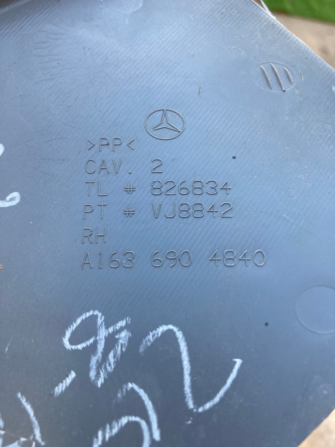

Just about every plastic part will have a molded label on it somewhere with info like manufacture date, part #, etc like this:
The bit between the > < is the type of plastic. In this case, polypropylene (PP) Check the headlight ring to determine the plastic type. You want to use a product that is compatible with that type of plastic. On ABS, I prefer the PlastiFix (and nylon mesh if it’s called for) to welding because IME ABS has a very narrow temperature range between welding and burning.
