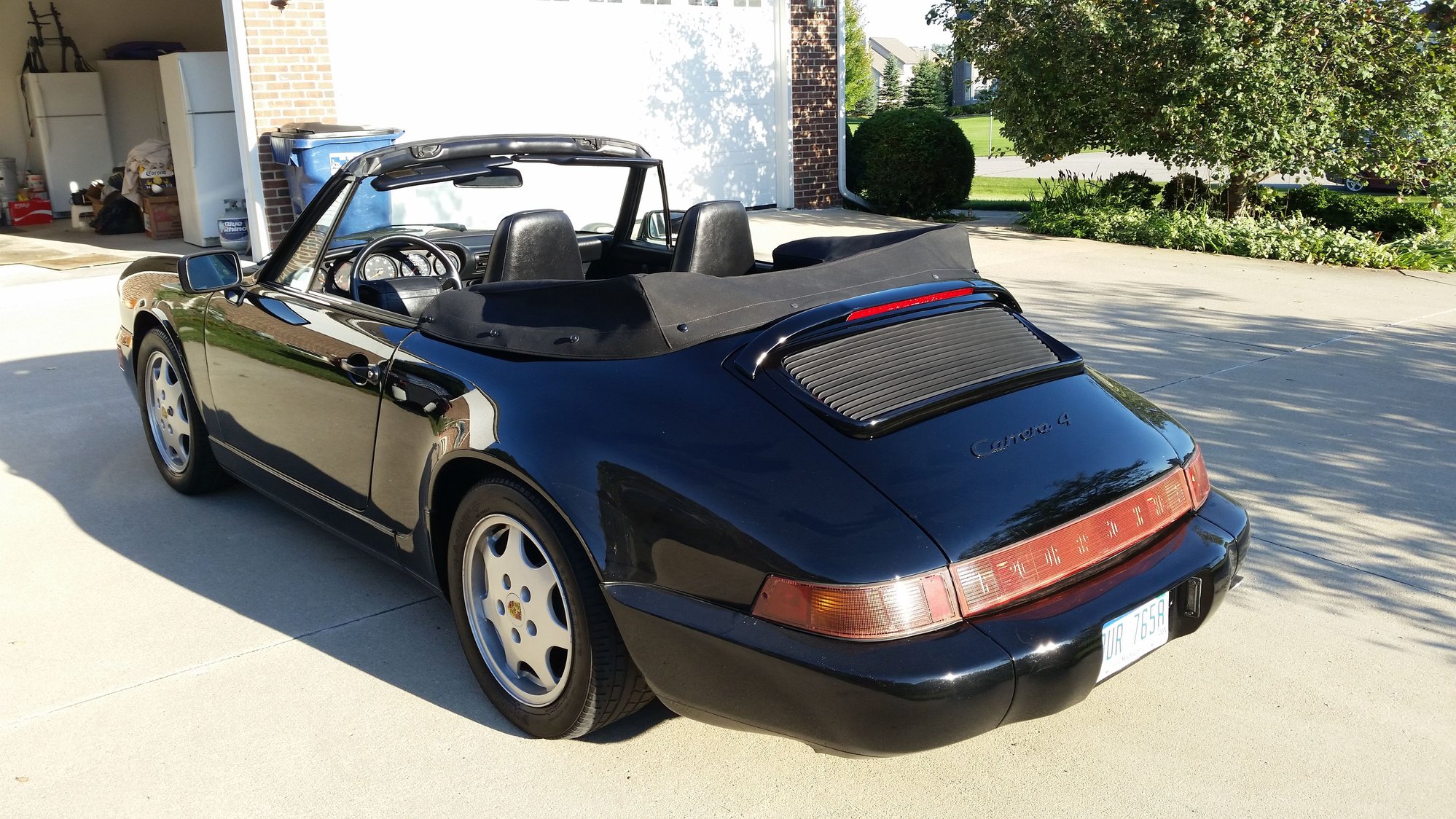

I just remembered that I had these on my phone.

Sweet. Looks like the third brake light has already been nicely modified if I'm not mistaken. Enjoy.

That third brake light looks sweet! Nice car.

Actually also check that the third brake light was properly wired. That looks like it came from a 993 but I can't say for sure from the picture.
