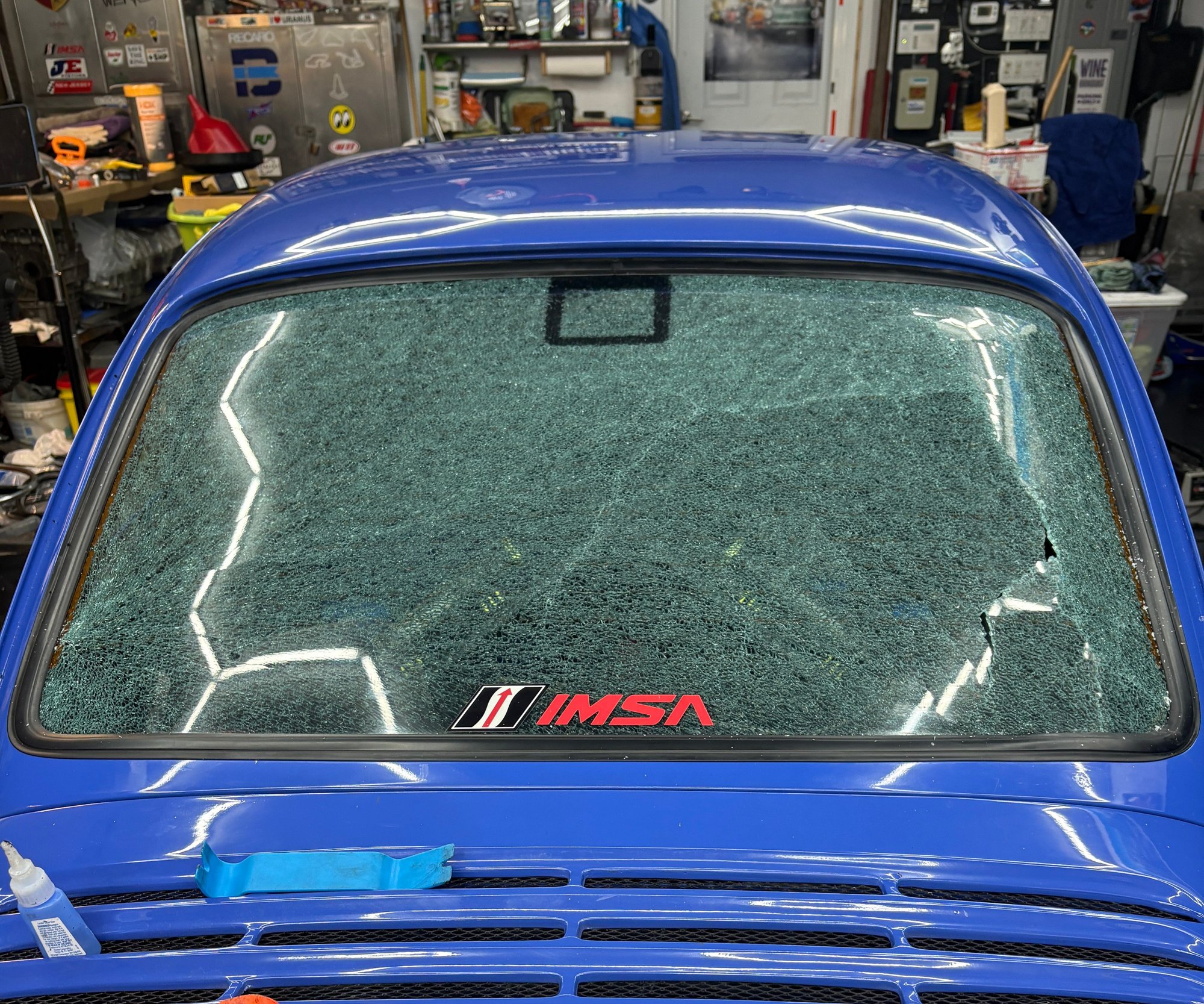

I could probably fill volumes with my mistakes I learned from over the years. It happens even to the pros. Just not sure I can remember them all. My latest was trying to use a factory rear window seal and because they come inches short I used black RTV to fill in the corners and push the seal outwards so it filled in the corners as it should. It worked until the added pressure created by the seal caused a very costly mistake and the window exploded under the pressure. It was fine looked great I left for an hour and came back to this.
Just exploded under the added pressure.

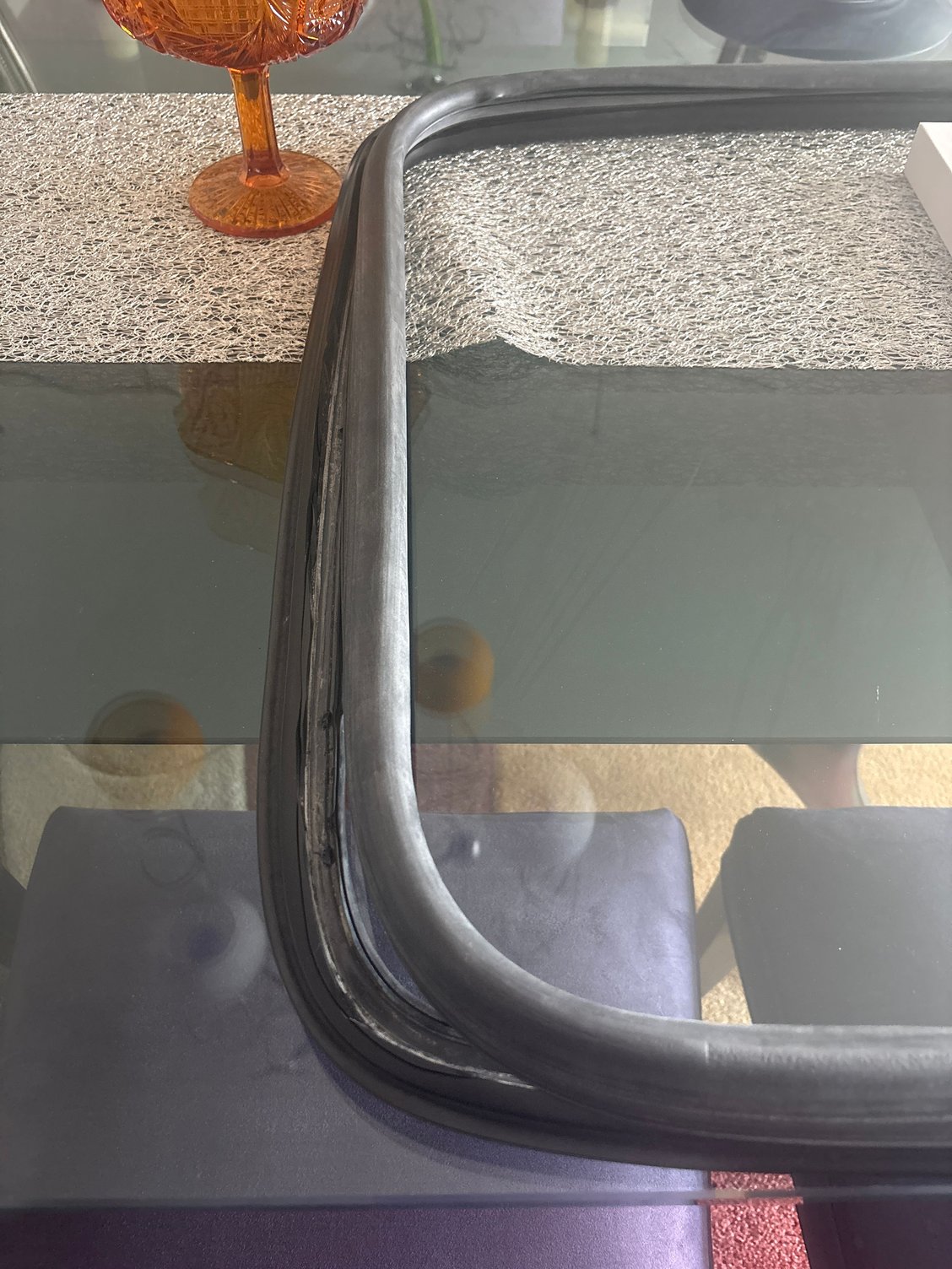

This is how short the new factory seals are.
This is how short the new factory seals are, both upper corners.
My next experiment is going to be using the same seal but as I pull in the upper part I will have to glue the seal to the car. Let it cure and hope. I was hoping to avoid this but I need to relieve the pressure the too small seal makes. It is an expensive gamble but I am running out of options. Porsche refuses to do anything about the short seals so a solution has to be there someplace.

If you can salvage the rear seal I highly recommend it. If you find a source for one that works please pass it along. Or we can buy a third seal and each chop a section and piece it in. But that would be so cheesy.
I find it hilarious that Porsche said my older seal stretched. If anything rubber shrinks.
