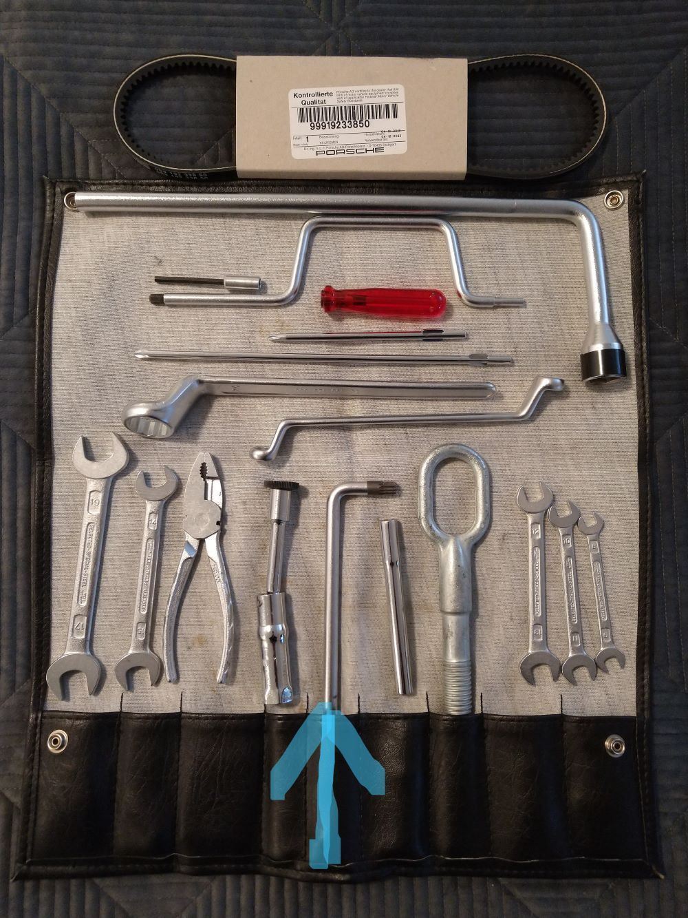

i think i need special spline tool to remove alternator belt?
it’s the remove/reinstall belt part that’s a little intimidating

The spline tool and its extension handle are in the original tool kit if you have it.
