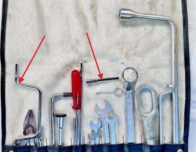

Check your toolset. The two with the red arrows should be in there and are exactly for this purpose
