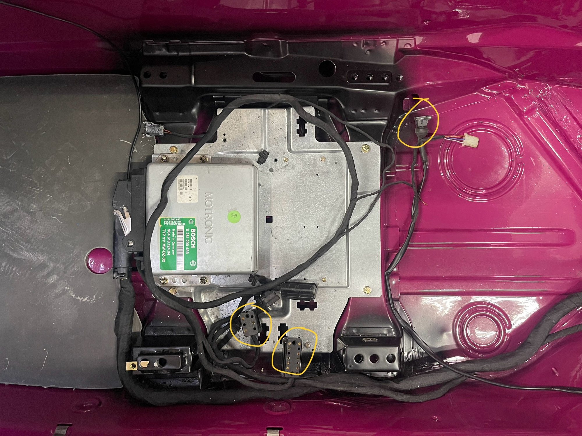

Busy restoring this RS back to original spec.
Might somebody have photo of the ECU area?
This was all gone,so i do not have a reference how the loom was placed etc

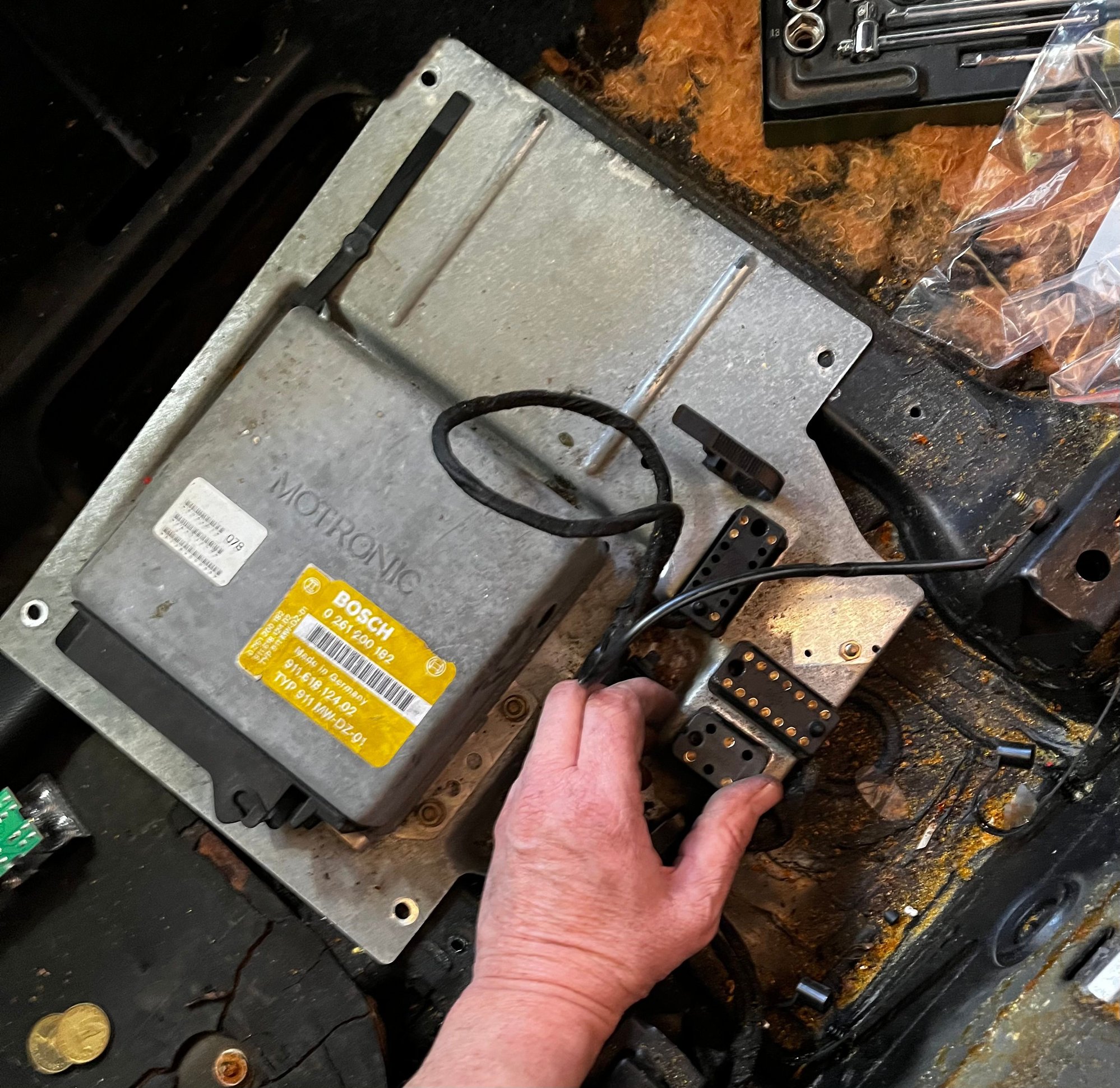

Will this help?
964 ecu plate
964 ecu plate

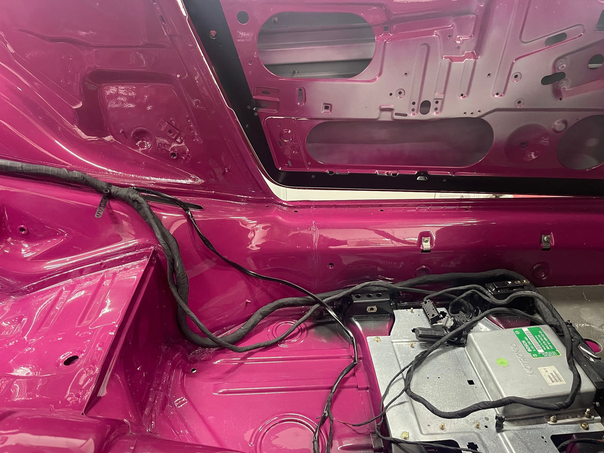

Looking especially for a photo of a RS setup ,the 3th photo shows the loom going to the ecu.
The lightweight carpet will be positioned over loom,and very visible trough behind the carpet
Would like to be sure i have the right routing before i glue everything down
