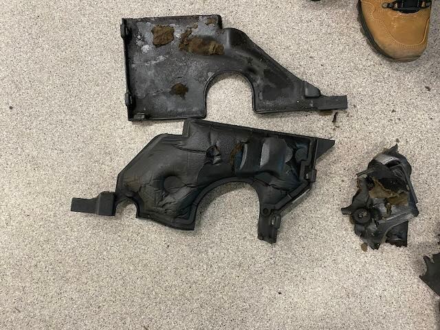

Hey all,
Does anyone know if you can buy the sound foam that fits the Capsule tin ware?
Mine has disintegrated totally and the new tinware is quite expensive.
Cheers
Alex

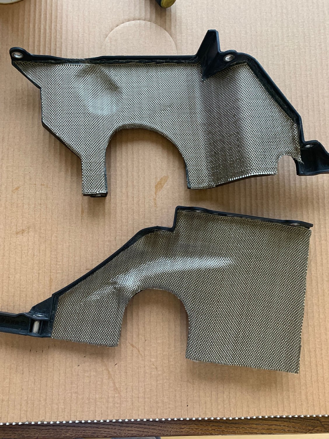

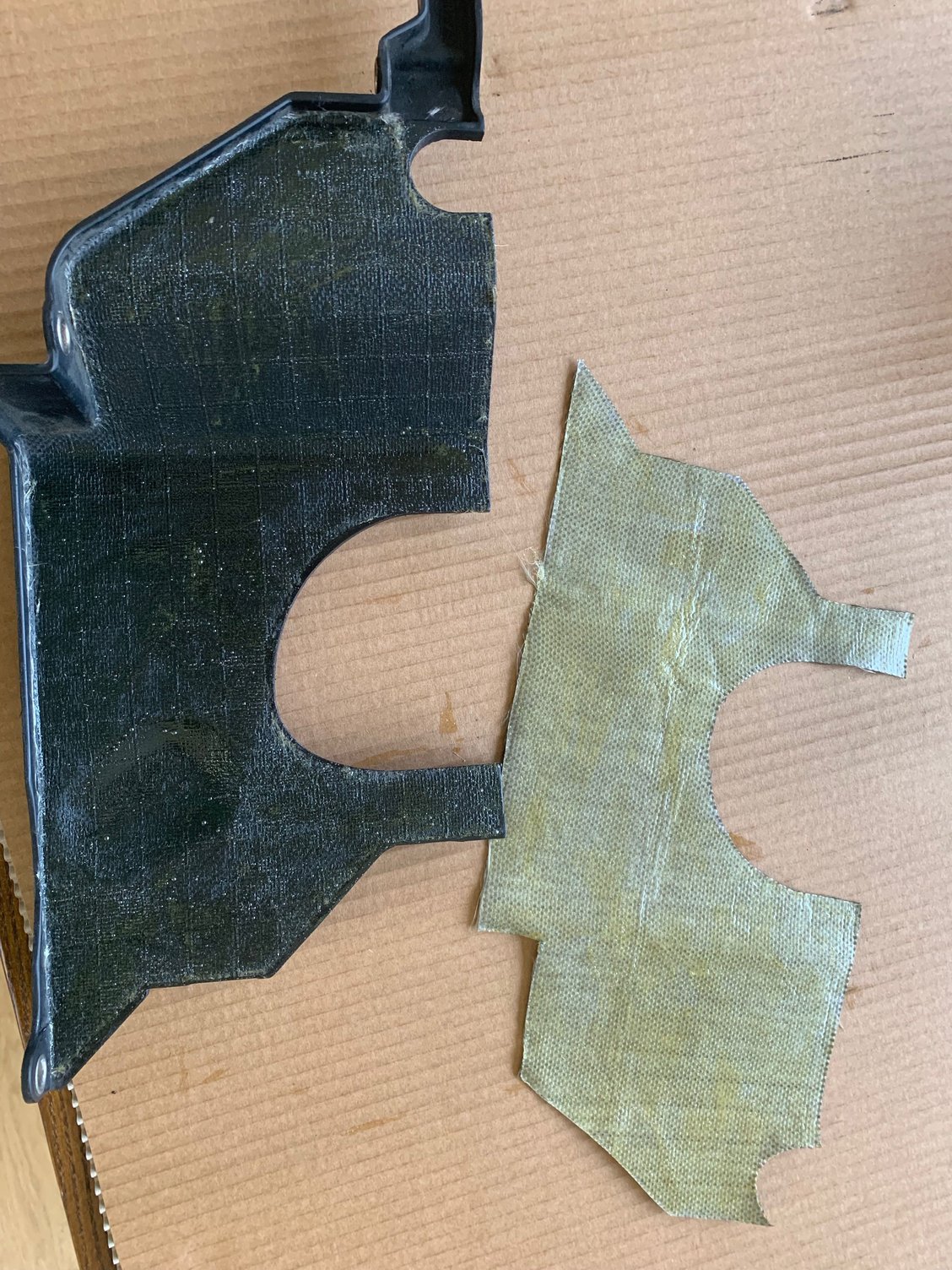

Hi, I don’t know whether you can buy the heat shield foam. I bought a roll of volcanic heat shield. Cut it to shape, and glued the sheet onto the shield with high temperature glue. Works great, and it is all still there after 4 years.
Hey,
Thanks for the pictures and gives me some ideas now. I think we have something similar here in some shops I can check out.
Big thanks for that
Alex

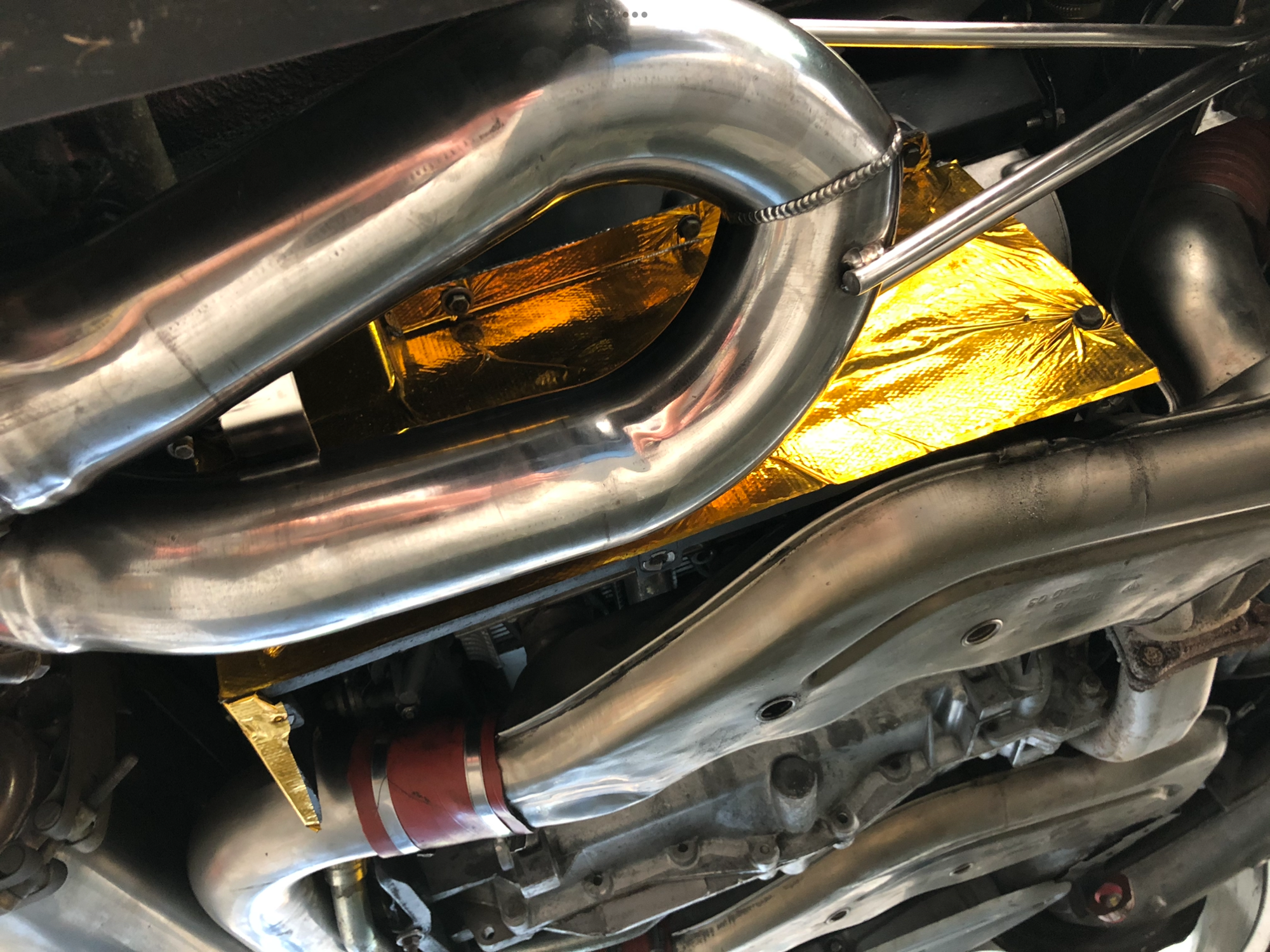

You could also use the gold heat reflective polymer tape, good for up to 800 F
My long neck pipe almost touches the heat shield so it made sense.
