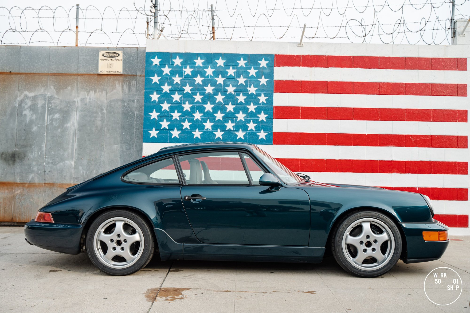

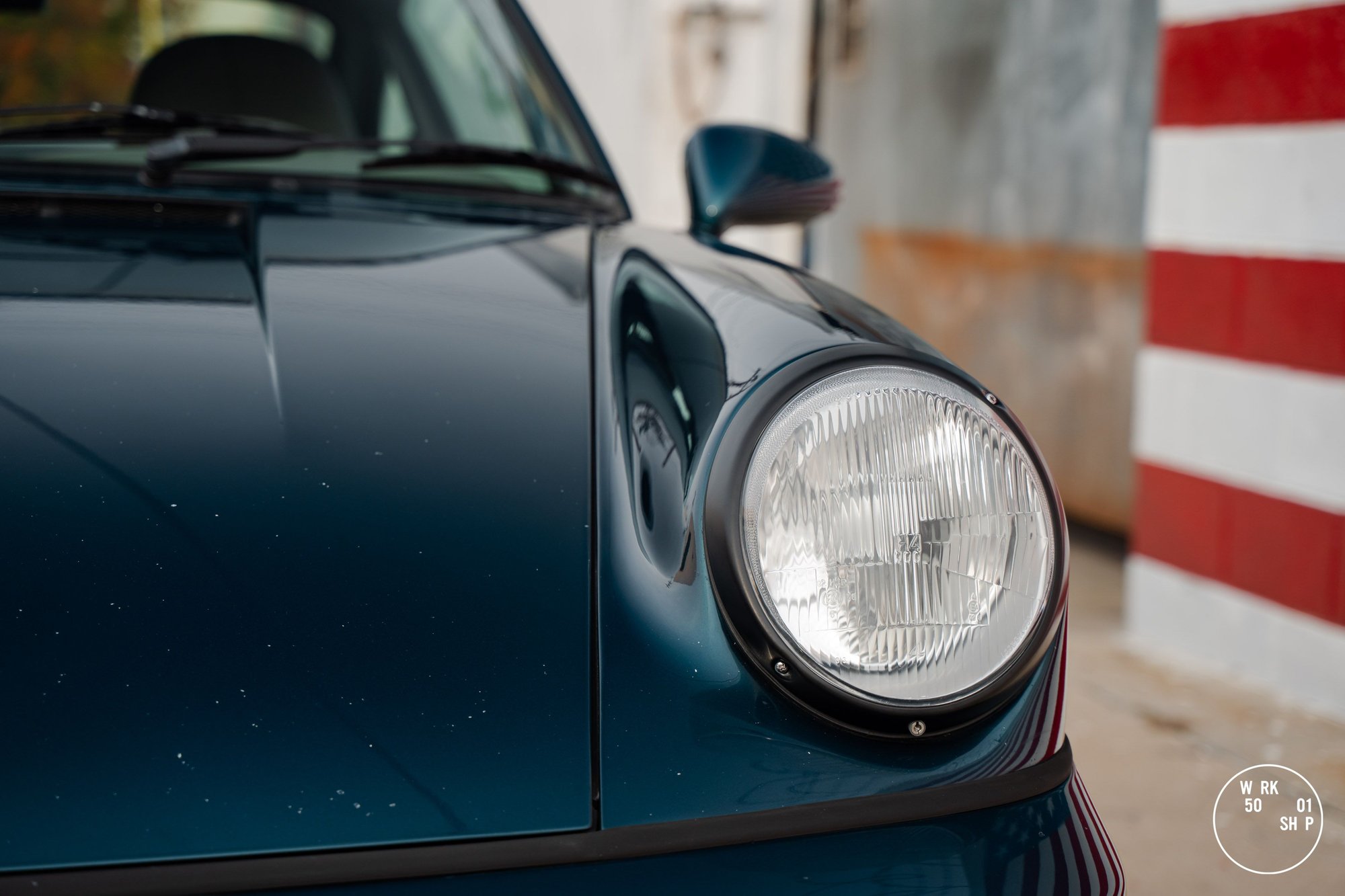

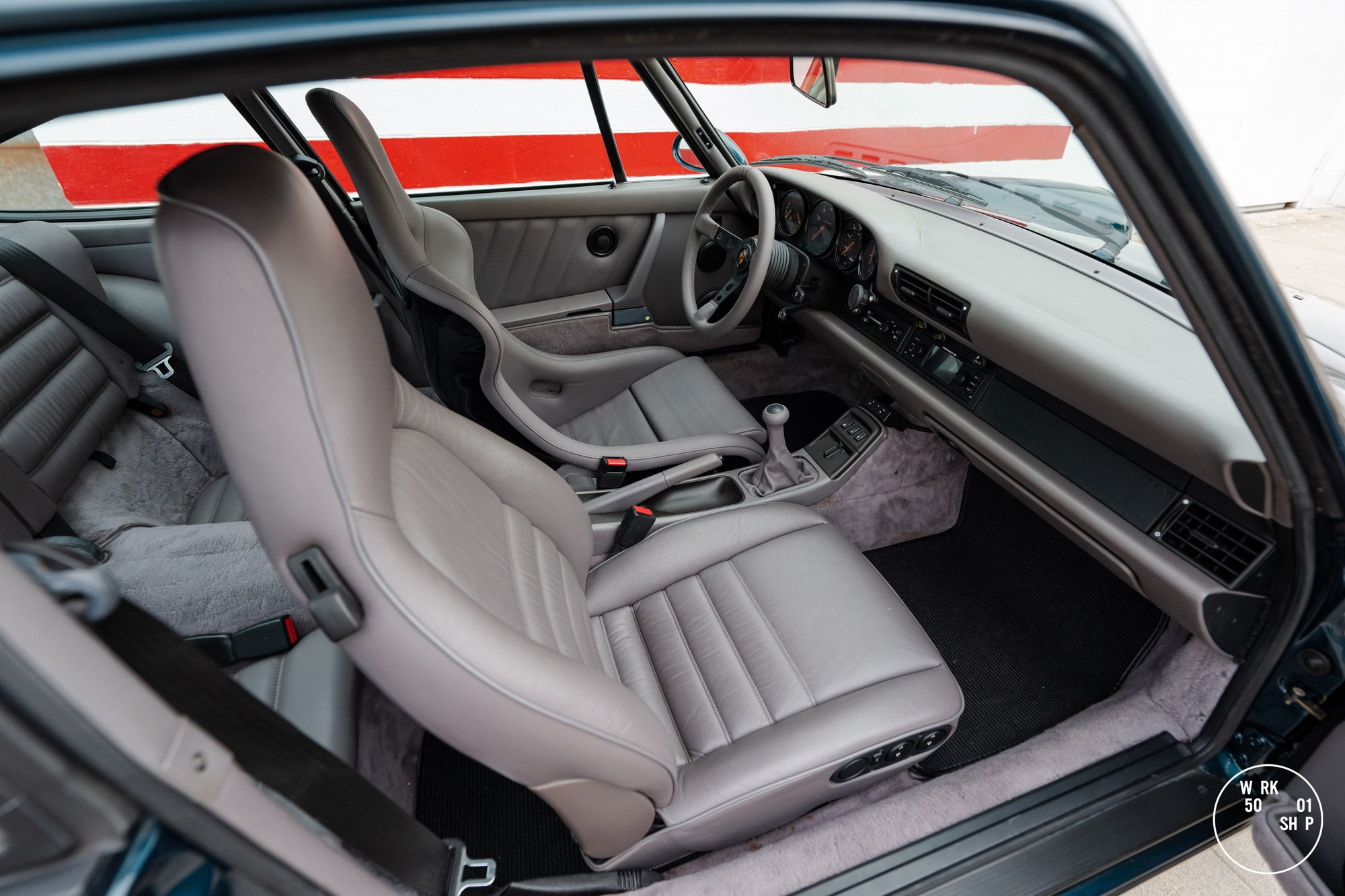

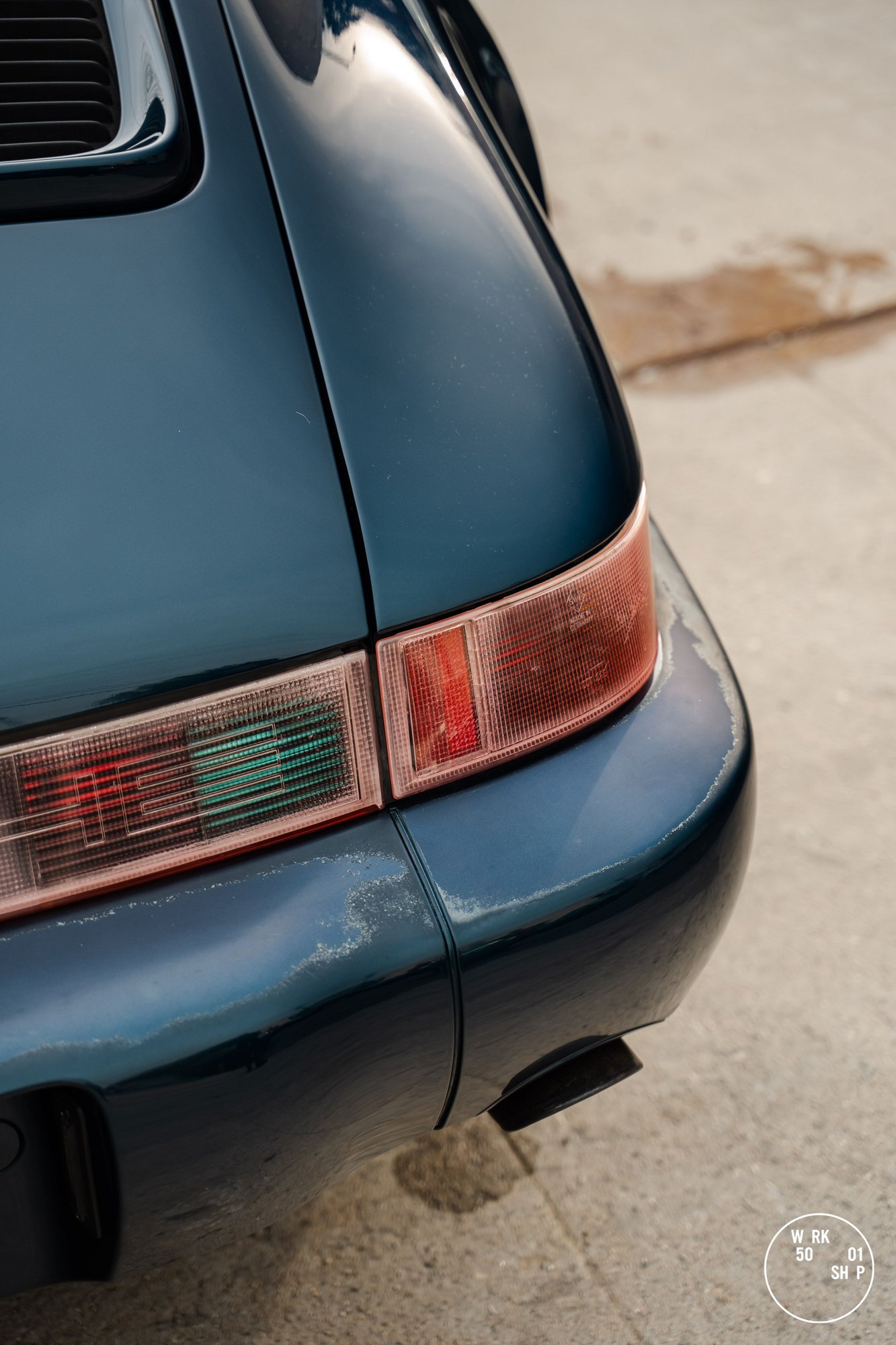

$30k is around what i was quoted in NY for a respray too. I decided to keep the paint original and rock the patina on my most recent build (deserves its own thread but thought i'd post a few anyway).
