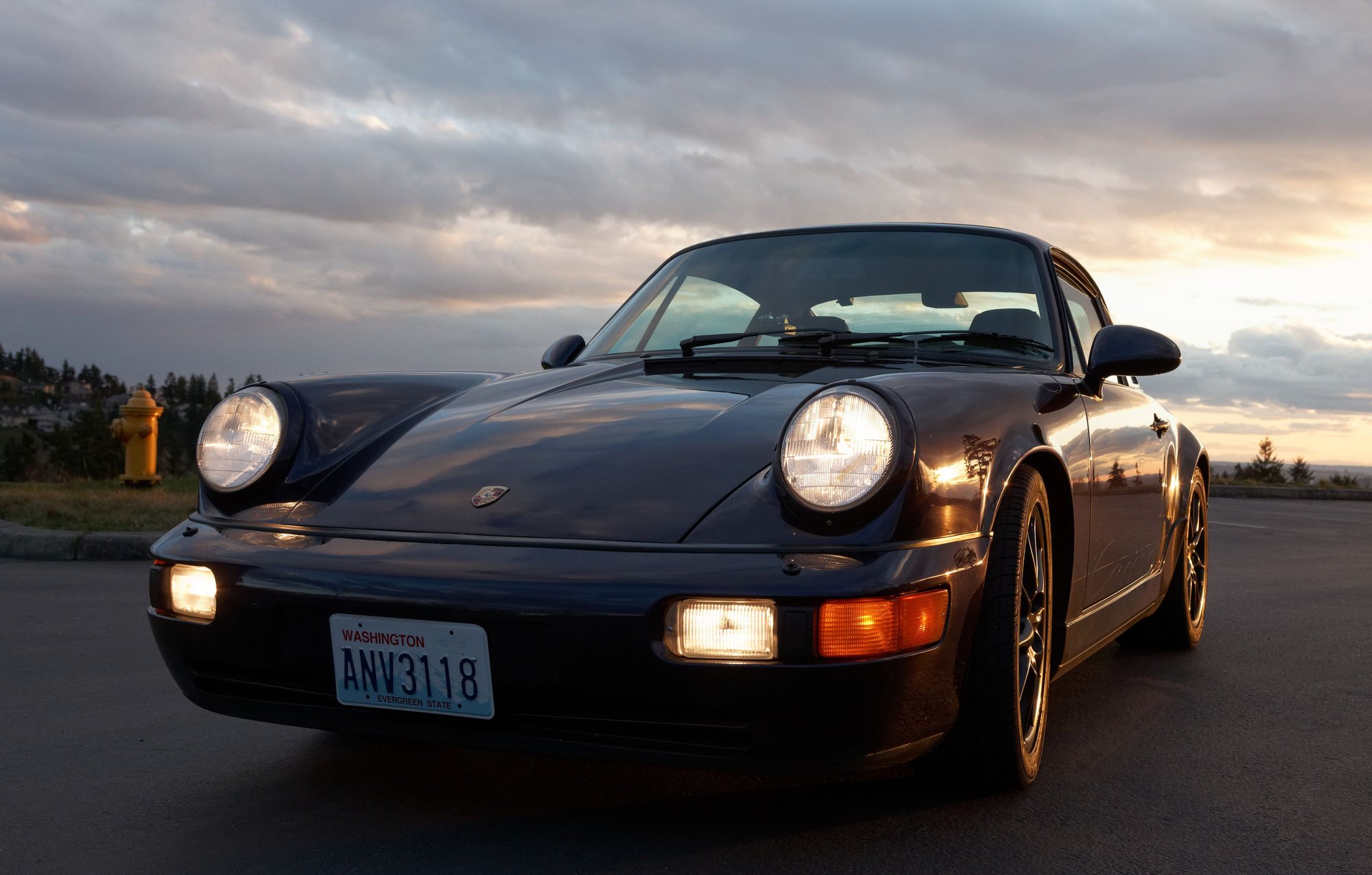

Photo for attention

Good looking car. Sorry for your troubles. You can pull the DME and jumper 30 and 87b to turn on the Pump. You should be able to hear it running. This thread may be of help. Pulling the pump isn’t terribly hard, but you’ll need to drain the fuel out of the tank.
