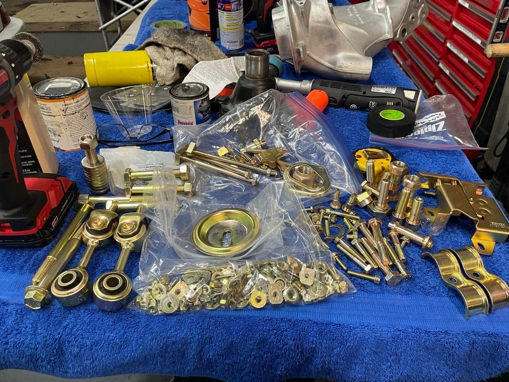

The factory parts were yellow cadmium plated not Zinc chromate. It will long outlast the zinc but hard to find anyone who does it anymore. Although the caswell product should restore your part for your needs. FYI that part is steel and not aluminum. They don't coat aluminum parts.
The factory parts no longer come yellow cad but clear zinc. I have a friend who does mil spec work and does mine in yellow cad. I have a set of parts coming back this week hopefully. Unfortunately the protective coating has been damaged it is a sacrificial barrier but if you don't drive in inclement weather should be fine.
Nothing like fresh refinished hardware. I agree if you want to preserve the finish do not use a wire brush or an impact gun as it will damage the coating.

I have used the Caswell system on all of my Alfa restorations. Their yellow zink is a perfect match for hardware on old Weber DCOE carbs and lasts well.
