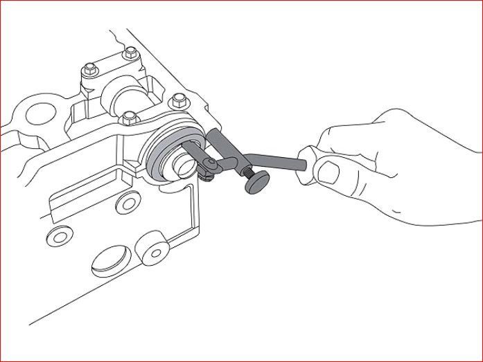

I wonder if this tool would work? Lisle 58430.
I never knew such a tool existed until just now.

In regards to the seal removal tool: I just googled it but the brand Lisle is well known and any auto supply shop should have them, or be able to order one. I bet you can find them on Amazon. Part number was in my other post.

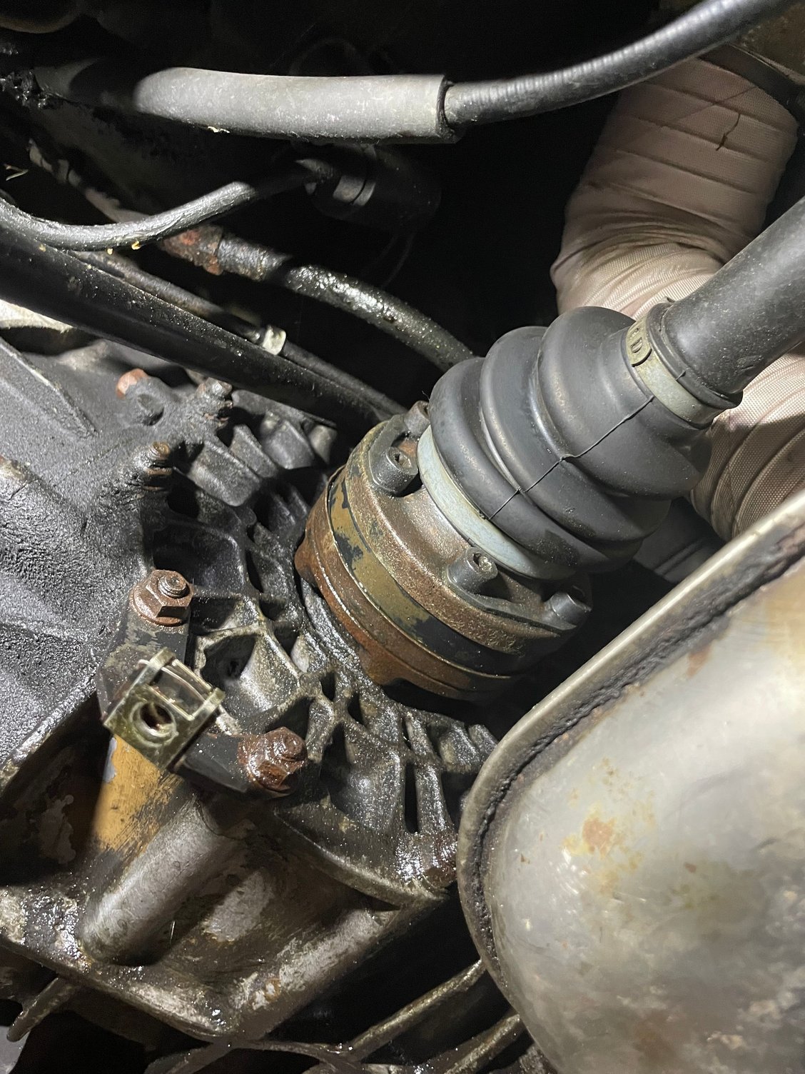

Unfortunately, I always discover something new when I'm looking at the car from underneath. Rear left side drive shaft is oily, so I'm going to replace the output flange seal and the o-ring behind the transmission cover. I hope that will be possible without taking out the whole drive shaft, would rather not like to loosen the wheel bearing nut.

I wouldn't replace that drive shaft seal. The new one won't be that much better. So if it needs to be perfect , then yes of course. But if not, at least wait until you have the axles out for another reason. Cv boots, wheel bearings, clutch, etc...not reason to do it now if fluid isn't pouring out.
....but if you want to....all good! You'll need a real seal pick to get that seal to release. And have a fully threaded m8 bolt to hold the flange when you re-torque the flange bolt.
You might want to de-burr the edges before reinstalling the seal as well.

Thank you for your reply. I already started it… and discovered that I can‘t take off the trans cover without removing the heat exchanger 😕
Tried by extracting some of the studs but that did not work. The O-ring behind the cover already came out in pieces, so no way back now…

Just to finish this up: to take off the trans cover, I loosened all bolts holding the left part of the heat exchanger: 4 at the cat, 4 at the junction to the right heat exchanger, 6 at the cylinders. I didn't take it completely off, but this gave enough room to pull the trans cover.
Exchanged the drive shaft seal and the o-ring and put everything back together.
