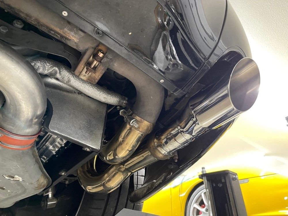

in case anyone wants a visual of the Scart pipe

I currently have a Cup pipe and have been looking at getting the Scart Swan Neck or doing the Rennline cat by-pass. Does anyone have input on what way to go?
Old Feb 18, 2022 | 08:46 PM
  #38
Tomfun's Avatar
Tomfun
Joined: Sep 2021
Posts: 301
Likes: 134
From: Vancouver, BC
I have a cup pipe + fabspeed cat bypass and like the volume. I think cup pipe + secondary bypass will be very loud....

I've been mulling going for a full bypass.
I love my cat bypass + primary muffler + seconday bypass (long neck bypass) - but recently heard a video of a guy out in Utah and his old 964 that had it completely bypassed and loved it. Love how yours sounds, though I figure it will sound different with a cat bypass as well.
Looking for a used cup pipe myself now.
Old Feb 21, 2022 | 11:48 AM
  #40
rsabeebe's Avatar
rsabeebe
Race Car
Joined: Nov 2008
Posts: 4,598
Likes: 1,044
From: Plano/DFW
Originally Posted by 964Lovac
I love my cat bypass + primary muffler + seconday bypass (long neck bypass)...
i started with a stock cat, primary muffler, and swan neck. the next step was the cat bypass, but i found it a bit bassy and muffled at the same time. i found it lacked the crisp sound i like - that bark, that snap. i knew a full bypass system was going to be too loud, so the next step was the cup pipe and return to the stock cat. last option was going to be a 200 cell, cup pipe, and swan. turns out, the stock cat actually gave me the sound i wanted. i almost always do 200 cells, but in this case it wasn't necessary.
for me, the cat bypass simply distorted the sound to something that lacked character with the primary in place. i have heard a cat bypass, cup pipe, and fister secondary and that sounded very nice. it's just a matter of swapping items out until you get the sound you like. retaining the stock cat was perfectly acceptable to me. this is the only car i run a stock cat on. 200s with someone's mufflers usually opens up the sound i want.
