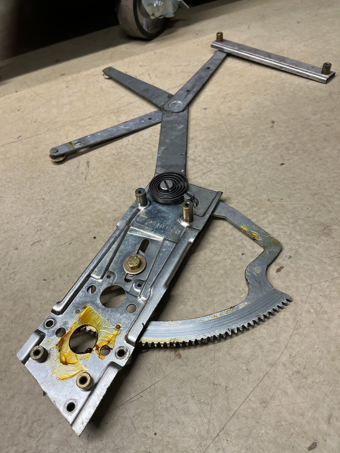

Today I removed the inop p/s window. No smoking gun!
All switches behave as they should
The motor bench tests perfectly in both directions
The motor runs in both directions when disconnected from the regulator
The regulator doesn't look worn and feels reasonably smooth
Only thing I am not sure about is the window in its tracks. The last photo shows the window mostly closed but entirely disconnected from the regulator, help by friction. Is that unusual / indicative of an issue?

Well, it works. The only things I did were to clean and lube all moving parts and to file down some high spots on the driven gear of the regulator.
I can not find any reference to this slotted screw which appears to offer some ability to adjust the angle of the guide on the regulator (not the window guides themselves).
Does anyone know what its intended to do?
