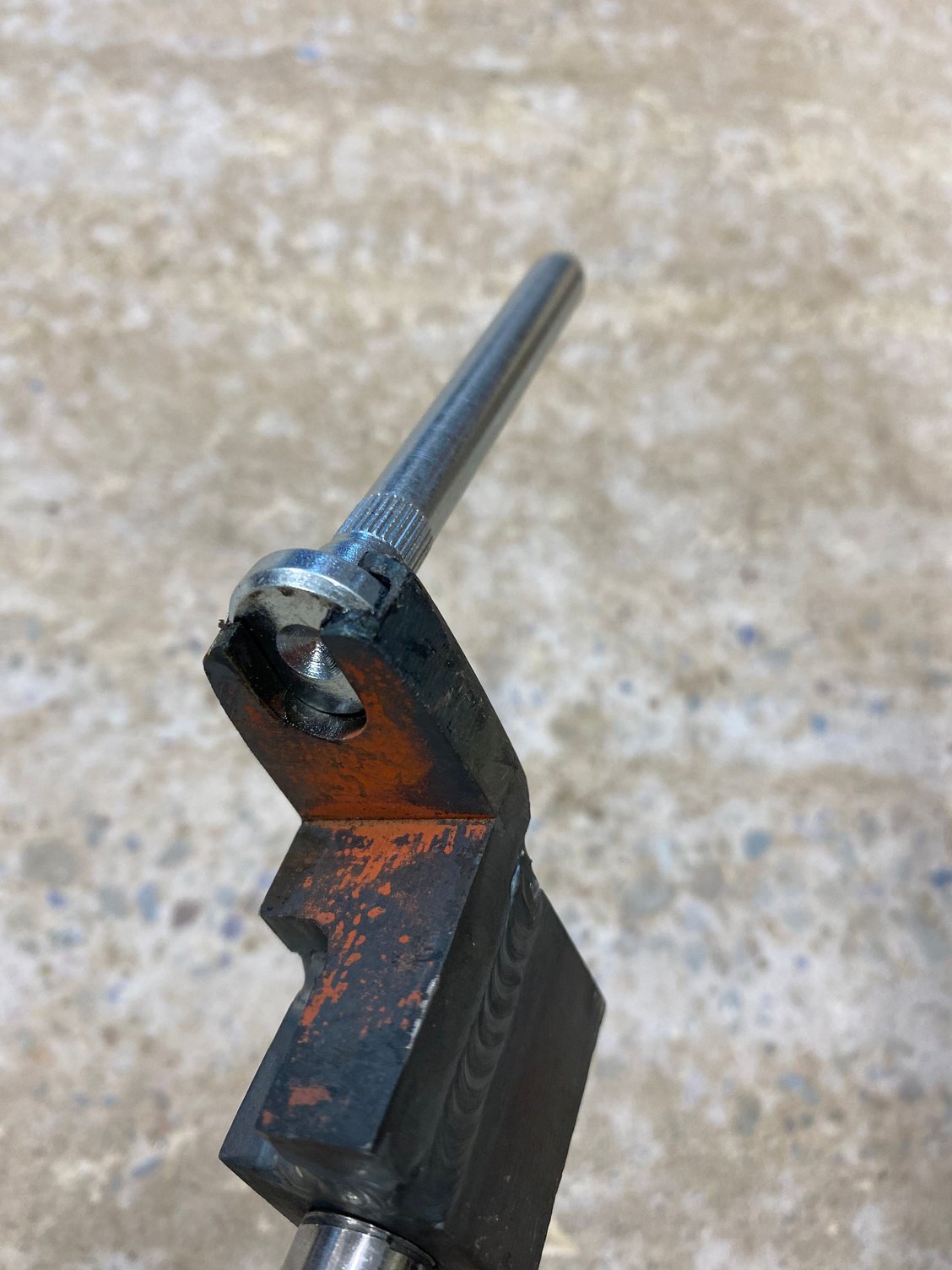

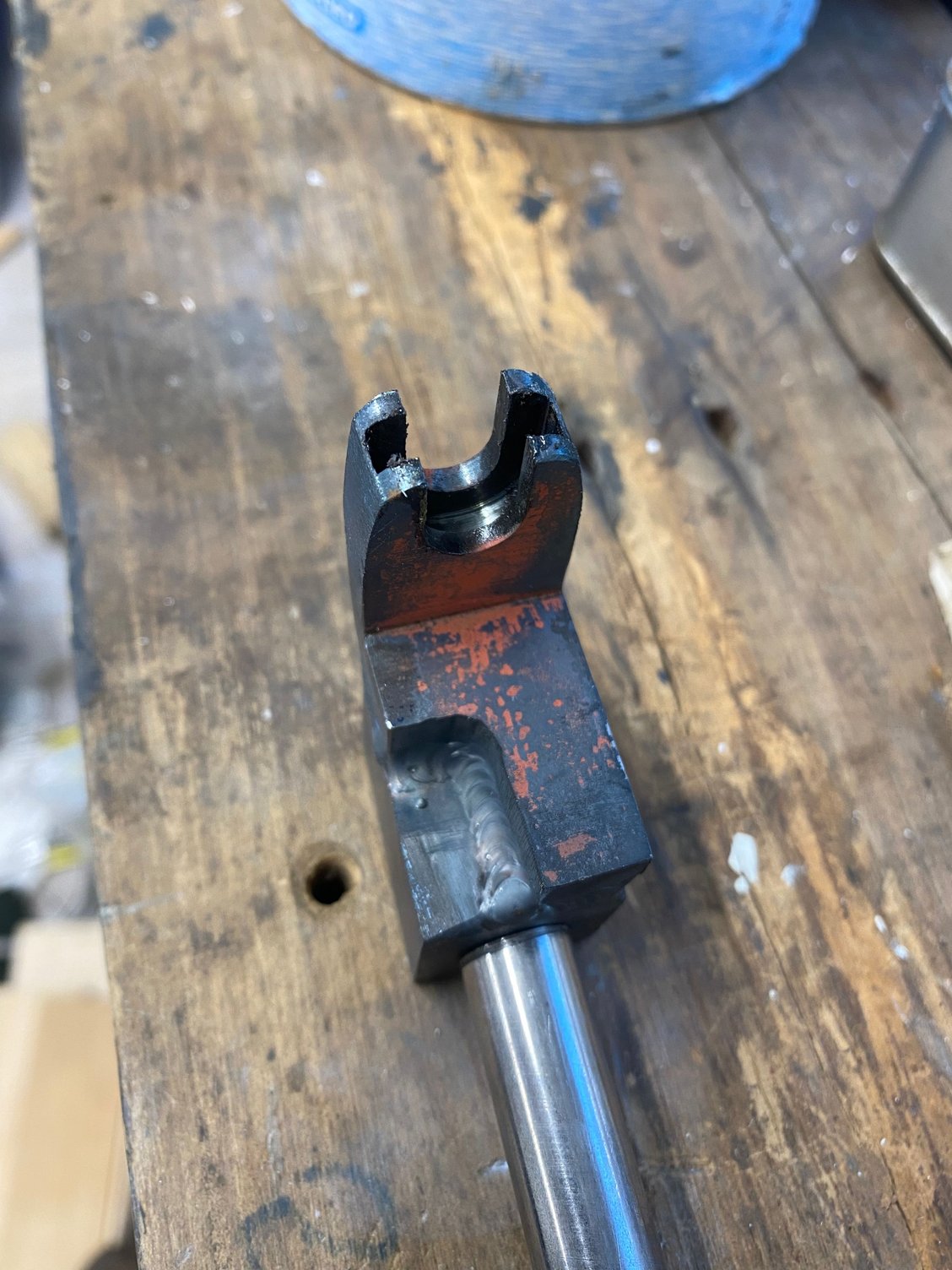

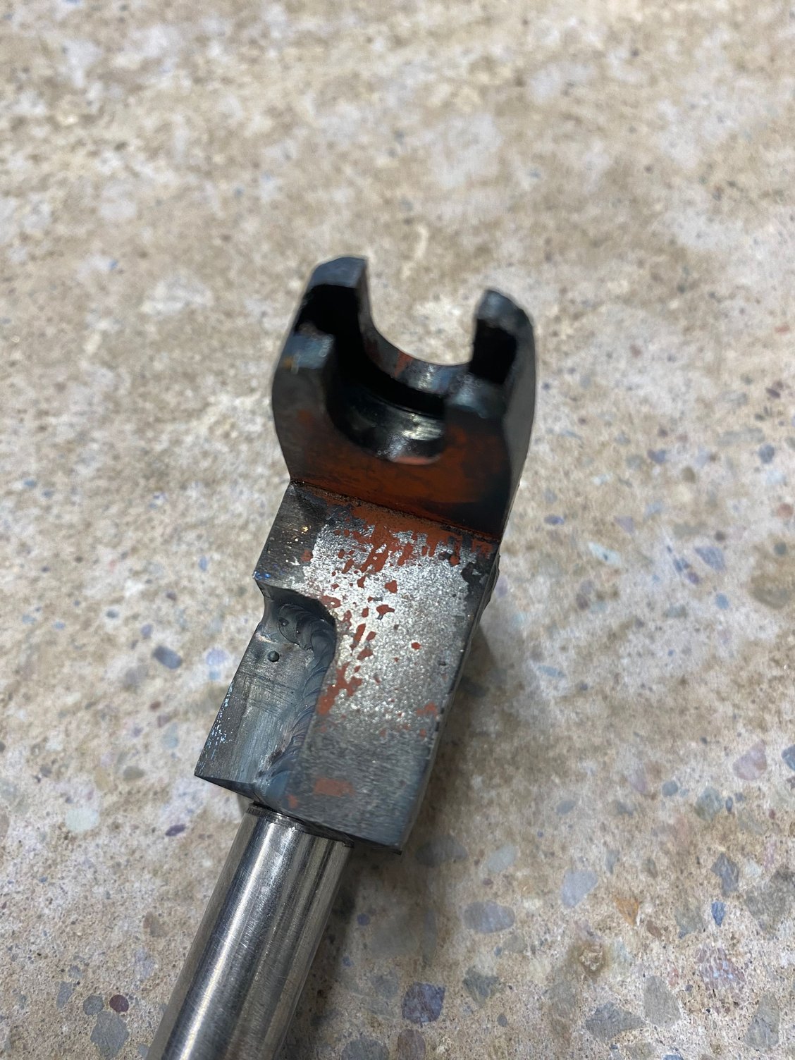

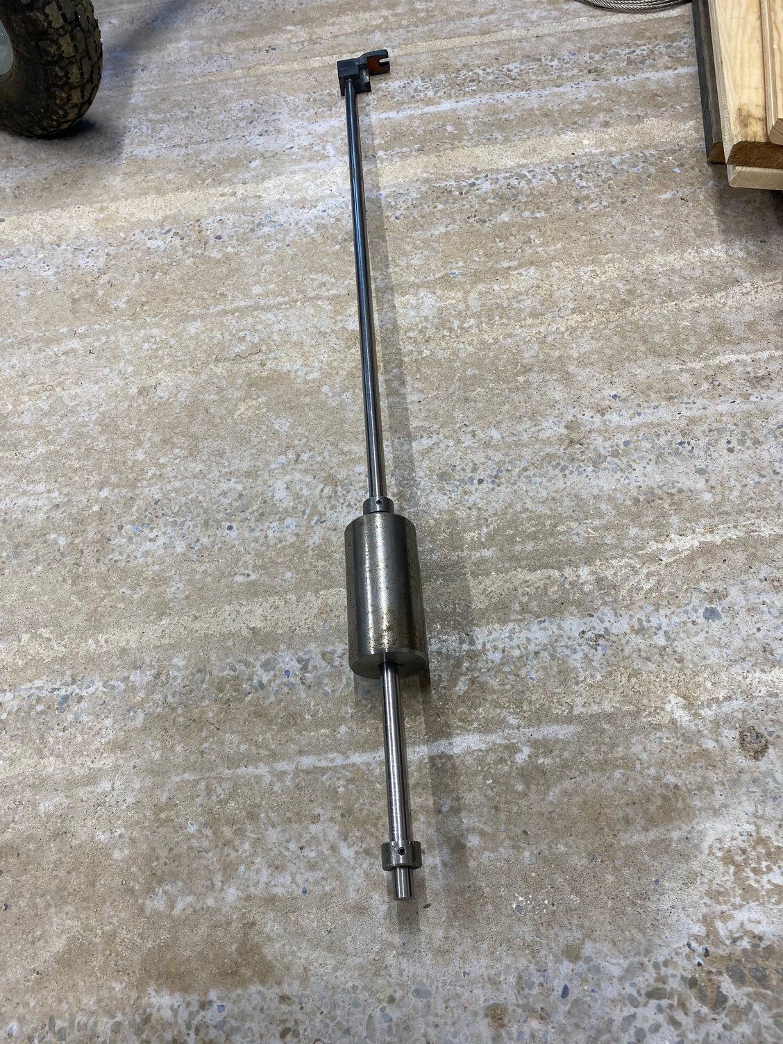

I thought this might be if interest. My drivers door drops very slightly so thought I’d replace the hinge pins and bushes, about £12.00.
Here are some pictures of the slide hammer and special forked end I made to withdraw the pins.
I wondered what other methods folk use to withdraw the pins as they are pretty tight.

We just use a punch and knock it out from the bottom it comes out quite easily once the knurled end is no longer holding it in place.
