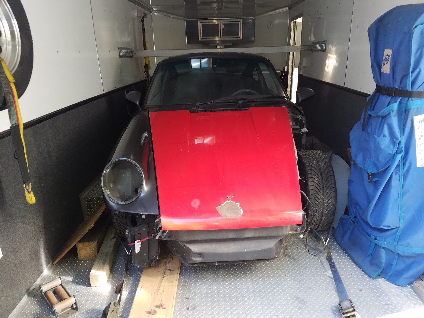

I purchased a 1992 C2 5 speed as a major project 5 years ago from another pelican Porsche fan who for whatever reason decided to bail on the project. It had 111,xxx on the OD, did not have a motor and a major backdate had been started I put it in the back of the garage for a few years while I completed a couple other Porsche projects and a diversion with 3 early TVR’s.

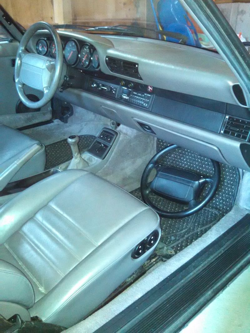

Those of you sharp eyed original audio nuts will notice in the interior shot above the radio/ tape player is a blaupunkt stutgart. Contradicting some of the information I have seen on line, this was a factory option as identified in the paperwork that came with the car. Unfortunately, not unique to others, the tape deck does not function. I don’t have any cars with tape decks any more and I was looking forward to blowing the dust off the cassettes and listening to some of those classic tapes. I suppose its past time to throw them away.
