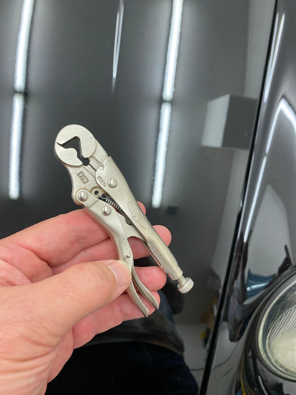

These little vise grips have a jaw that works well on brake lines
IRWIN Tools VISE-GRIP Original Locking Wrench with Wire Cutter (item #8)
Amazon Amazon

Thanks, I had not seen these. I ordered them. If all else fails, I may have to use these two as a last resort...
