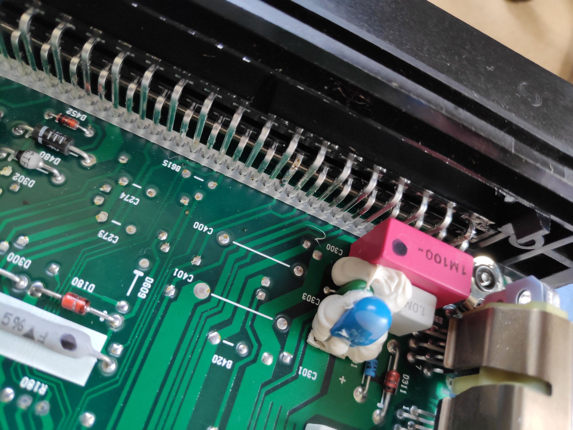

Hi John !
Thank you for your reply and ideas. About the chip, I'm not sure. I opened the DME, I attach some pictures of the inside. The cut and then soldered item is visible.
This car is from Japan, is it a different motronic and chip than in Europe ?
Thanks a lot !

  #44
Lorenfb's Avatar
Lorenfb
Race Car
Joined: May 2003
Posts: 4,220
Likes: 102
From: SoCal
Originally Posted by anteuzer
Hi John !
Thanks a lot !
Alexis
The Motronic is the same for all 964s, the chip is an original Porsche/Bosch, but maybe for a different region, e.g. Japan. The cut component is not used in later 964 Motronics.
